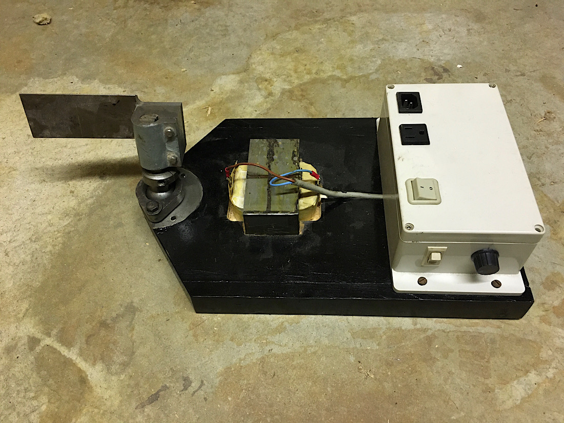

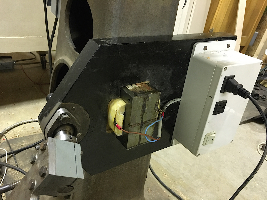

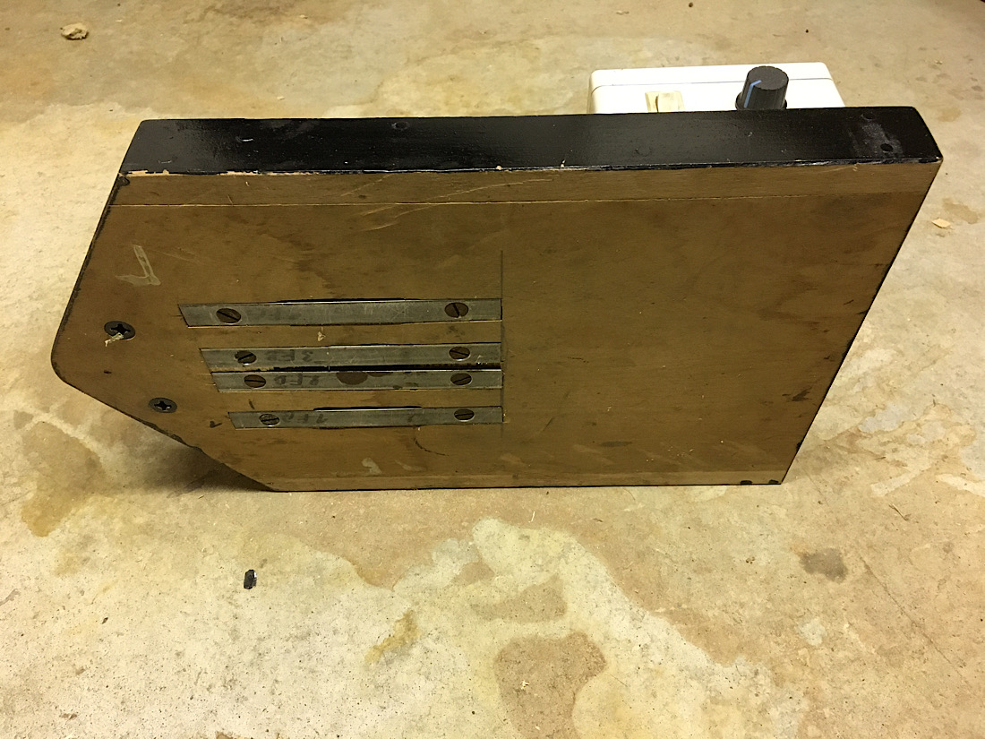

    I made a new base for the drill. It’s just plywood and works more or less the same as the old one but is easier to use and can be placed in more unusual ways.
    The enclosure houses a cheap ac motor speed controller and a dc power supply for the magnet, each with an independent switch. The electromagnet is from a microwave oven transformer.
