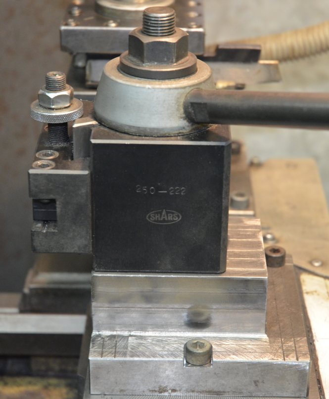

    A compound is necessary for doing short large angle tapers, and for feeding the tool in at an appropriate angle for screw cutting. Apart from that the compound is a source of extra flex and slop.
    For years I have run with a solid alternative only installing the compound when I needed to do the above. Now with my electronic control I do not need it to do those tasks so I shall have no future need to fit it to the lathe.
    Slotter or broach driver.-toolpost-mount-01.jpg Click for full size.
    Here is my tool post block, very rigid and there is a reduced chance of chatter.
