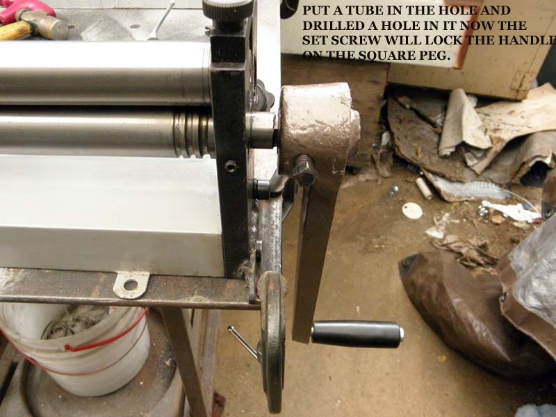

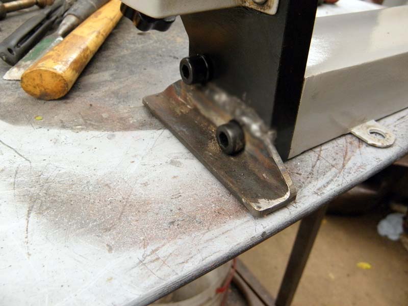

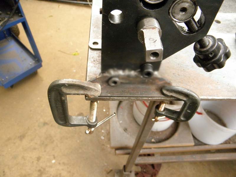

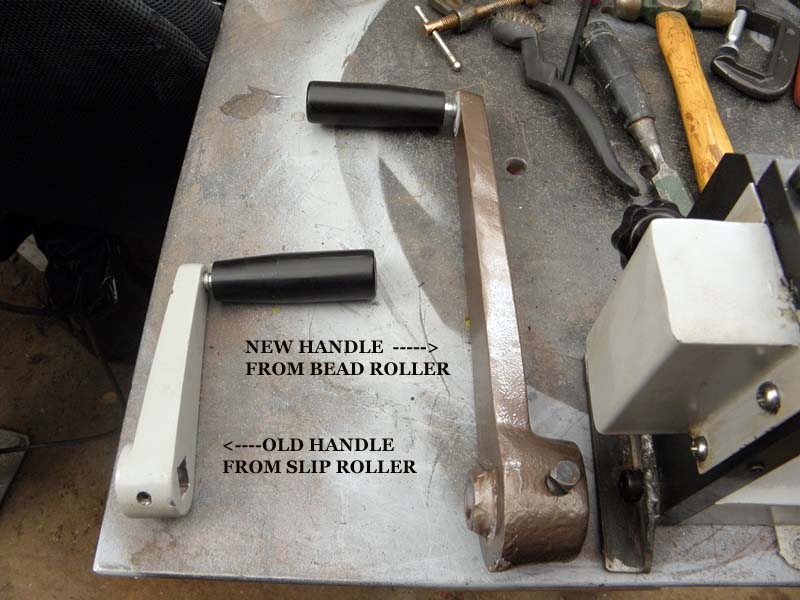

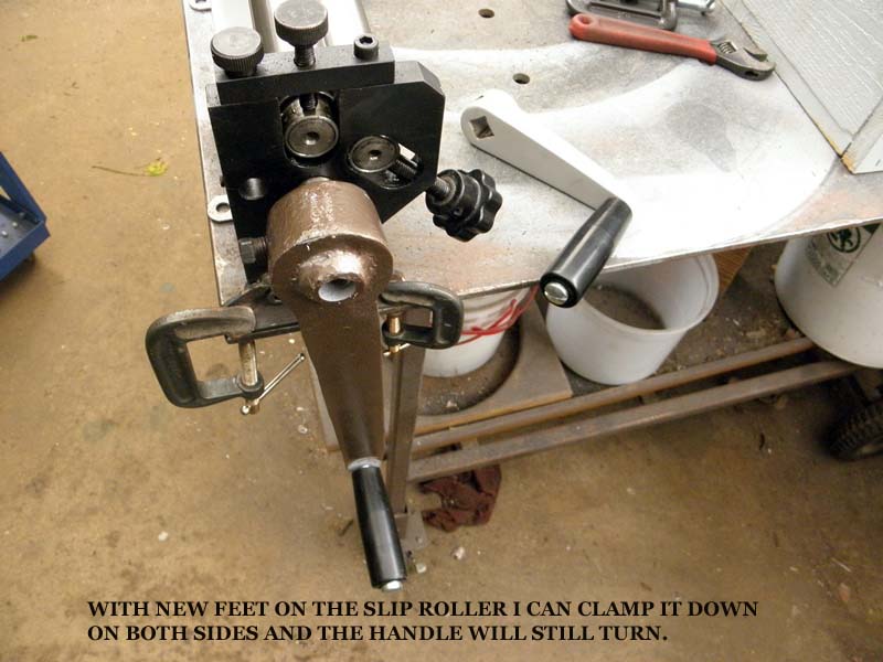

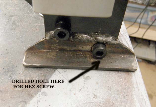

    Slip Roller Modification. Added new feet made form 3/4 inch x 4 inch angle iron on both sides to allow the c clamps to hold the roller on my welding bench and allow the handle to turn missing the clamps.
