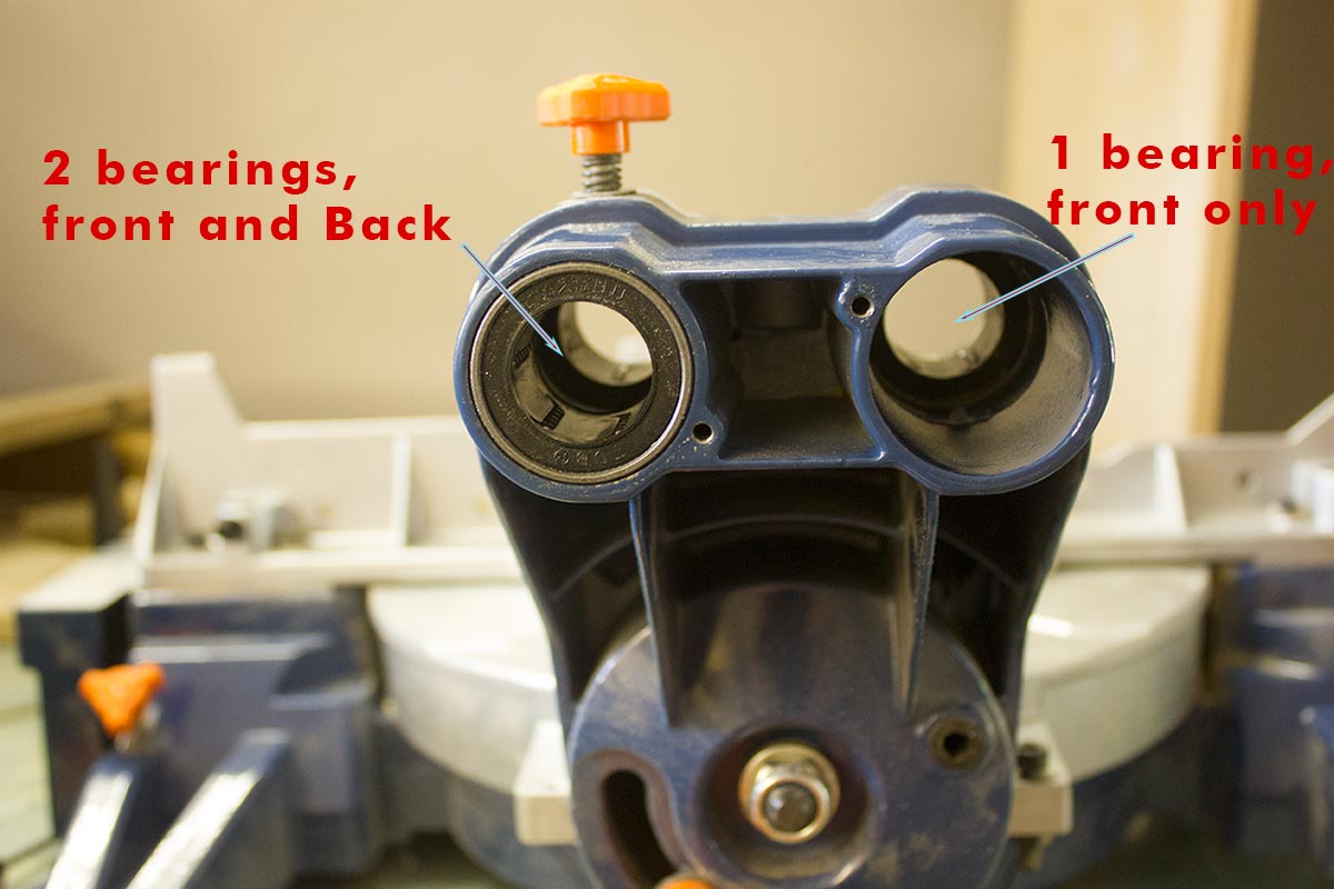

    An odd question. I've got this cheapo miter saw that I bought to use and I could never get a straight cut at the 0 degrees (or 90 deg) mark.
    Over a distance of 300mm (ie 12") I would get a deviation of approximately 2.5 - 3 mm (around 1/8 "). I mean, I don't expect it to be a professional unit but I do expect it to at least cut in a straight line.

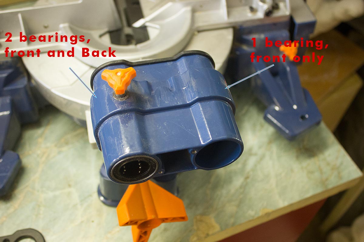

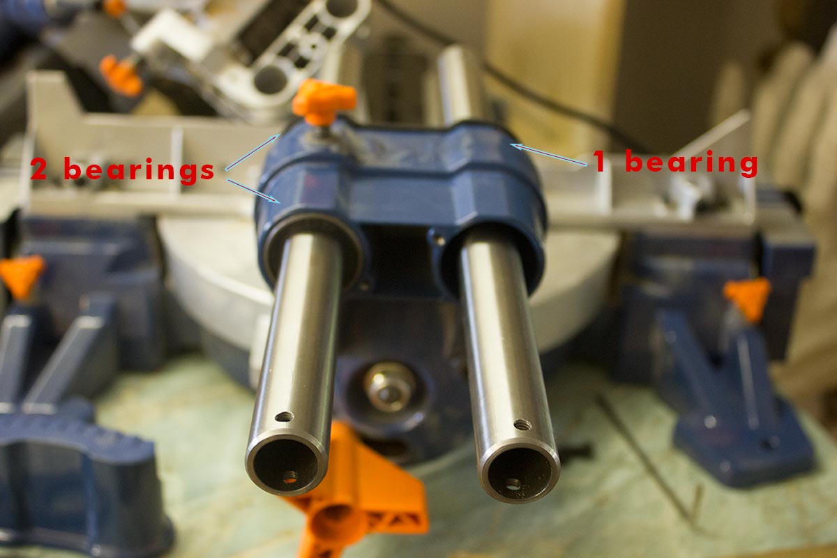

    After a bunch of adjustments to try to cut down the inaccuracy, I decided to remove the sliding head and vacuum everything. Including inside the linear bearings.
    What surprised me was that there seemed to be a linear bearing missing. I mean, one of the rails has 2 bearings installed, the other rail only one.
    Does this seem normal on these saws? Is this a case of trying to save a few cents / unit? Or is it a gross QA oversight?
    Could this be the reason that the ends of my cut are not straight?
    I've attached some pictures for reference.

    I'd be surprised in a normal set of twin rails that 3 bearings would be fitted; if it was in the middle, that might triangulate the parallel attempt, but sketchy. I'd recommend finding a replacement 4th set and install it, long as the bores are same in all 4 corners. If you or a friend have a bit of machining equipment, make a tiebar for the outboard end with same center to center as the slide bars.
    There is an import chinesium miter saw here, basically similar to your photos. It definitely has 4 bearings and a flimsy little tie bar. Your pic #1 shows two tapped [?] adjacent holes. Those certainly are retainers; either a spring or a spacer separates the front from rear bearing. They save a few cents not producing a counterbore four times.

    Thanks everyone. I picked up a lm25uu bearing to try. However, as Toolmaker51 mentioned, they did not bore the back end to size, it is approx 1mm under size.
    And the other lm25uuu bearings installed are half-length. It would have made sense if they had used the 3 bearings triangulated, but they did not.
    Thanks Elizabeth for your offer, I'm going to try to get the LM25UU in, since I've already got a replacement.
