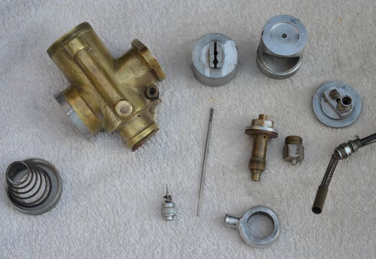

    What was the base metal used for those chromed slides? During the 1960s I used a very old Amal which had a brass slide chromed. Never had any de-lamination.
    Sleeving Vintage Amal carburator-amal_tt_01.jpg Click for full size image.
    Slide is centred on top row.
    I have a couple of original Mk2s, they had anodised slides from new, not replacements. I think that the removable pilot jets came in with the Mk2s, there were two locations, front and back. The front was the normal 4 stroke position with the rear for 2 strokes and 4 strokes with steep down draft. The rear was further divided into left and right positions.
