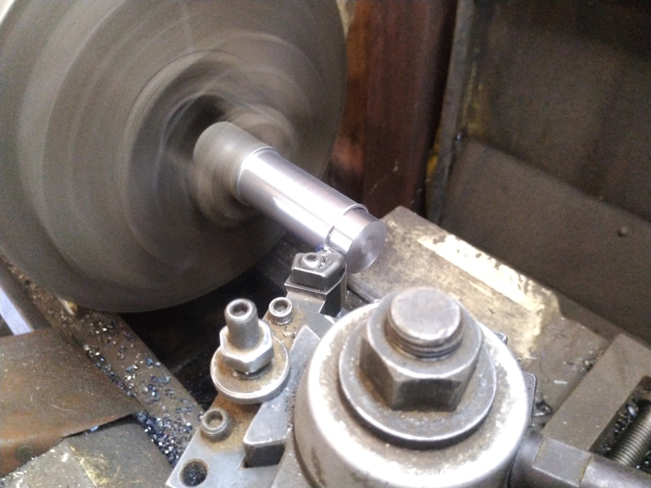

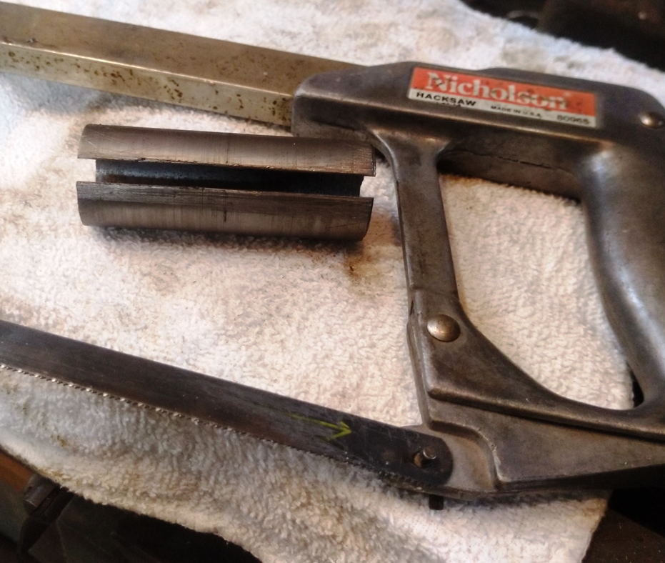

    So I just had to make a 3inch long split sleeve bushing.
    First I turned it down and bored it out then I split it for the shaft key
    No picture of boring and reaming something happened to the picks I took

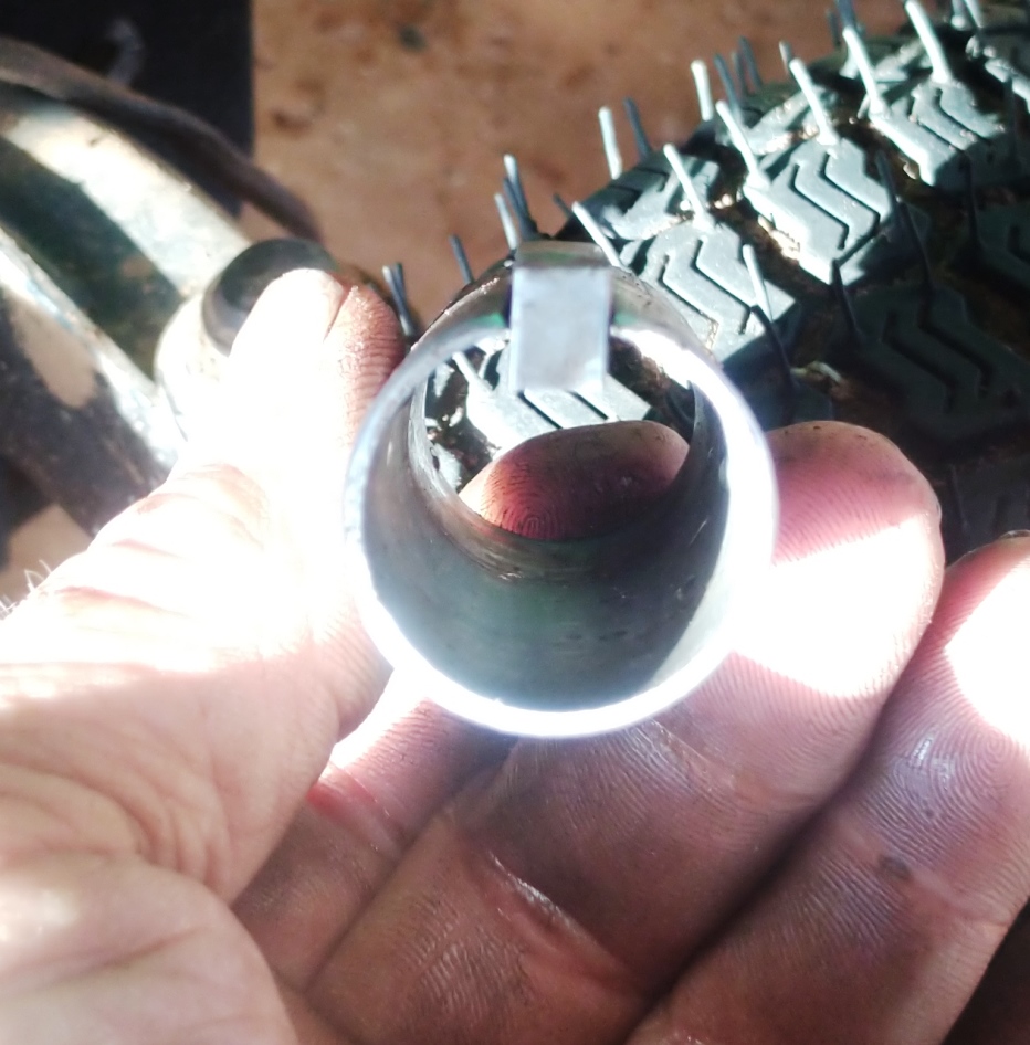

    But it went like this, I purposefully turned it .005 under size then made the bore a few thou. undersize as well, taking into account for the tangent or thickness of the sleeve. From past experiences this should cause the sleeve to fit tighter on the shaft and remain there should the clutch need replacing later on. I will also have to make a shaft key of 1/4 by 5/16" high to correspond with the thickness of the sleeve

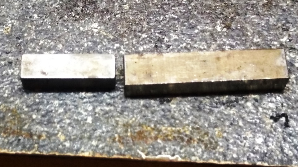

    Obviously having a sleeve on a shaft means any attachments driven by the crankshaft are going to require a special shaft key.
    I made one by cutting a strip off of a piece so 1/4" thick cold rolled steel and grinding it to size on my belt sander

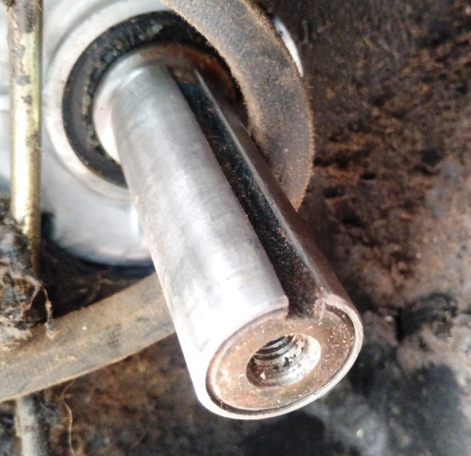

    The sleeve pushed over the shaft

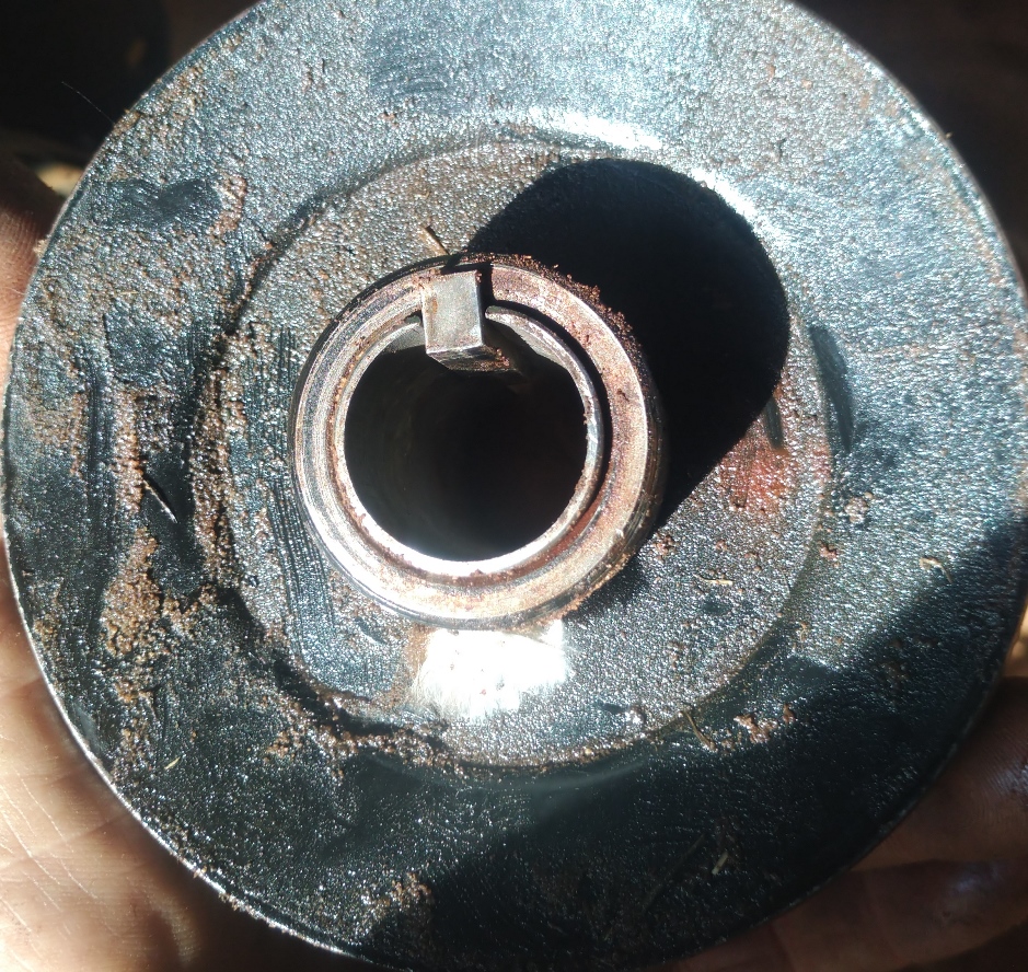

    The sleeve and shaft key in the pulley

    The key in the sleeve
