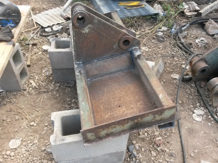

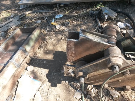

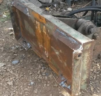

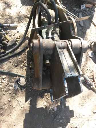

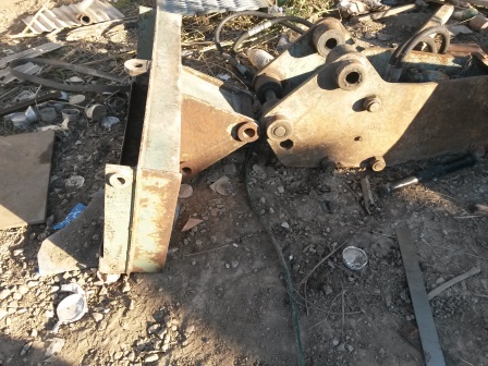

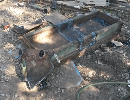

    When you have a skid steer that needs a hammer you must also have a mounting frame that fits the hammer and the skid steer machine
    One of my oldest customers had a problem he had a small 1000 lb hammer that he couldn't use because it fits one of his machines that is currently not operational He also had a mount for a different hammer that would not fit the hammer of the skid steer. So I cut up the mount to make a new one for him
    skid steer adapter mount for 1000 lb hammer-20161016_174611c.jpg skid steer adapter mount for 1000 lb hammer-20161017_125350c.jpg skid steer adapter mount for 1000 lb hammer-20161017_151823c.jpg skid steer adapter mount for 1000 lb hammer-20161017_151834c.jpg skid steer adapter mount for 1000 lb hammer-20161018_123823c.jpg
    The mount is finished except for the final fitting of 2 parts for the skid steer but I need the machine to do that

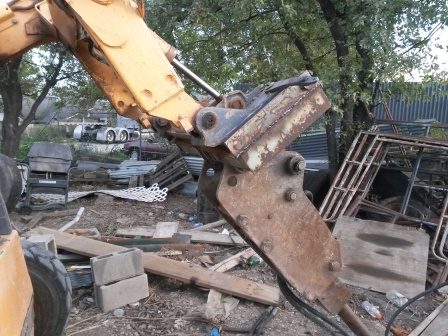

    I finally got the skid steer back today. This gave the the opportunity to make the final mounting pieces for the hammer mount.
    skid steer adapter mount for 1000 lb hammer-20161029_174826c.jpg skid steer adapter mount for 1000 lb hammer-20161030_134848c.jpg

    OK I'm about to attempt to break a promise I made to one of my daughters I told her that if she didn't try to weld I leave movie productions to her After watching my own video I think I should do just that
    Everyone tried to tell me and El that not mount a 1000 lb hydraulic hammer on a skidsteer of this size
    Well they were wrong
