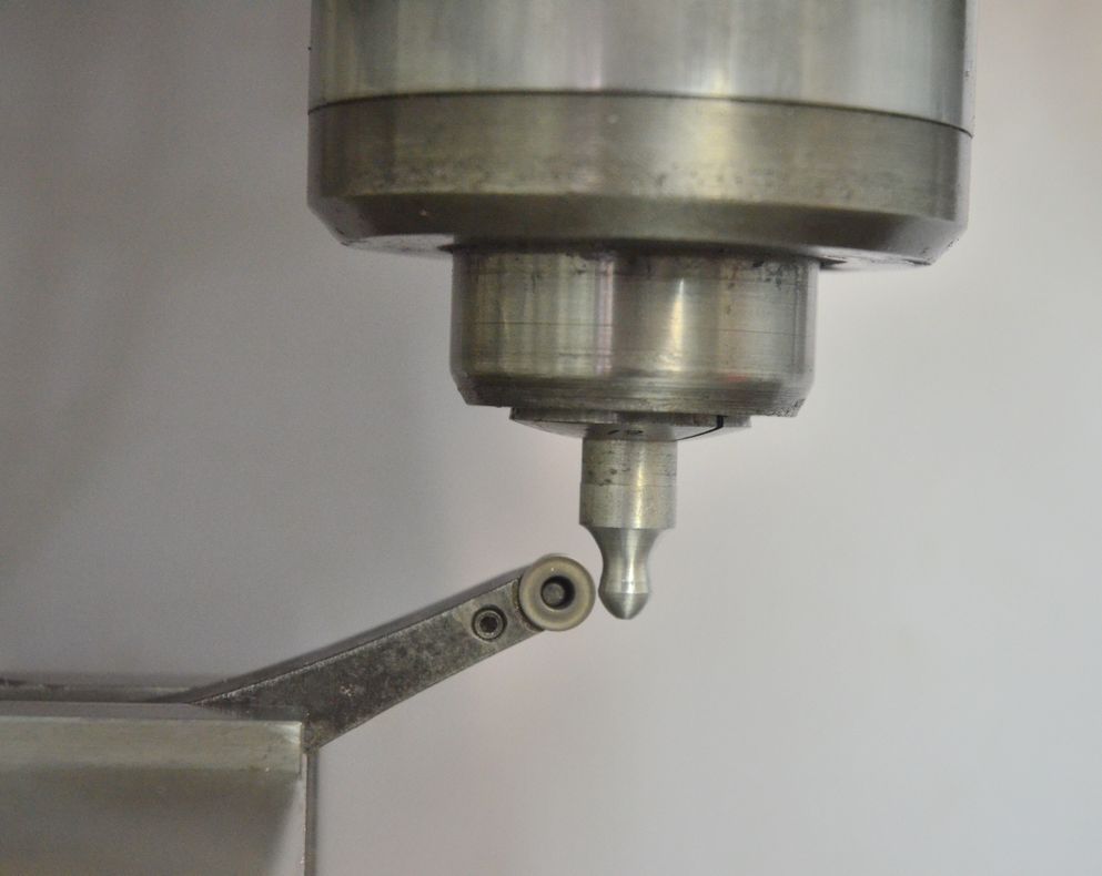

    The ball turner axis, when extrapolated, must intersect the rotation axis of the part. Is that wording more to your liking?
    ha, ha. I can't fault that statement. Whether the wording is more to my liking is immaterial because I understand the geometry. i was just concerned that the previous may not have been clear to all.

    Here is how I would do it in a mill. Virtually zero setup, just add some G-code and away you go. click on pic. for full size.
