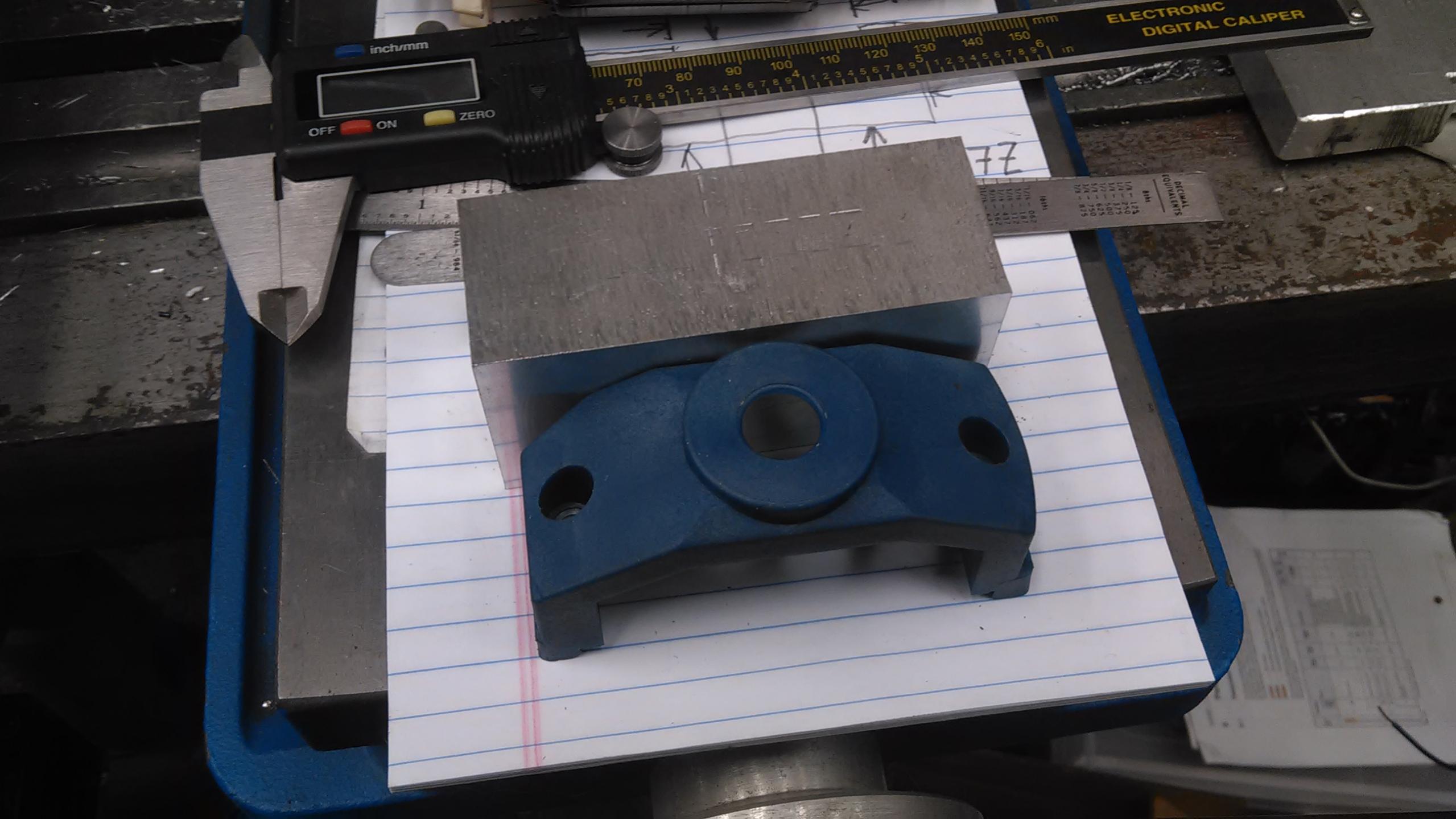

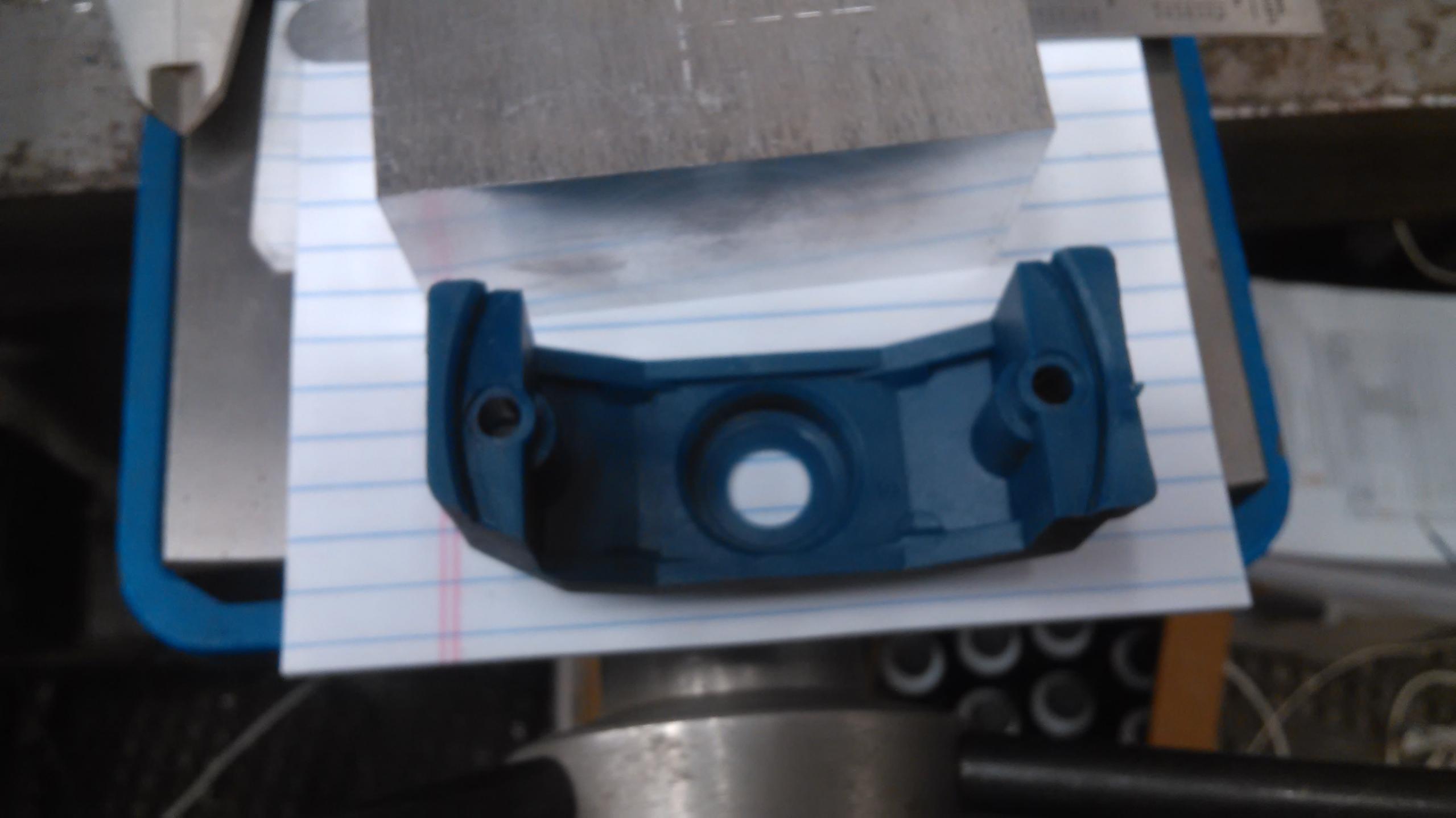

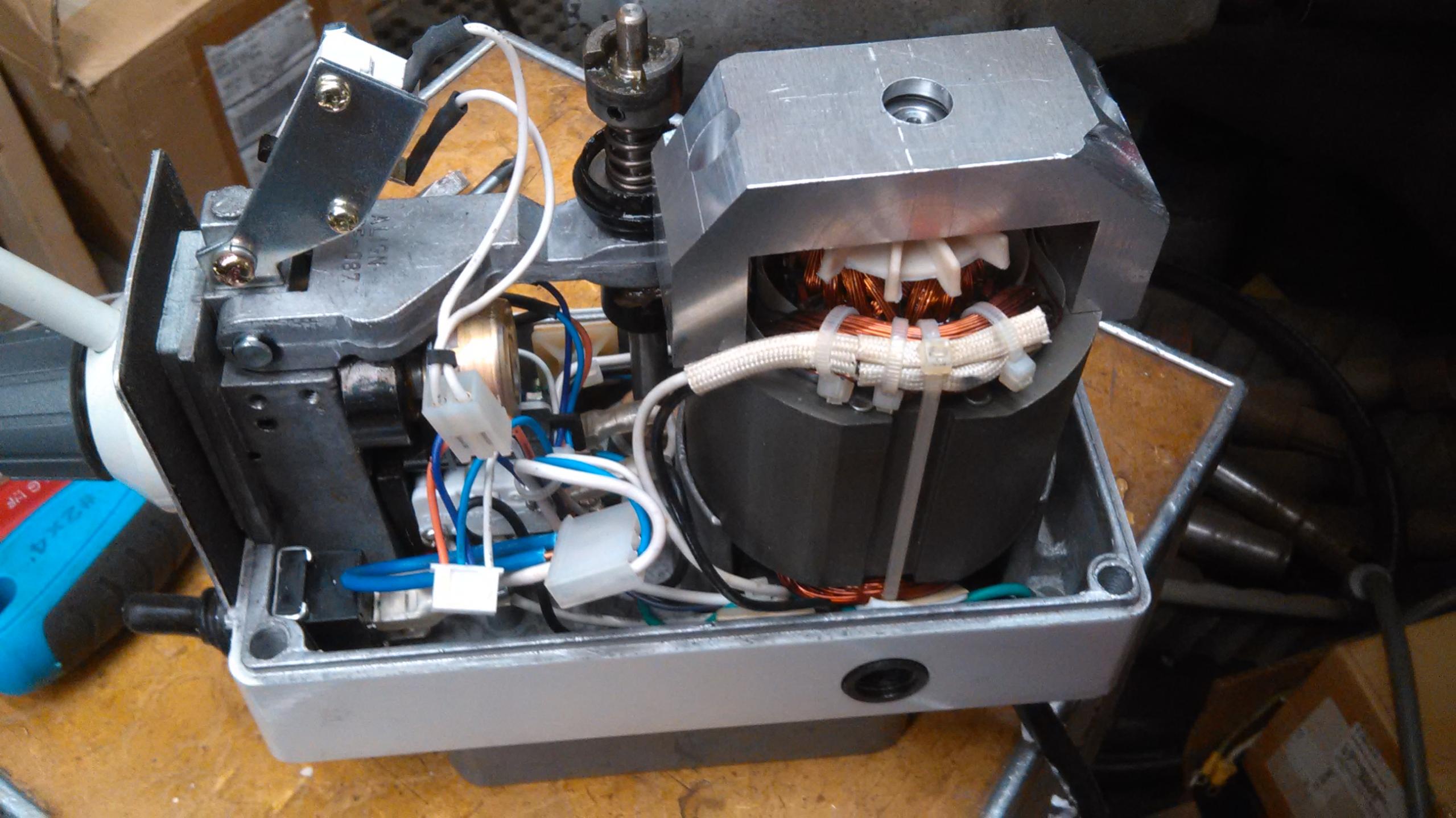

    The part is a motor "end bell housing" so it has to be removable. I'm making an aluminum part to replace the plastic original so I can mount the encoder photo optical piece.
    Simplifying the measurement of bores-img_20180506_154951.jpgNew aluminum test fit.
    Simplifying the measurement of bores-img_20180429_161805.jpgPlastic original
    Simplifying the measurement of bores-img_20180429_161750.jpgNote the top does not have a flat boss outside the ball bearing area. Hence the new aluminum part.
    I've thought of making a tool that mounts in my boring head, that will hold a single straight knurl wheel. So I would knurl the inside surface, then somehow do a better job of boring this out. But I'm thinkin .05mm might be OK, I could cheat and use some sort of deformable plastic shim. I just don't want to fight removing the bearing from this support.
    Sorry for highjacking this thread.

    For the part you are working on if it is the aluminum end bell that is over bored. I doubt if I would do and knurling on the ID. But you could probably simply stake the bearing in place using a sharp pointed punch around the face of the housing to reduce the diameter

    Frank; I don't want to stake the bearing in, I have to be able to remove this motor armature support bracket. The plastic part is a slip fit, it appears to have been injection molded. Just tight enough to hold the bearing, but removable without excess force. That and there are wavy washers that are installed under the bottom bearing, and this top bearing. These washers are probably not so much for floating the armature, but to enable assembly clearance tolerances. This presses on the outer race, and may keep it from spinning. But I've seen bearings shrill before.
    I used an indicator to set the boring head to what was supposed to be undersize. I did measure the bearing bore with a vernier caliper (guesstimator might be a better name) as I did this before I had the inside mic. I hate starting over on a part, but that may be the correct thing to do. I will assemble it first, mount the encoder parts and see if I can get a signal that can be used for a tachometer feed to either an analog motor speed controller, or a digital one. If the bearing does not spin, I'll just move on.

    In lieu of staking I have in past had good success with simple compression. by pressing against both faces of a housing without the bearing being installed My 8 ton arbor press works quite well for slightly compressing aluminum like 6061. The bore will shrink slightly I'm not sure about as much as .002" the most I have tried was .0005 for a .875 bore but it may be worth a shot

    Frank, there is enough material for a set screw to be drilled and tapped. I should have thought of this sooner. And as this is against ball race hard, I won't worry about ending up with a "bite mark" that would make removal difficult.
