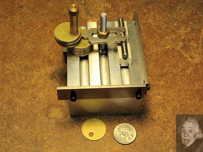

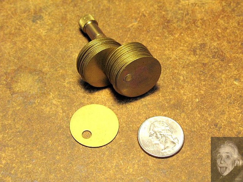

    Works well using key tags too...
    Regards, Marv
