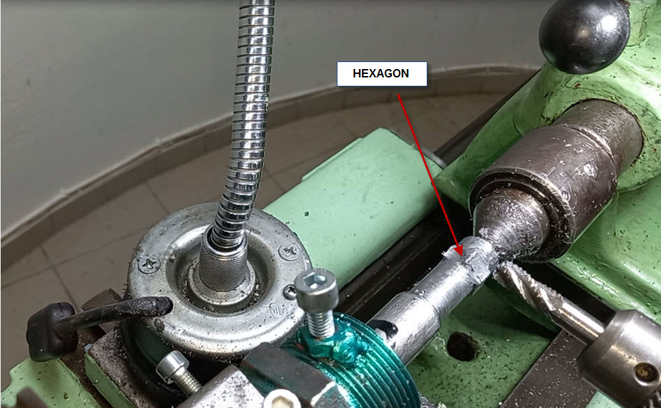

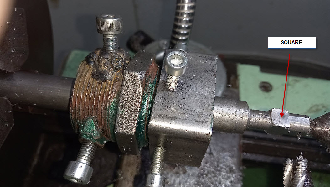

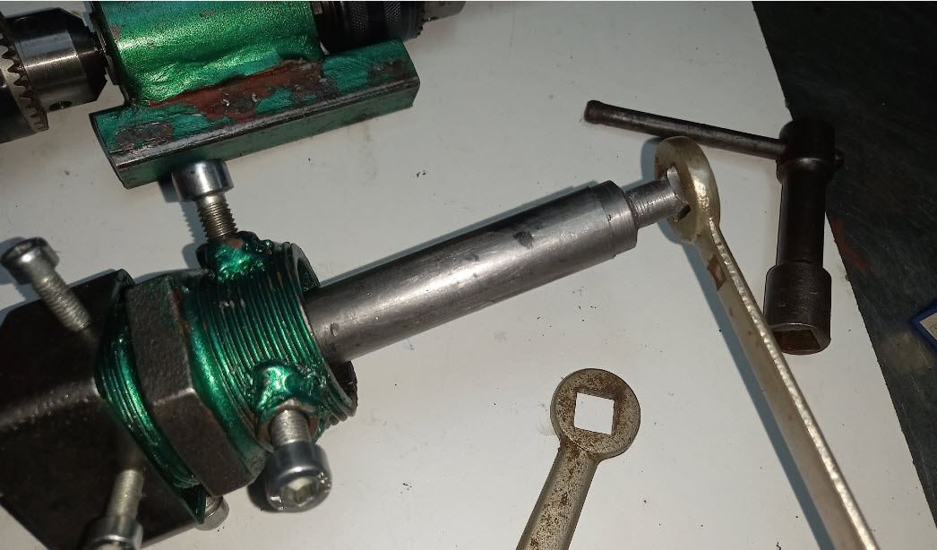

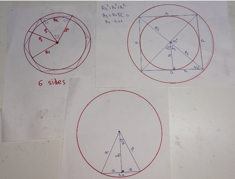

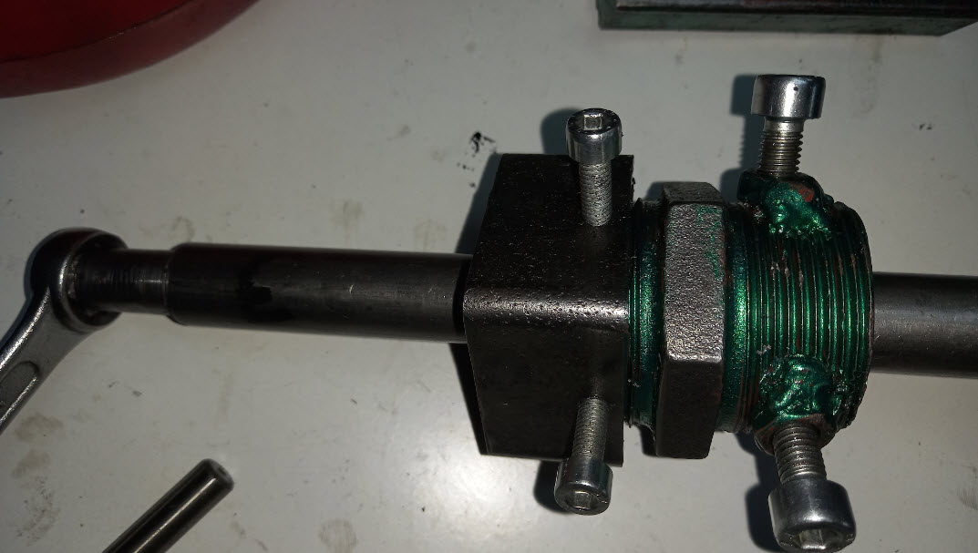

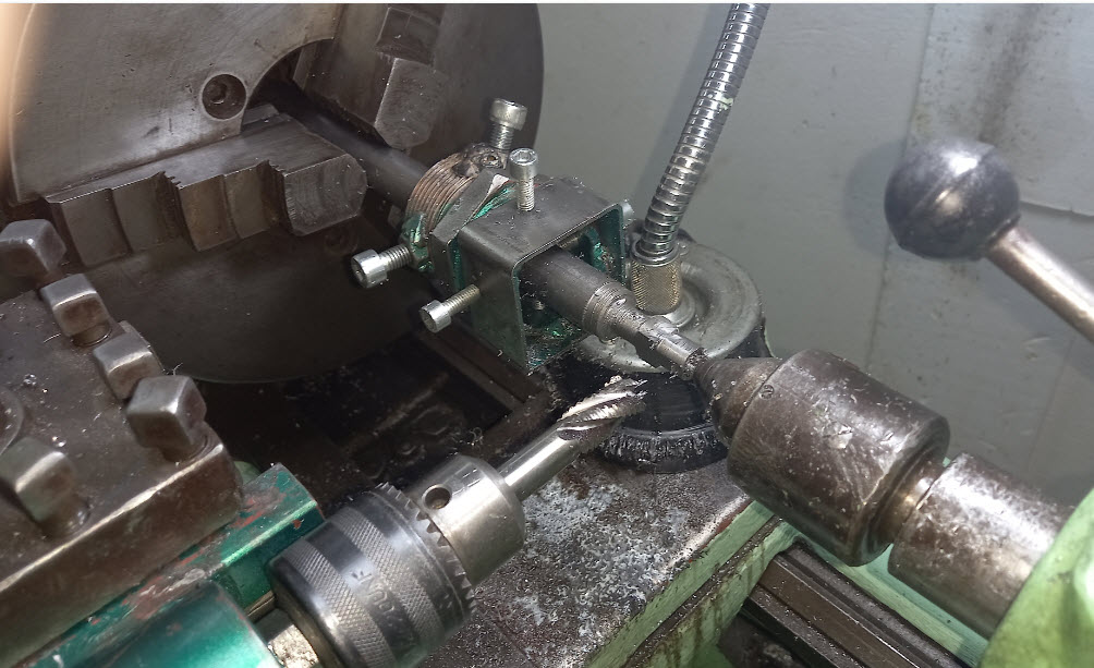

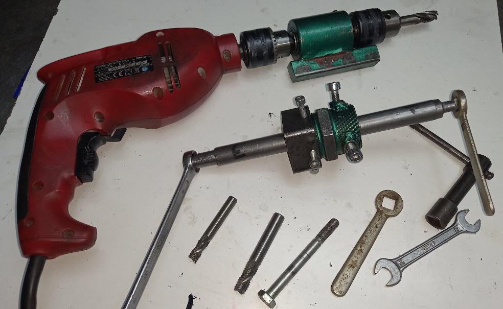

    A simple way to cut external polygon on the lathe without special tools.
