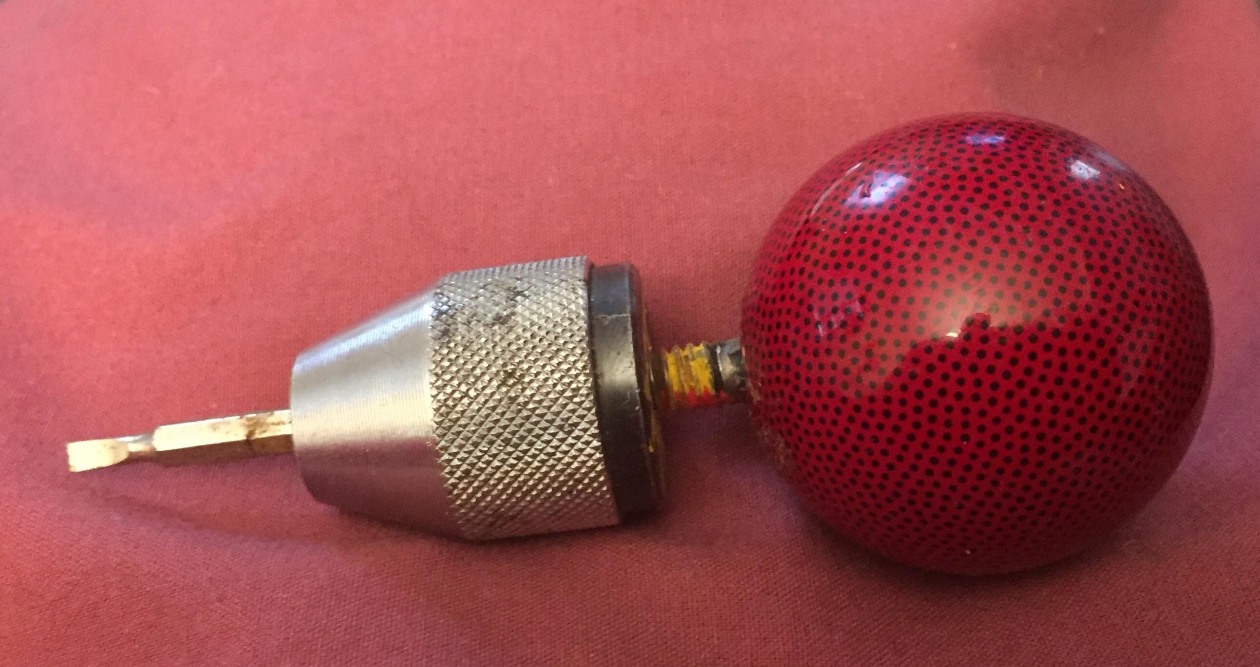

    Quote Originally Posted by philipUsesWood&Brass View Post
    I am finally getting my tools unpacked, and wanted to show a simple Hex Driver or Tool Holder for use by those with Arthritic Hands.
    I have made various tools, to FIT my hands when they get "curled up" with Arthritis.
    This one is super simple, and comfortable. Using a Cheap 3 Jaw Chuck that was itself a 1/4" Hex Driver, I drilled a hole in a Large Scrolling Ball from a MS Mouse. J-B Weld Epoxy.
    I use it for both sizes of hex drivers (small, I think 5/32 & 1/4 inch) as well as a handle for Jewellery files & 1/8" diamond Burrs.
    That Ball is comfortable to my Palm and my fingers Are "Already curled" around it!
    Attachment 24815
    the Bit in the driver is a Small hex Flat 1/8" tip.
    philip,
    From the great Pacific NorthWET.
    I love it! Great use for the trackball! <3

    I recognize that ball! It's a logitech trackball!
    Attachment 24815
    philip,
    Golf balls work well too. Especially for file handles. You have to drill a small hole in them so you don't want the ones that explode when you do that.
    Bill

    Having a multitude of different types, and sizes of files and living next to a golf course, I have gone to using found golf balls for file handles. They just feel good in the palm of the hand, and they hang-up so neatly in a rack on the wall or behind the workbench. I drill an undersized hole and warm up the tang of the file before applying the ball. If it comes off, a bit of epoxy or even cyanoacrylate glue will keep it on.
