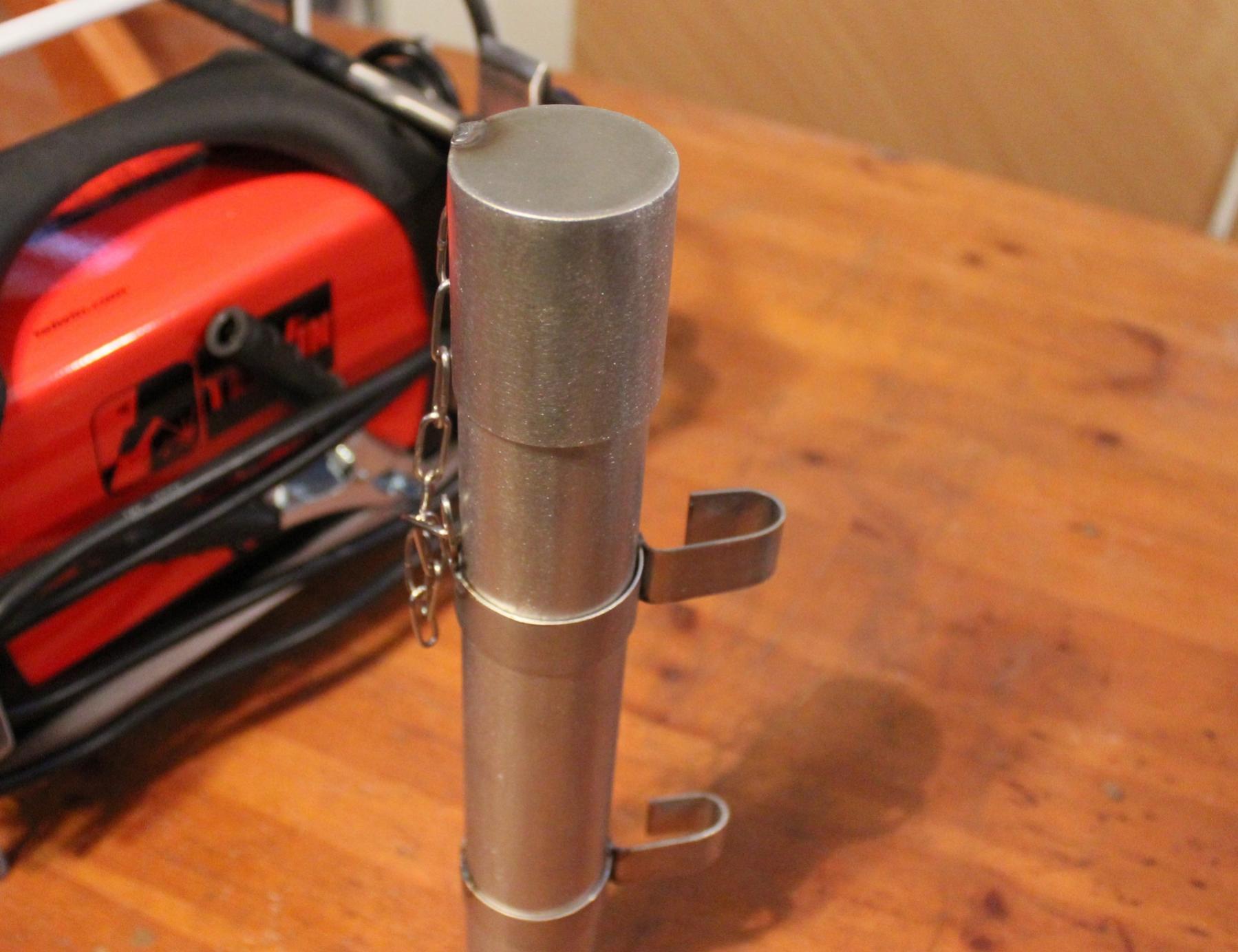

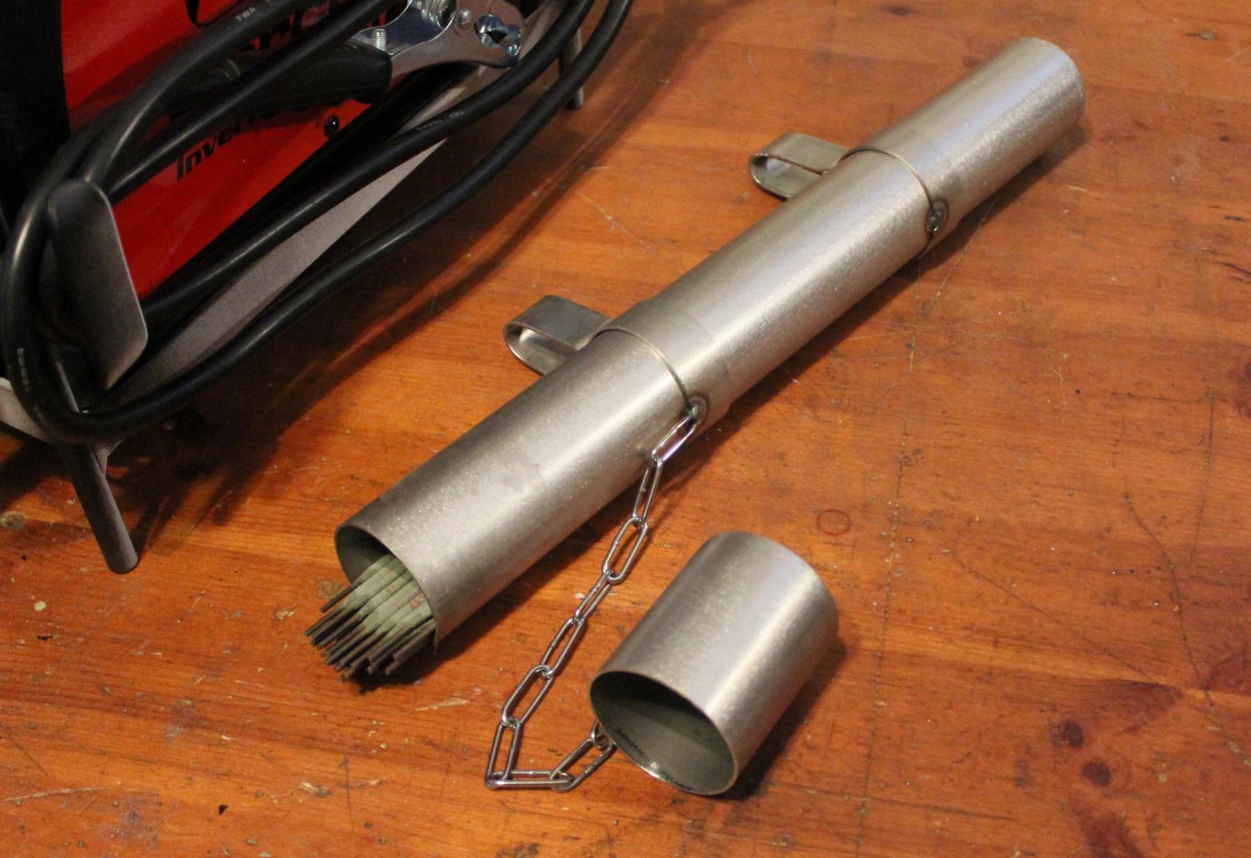

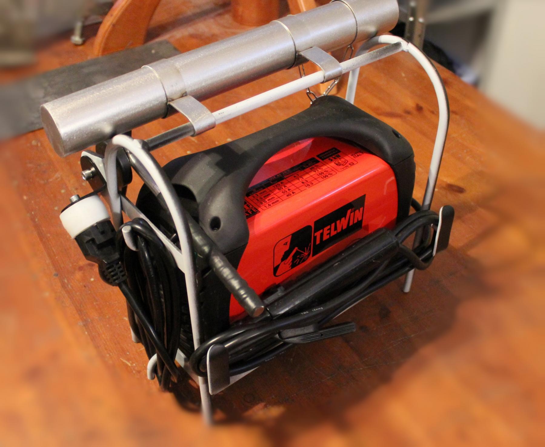

Made a simple attachment to this caddy.
For carrying and storing welding rods.

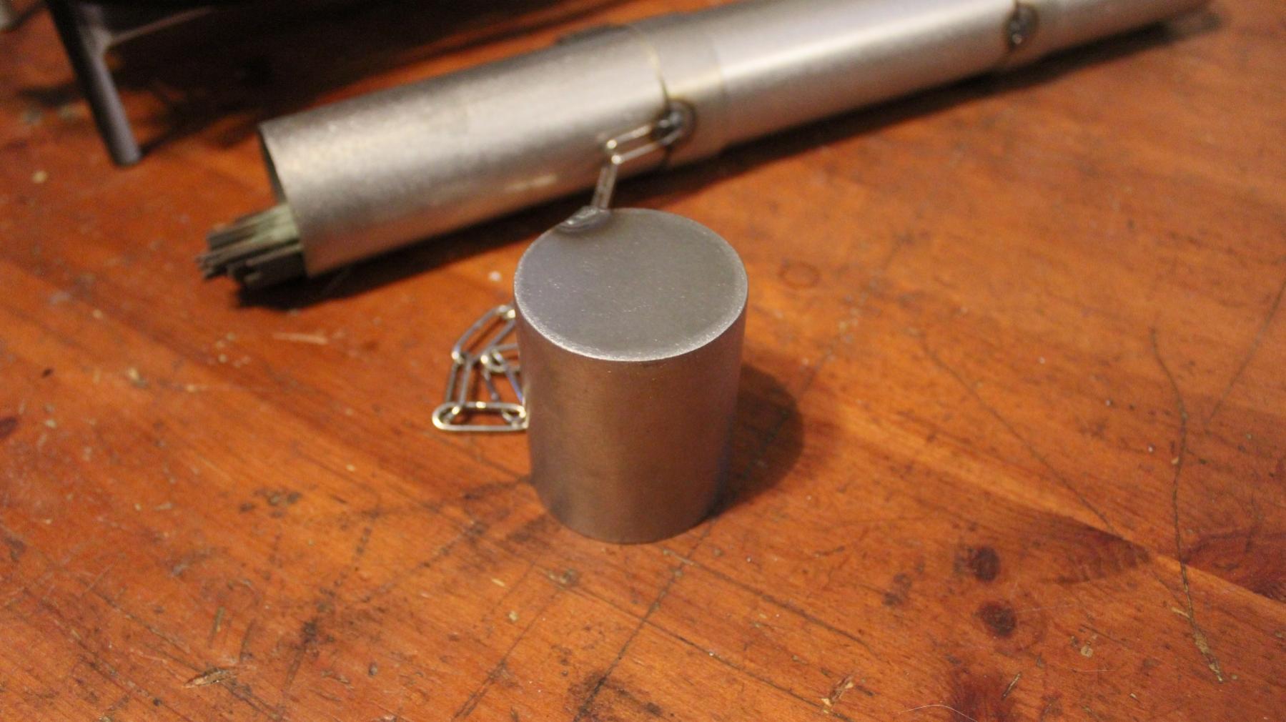

Material is stainless pipe, smaller one has 50mm outer diameter, cap is made from pipe with 50mm inner diameter. Both are with 1mm wall.
Ends are weld from 1mm stainless sheet.
When not in use, i store the casing and rods on top of our central heater and rods stay dry.
