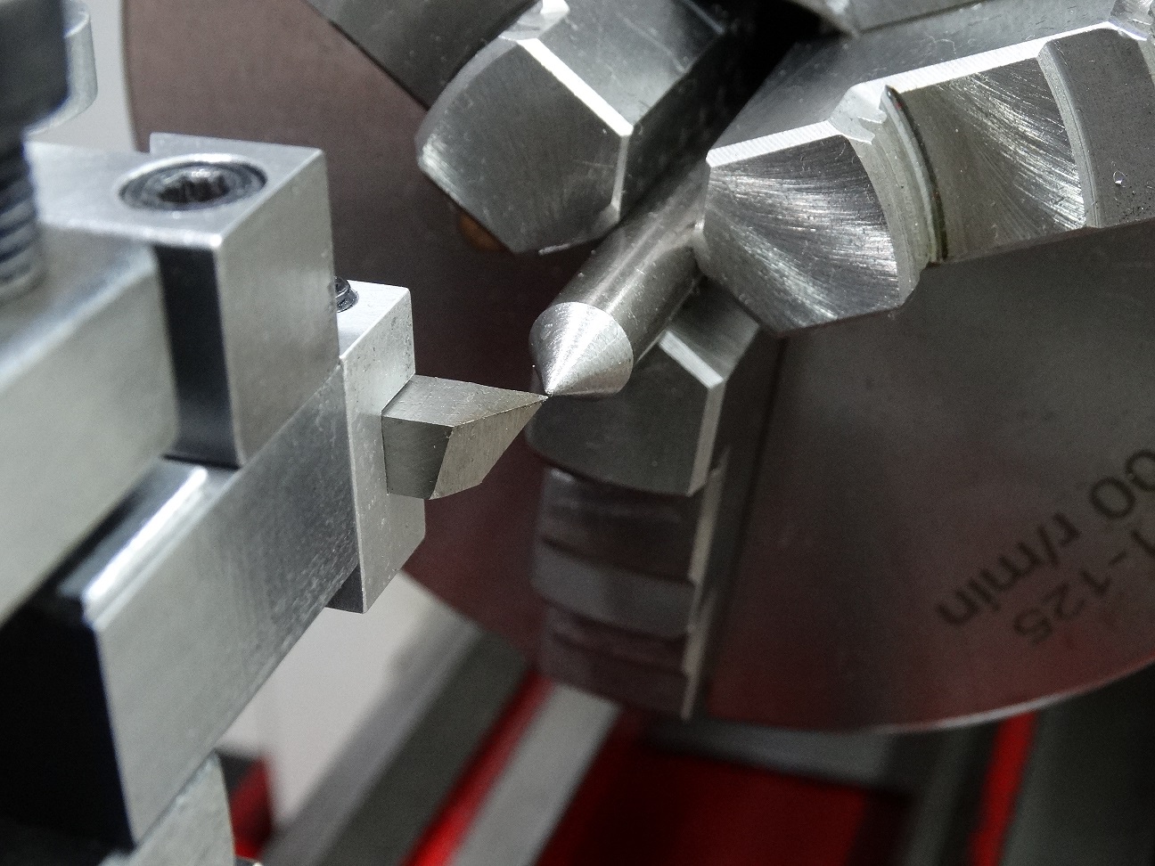

    SIMPLE QUICK TOOL HOLDER!
    Quick change tool holder mounted on a conventional tool post!

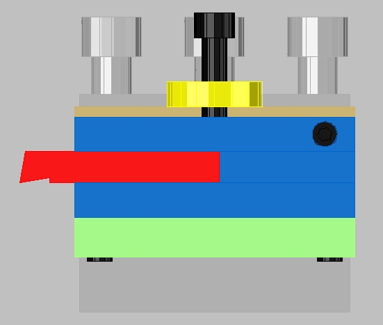

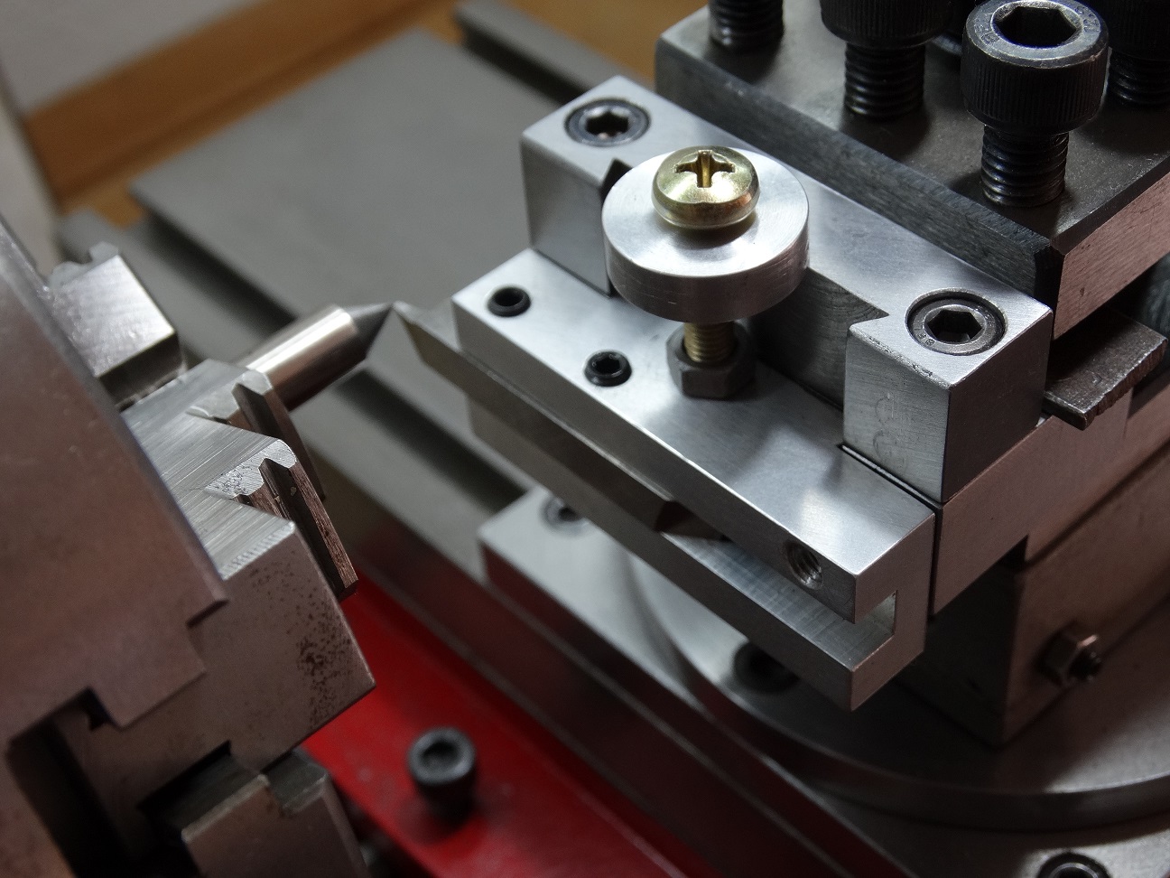

    Other photos of this project!
    SIMPLE QUICK TOOL HOLDER!-th1.jpg SIMPLE QUICK TOOL HOLDER!-th2.jpg SIMPLE QUICK TOOL HOLDER!-th3.jpg

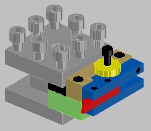

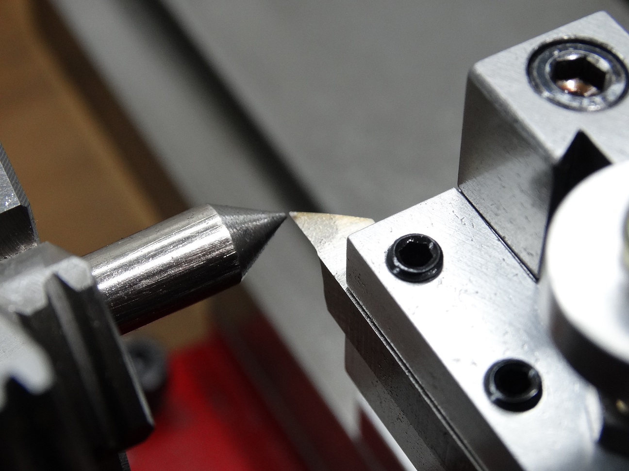

    For cutting operations, it allows the tool to be mounted upside down, reducing vibrations and preventing tool breaks!

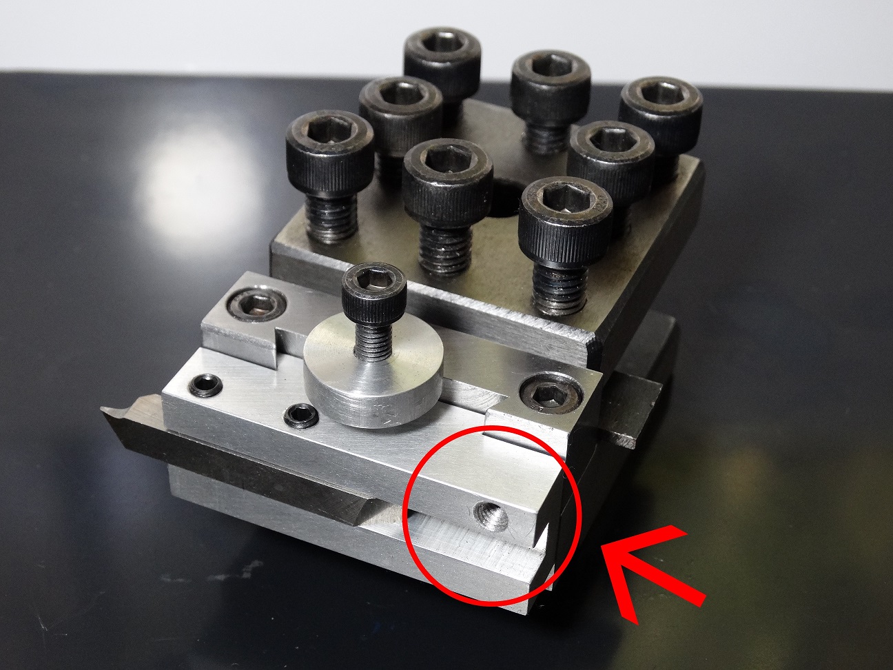

    I like the concept of a QC toolholder that fits into the standard 4 way toolpost. Maybe I am missing something but I cannot see any piston or wedge to lock the two dovetails together. Does this toolholder rely solely on an excellent fit of the dovetails to provide rigidity?

    I believe the set screw on the end is used to lock the holder in place, when the set screw is screwed in it pushes the holder out against the dovetail, I’m sure it’s how it works

    Thanks for that ttmrj. I had not noticed that screw and it would serve to lock the two dovetails.

    That's right ttmrj! I have used it with just one hole and it works perfectly!
