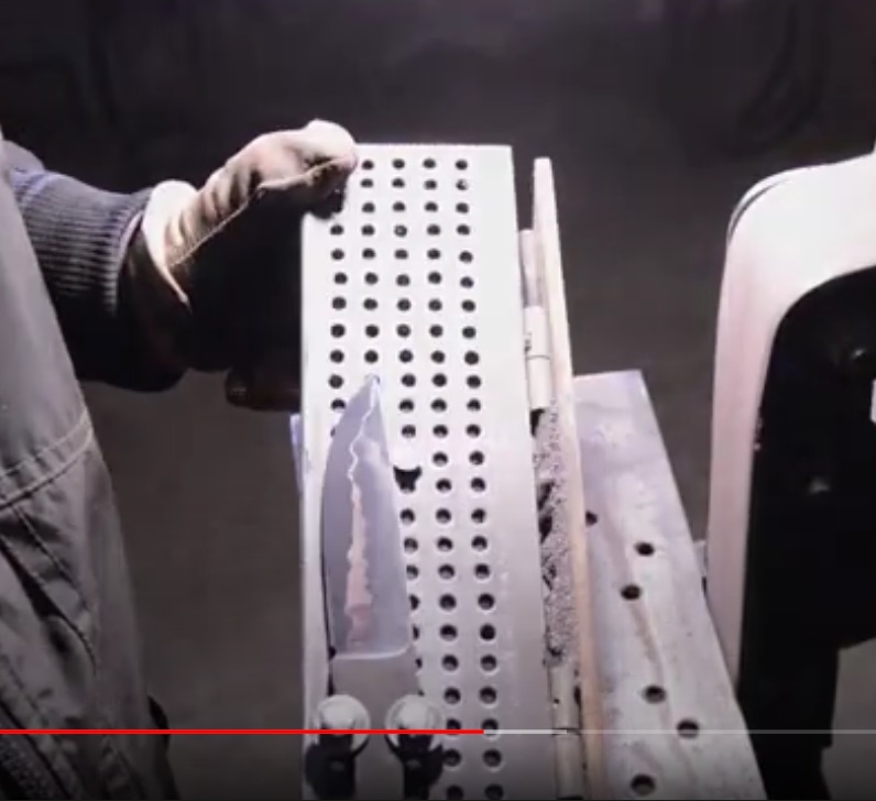

    Simple KnifeMaking Jig made out of 70 [mm] angle iron.
    Allows the attachment of large blades (easily up to 300 [mm]).
    Huge amount of tapped holes helps in finding proper position for different bevel styles.

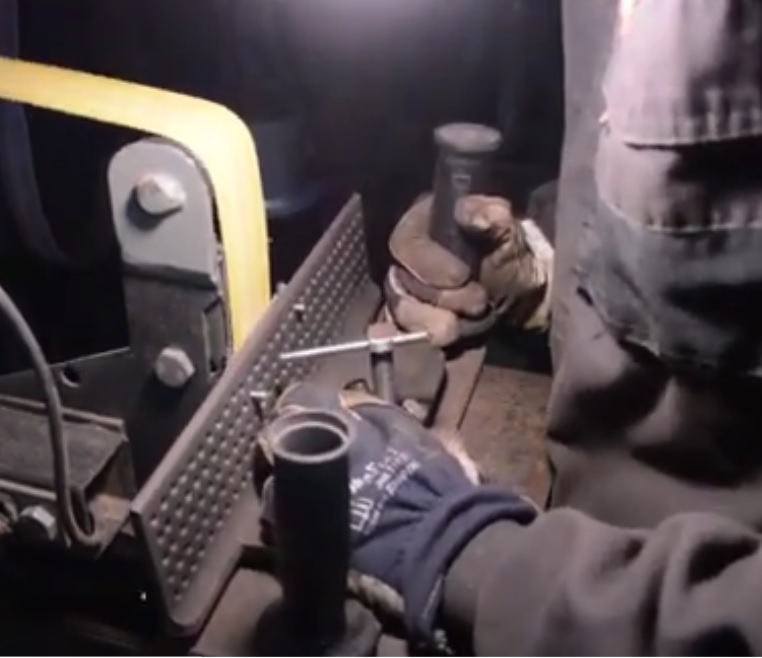

    I use M6 bolts with washers to clamp blanks to the Jig
