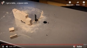

    Im working on a small room, so i need to save space when its possible.
    I made a jigsaw table from a foldable workbench and a metal sheet.
    I can quickly remove the jigsaw from the table and then use it as a workbench.
    Idea can be seen from this 3min video.

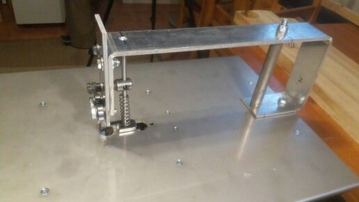

    I also made a prototype from the blade guide from scrap i had. My intention was to make neater one someday..
    But this one has worked so well that i haven't bother to do it, maybe later.
    https://m.facebook.com/story.php?sto...89535234683121
    Mostly i use it to cut alumine, it handles 5mm sheets easily.
