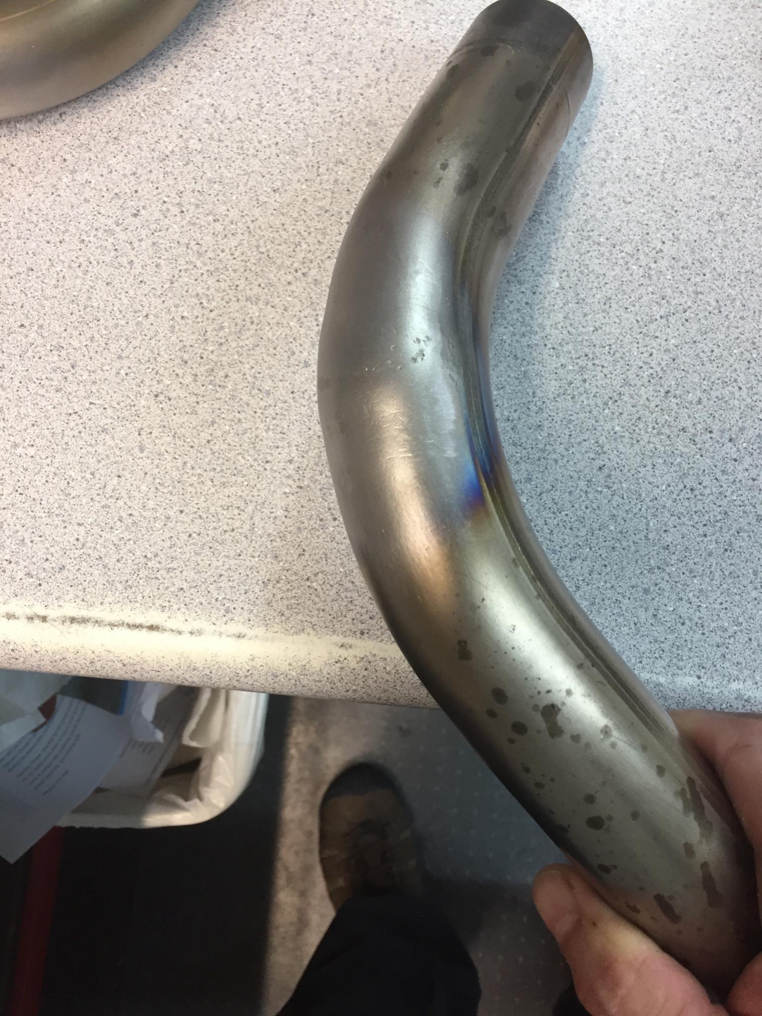

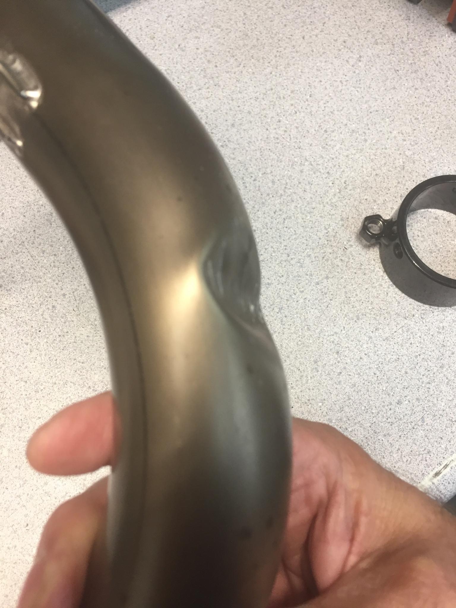

    I just finished taking this dent out of a Titanium motorcycle exhaust.
    Interesting tricks in that video!! Just ordered the sander....THANK YOU!!
    Simple homemade tools for repairing dents in stainless steel tubes for boat rails.-img_0180.jpgSimple homemade tools for repairing dents in stainless steel tubes for boat rails.-img_0181.jpg
