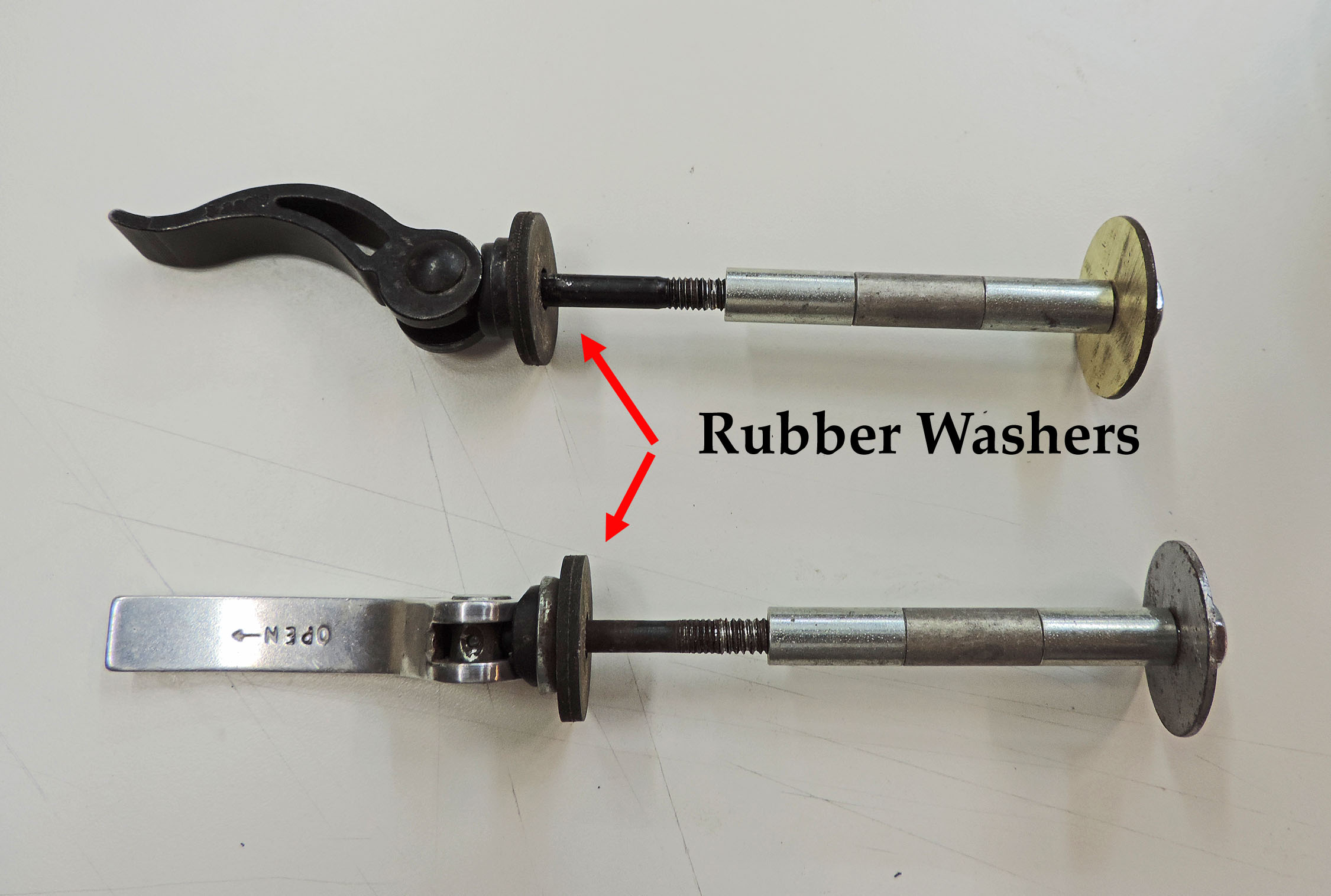

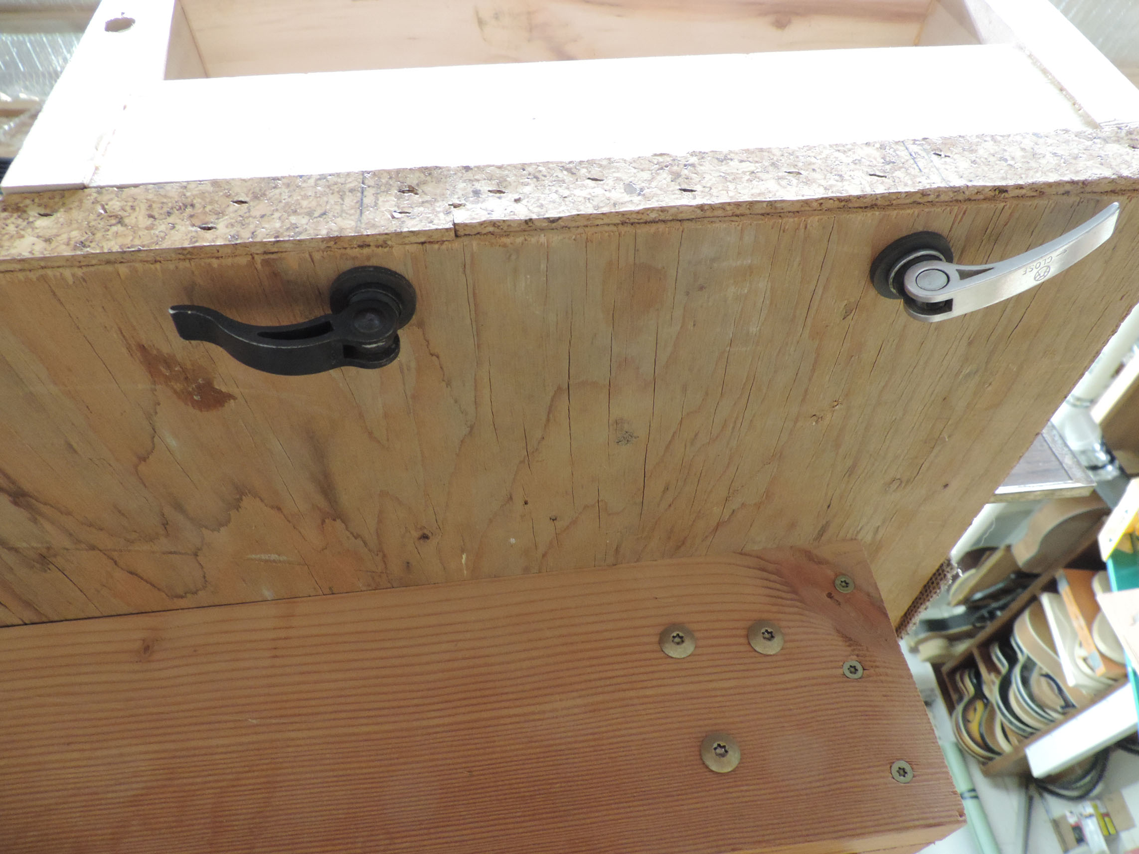

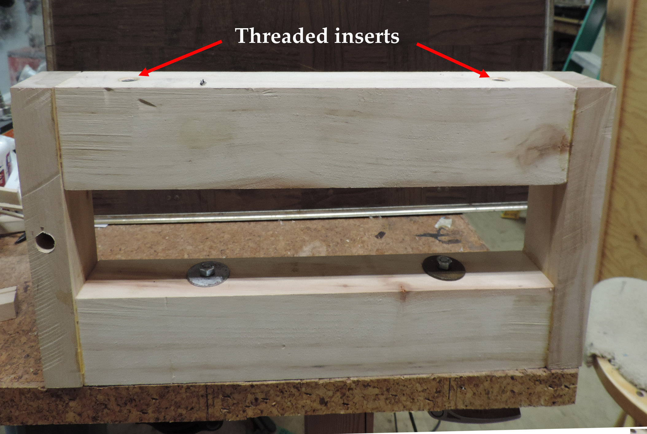

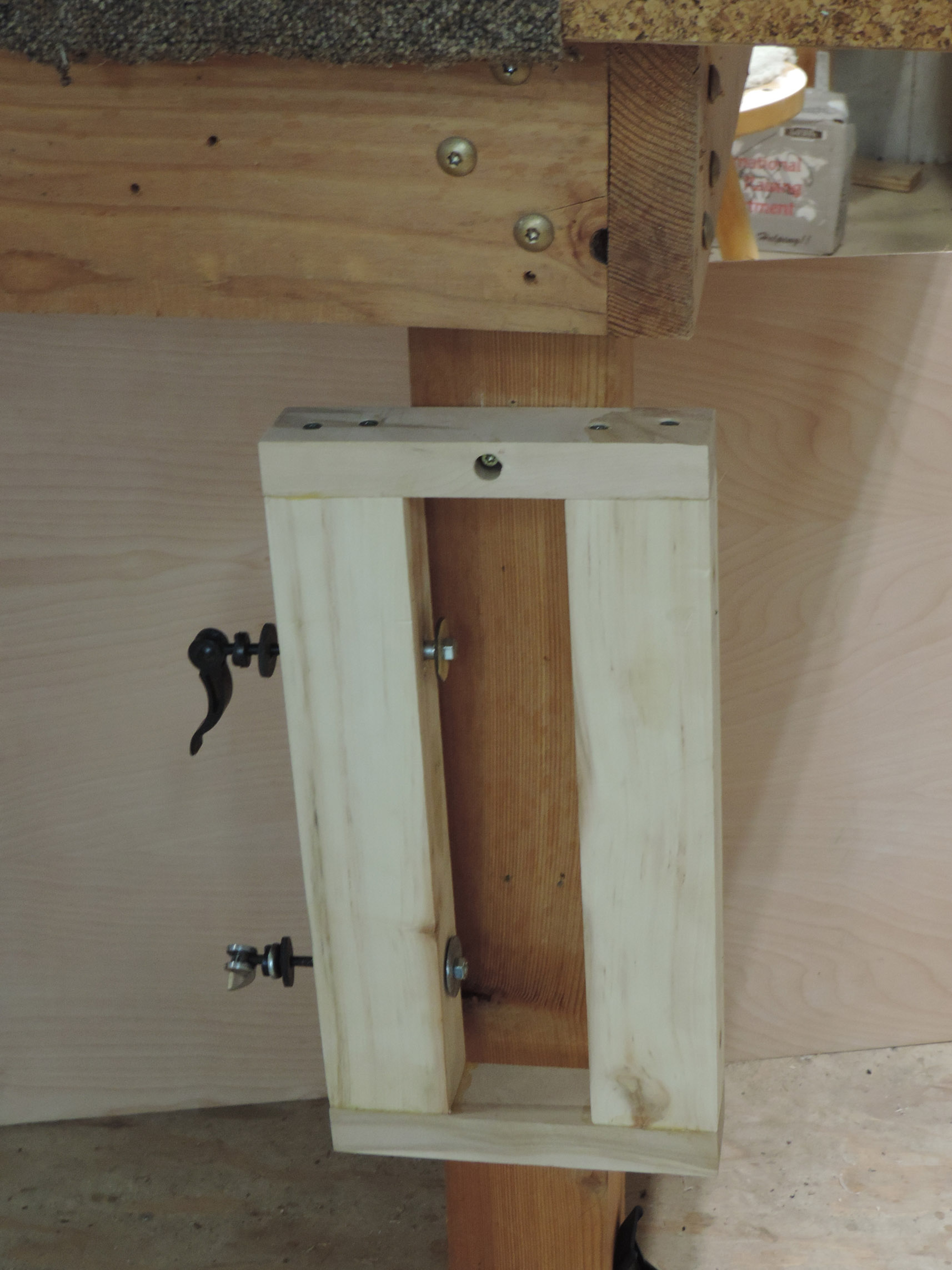

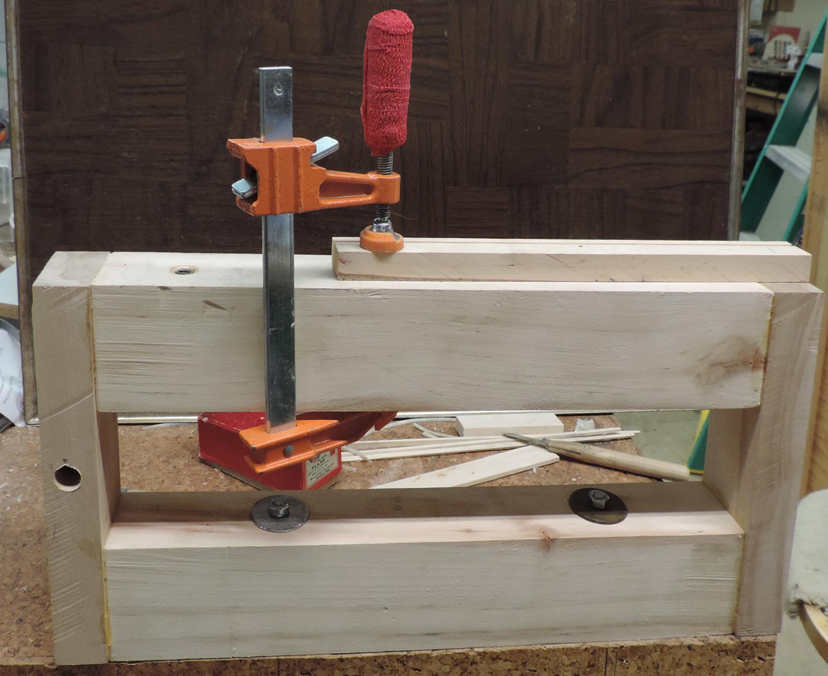

    I made this quick-and-dirty bench bull in a few minutes. The cam locks are made from bicycle parts and modular stand-off segments.
    I plan to make a more complex bull, but this one was an expedient for progress on some lingering projects.
