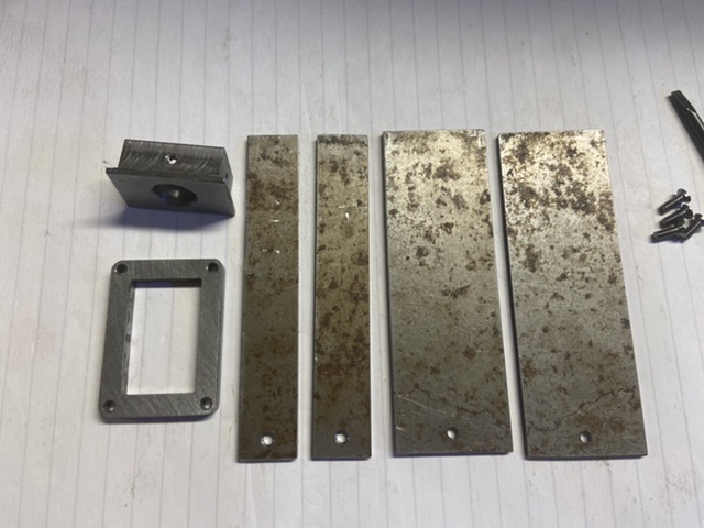

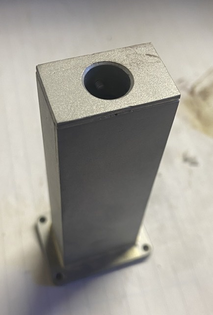

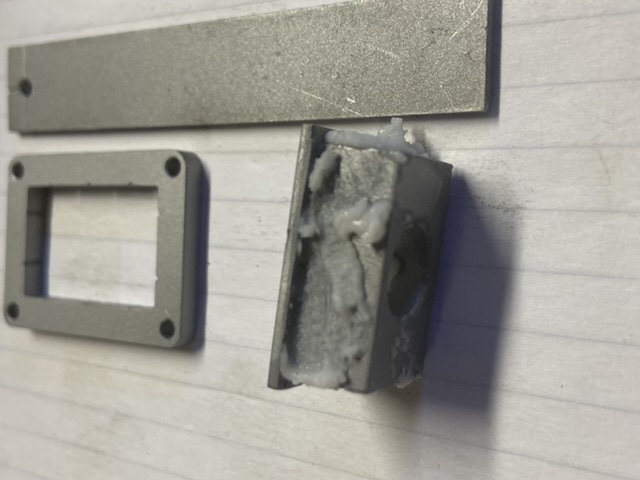

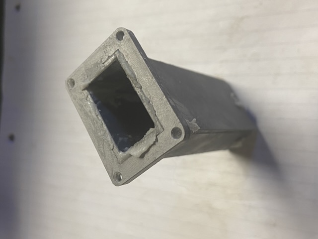

    Fabricated shaft and box housing

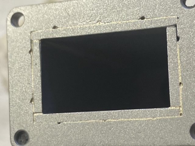

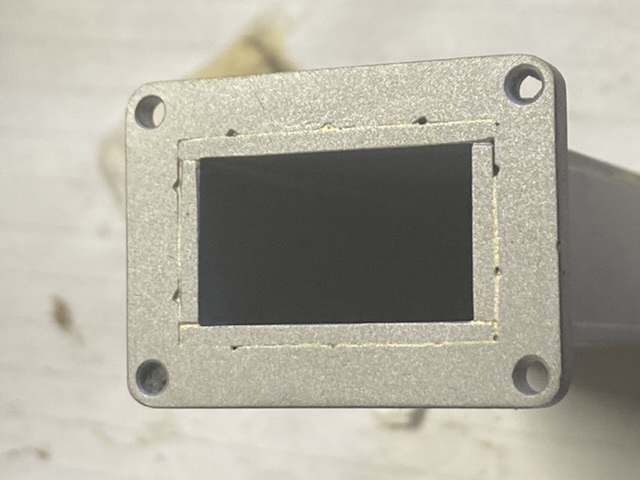

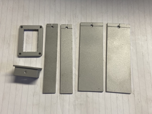

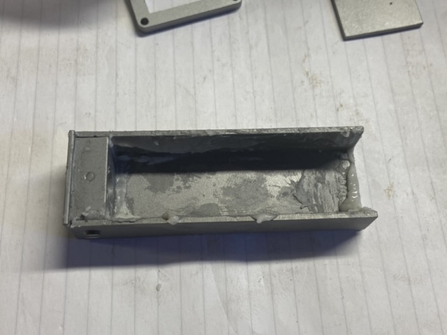

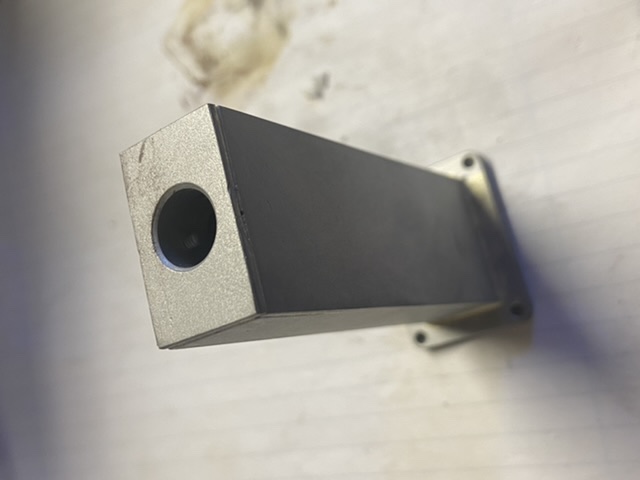

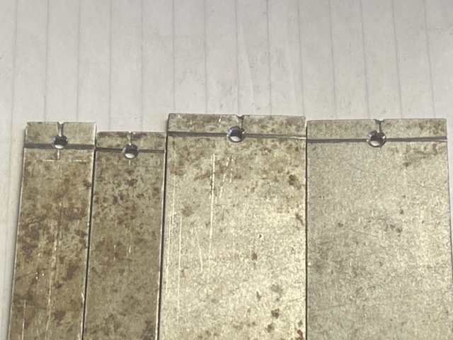

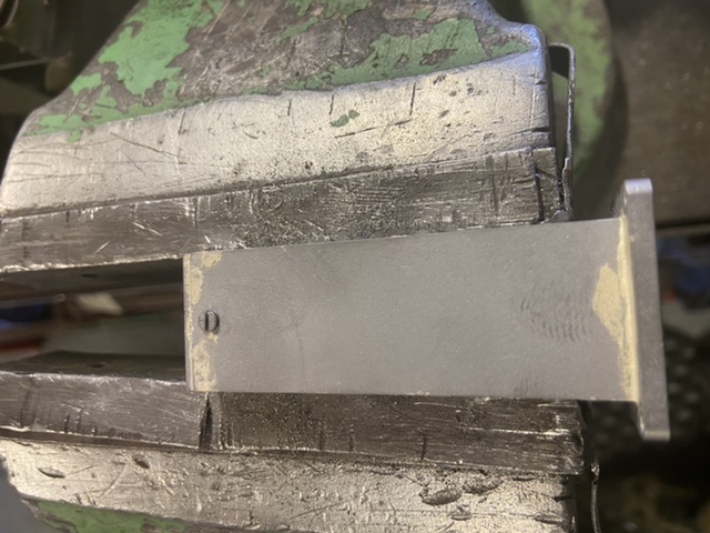

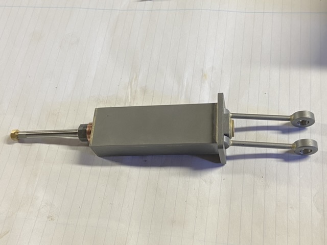

    The clutch linkage is nearly complete and I thought I would share how I fabricated the shaft and made the the box housing with different soldering techniques I use.

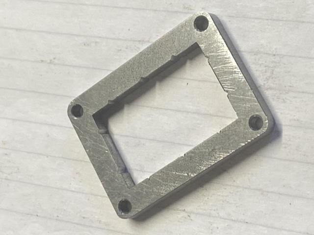

    The box is relatively straight forward as it is screwed together and a mounting flange at the bottom. However screwing matting faces together is not great for silver soldering as there is no gap for the solder to capillary into. To over come this I file notches and grooves where I want the solder to flow. This doesn’t give satisfactory joints for pressure fittings but is great for fabricated components. The notches and grooves allow the solder to penetrate the joint as can be seen in the photos below.
    Silver soldering small components-78ccdb98-24a0-4dbb-8540-f3ed8e9e39a6.jpeg Components to be silver solder together.
    Silver soldering small components-b8e9551c-1036-427a-a467-b8523f2daa0b.jpeg Filed notches can be seen on the inner part of the flange.
    Silver soldering small components-ee5732f9-f82f-45fe-8f52-516bf840540c.jpeg Flat plates that are to be screwed to top bearing block.
    Silver soldering small components-09b4ebf2-b1d8-4421-a592-b2bc7ea83a6d.jpeg All shot blasted ready for assembly and fluxing.
    Silver soldering small components-0237c5de-1a7c-4f96-afcd-81c87066e400.jpeg Top bearing housing fluxed ready to accept plates.
    Silver soldering small components-3bda9708-7aed-413a-98a1-800916dd4a1b.jpeg The seems are also fluxed on the inside.
    Silver soldering small components-df0cb915-4335-442b-9975-814efa10bd35.jpeg Base flange is a tight push fit over plates.
    Silver soldering small components-a83aa85a-72b5-43b1-89ae-9bee86888ed9.jpeg Silver soldering small components-a639b337-1bbf-4845-b7f5-1117f2397c30.jpeg The photo shows that the solder has penetrated the base flange joint.
    Silver soldering small components-3a9c2f03-7ba7-4abd-b460-edfdd49a34b2.jpeg Silver soldering small components-7a0ae89e-2d6b-4cf9-8159-5febb089658b.jpeg The heads of the screws are filed off.
    Silver soldering small components-f0b1a124-a3c2-4fad-bc5e-de01272b7fe4.jpegCompleted box housing for clutch linkage.

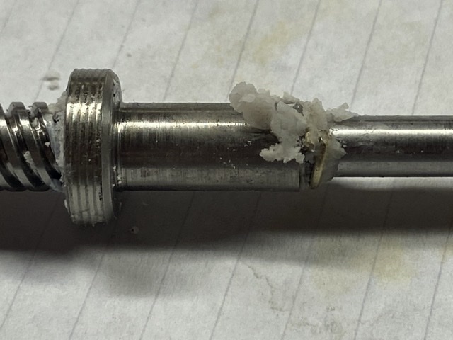

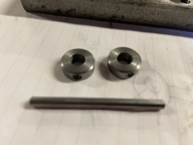

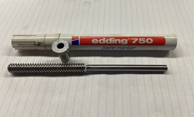

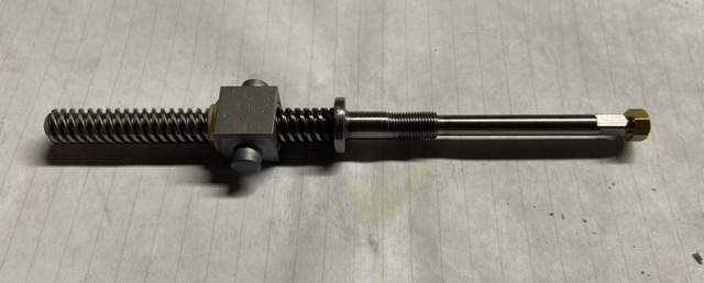

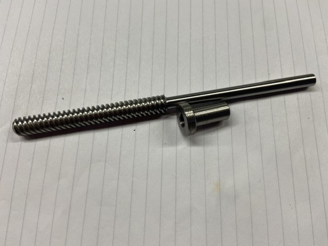

    The shaft is made from a commercially available stainless steel 8mm diameter 4 start thread and a brass flanged nut to suit.
    As this requires a flanged section this is rough turned over size and silver soldered in place. The shaft and the flange section can then be placed in a collet and turned true to each other and to size. The shaft is 3/16”diameter and the flanged section drilled 0.004” (0.1mm) bigger to create the gap for the capillary action.
    Silver soldering small components-985b1721-74b7-48c7-9ed5-90209dc20979.jpeg Shaft and flange

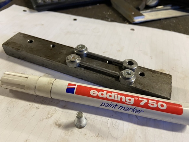

    Silver soldering small components-8e15e47f-7a5a-43fc-8972-85364ad9e0fd.jpeg Again to stop the solder flowing we’re it is not needed the paint pen is used.

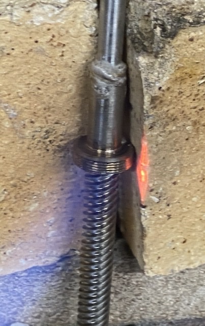

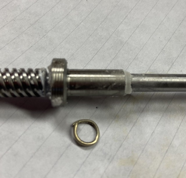

    Silver soldering small components-41ac4faa-ef41-46fd-b2b8-4a2c2c27d50c.jpegSilver soldering small components-99e58128-f039-46ec-874e-60dfb0bb9843.jpeg A silver soldering ring is bent up and placed on the joint and fluxed.
    Silver soldering small components-fdf55ef9-a2a5-4e6d-aa93-f87abeb83a2a.jpeg Heat is applied to the largest section and the heat draws the solder into the joint.
    Silver soldering small components-e71bfb5c-e0b2-46fa-8e3a-70898f1ce511.jpeg Completed shaft awaiting top bearing and locknuts.
    Thank you again for viewing and hope this will help those starting out silver soldering.

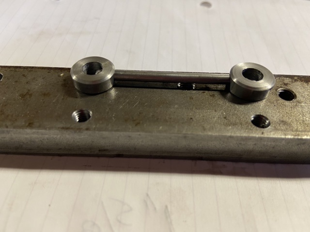

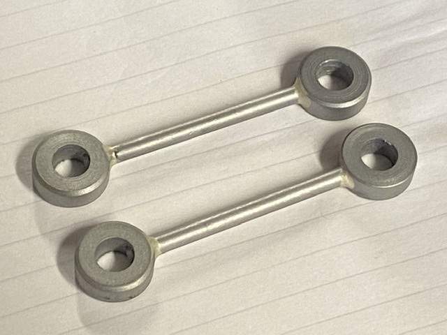

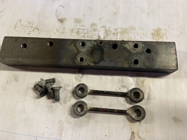

    Fabricated dog bone linkage

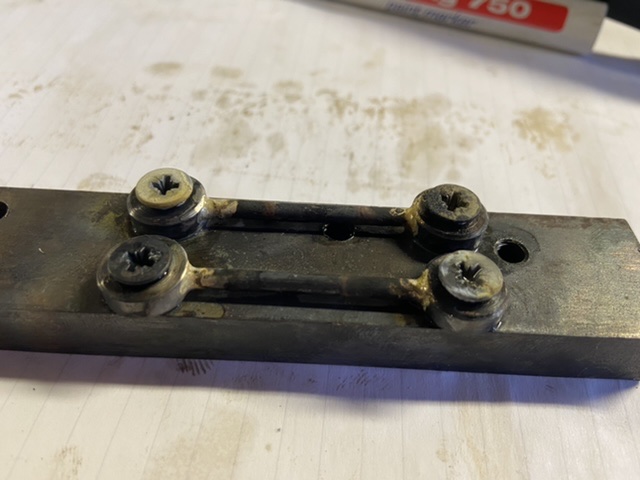

    Nearly on the final stretch of the clutch linkage. The last of the fabricated parts are the two dog bone links which again are a silver soldered fabrication. The most important thing is that the links have both the same hole centres (pitch). To achieve this a scrap piece of material is drilled and tapped at the correct pitch and the ends of the dog bone linkage are held in position with countersunk screws and the tie bar fitted into drilled through holes. The fabrication is completed by soldering the joints.
    Silver soldering small components-1d682b31-6d3f-482e-ad77-1317fd43c56c.jpeg One dog bone link machined ready for soldering.
    Silver soldering small components-9f82d5b3-cd8a-4e3c-ad3a-d7703cd3a632.jpeg Soldering jig
    Silver soldering small components-ba51c417-4eb4-479e-9e0a-55bafa67d085.jpeg Screws painted to prevent solder contact.
    Silver soldering small components-b879490d-5b41-46c9-9d7e-5e0ddb4b807e.jpeg Soldering completed.
    Silver soldering small components-2ab0a17c-c735-4046-8de9-6d8c94873a31.jpeg Removed from jig.
    Silver soldering small components-2ab1de34-e188-42c5-a446-bebb63da247e.jpeg Cleaned up using shot blasting and the holes need to be reamed.
    Silver soldering small components-a12c6706-3f1a-4566-a123-3d870f332e98.jpeg Completed assembly awaiting operating handle. (Not sure if you make single crank or wheel type).
    Thank you for viewing
    The Home Engineer

    If you don't happen to have a paint marker available, another material you can use to prevent silver solder from sticking is correction fluid also known as "White out".
    It's a opaque liquid that dries after it has been applied and was used to mask text errors on paper.
