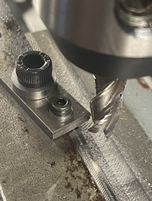

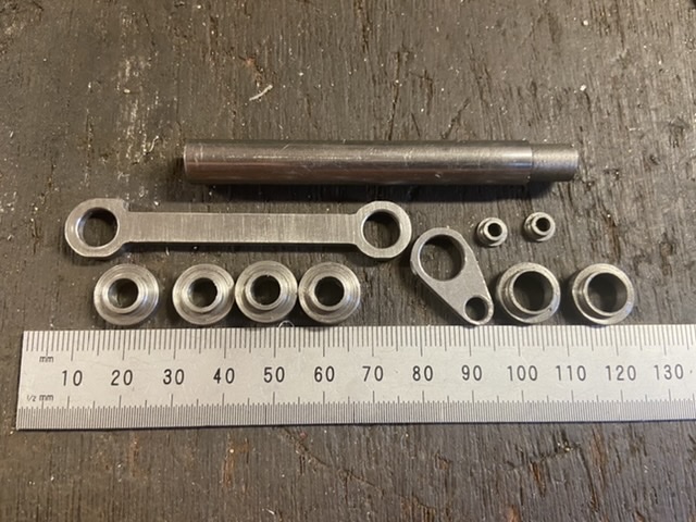

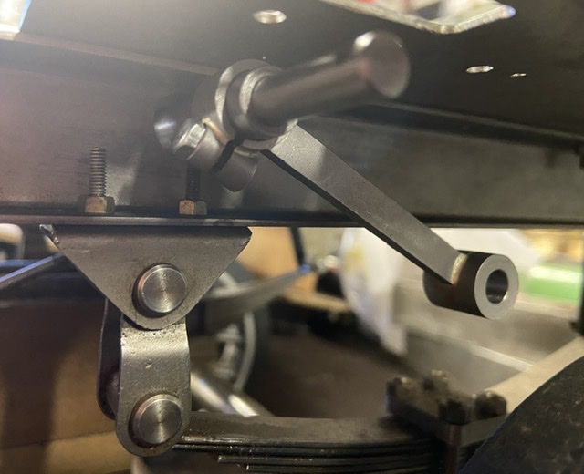

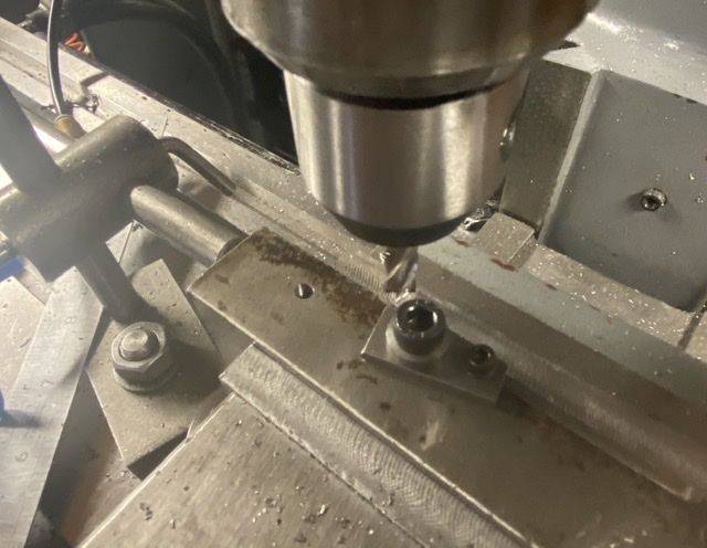

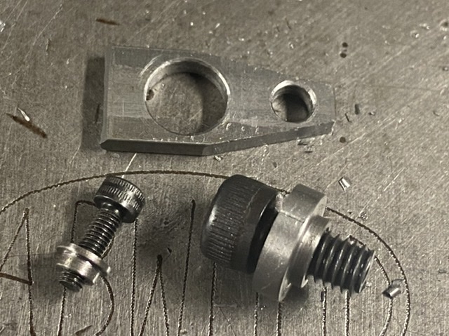

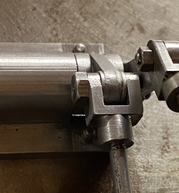

    I have progressed the clutch linkage and have fabricated some of the levers using silver soldering.
    I have included some photos of the process I use to machine tapers on levers etc.

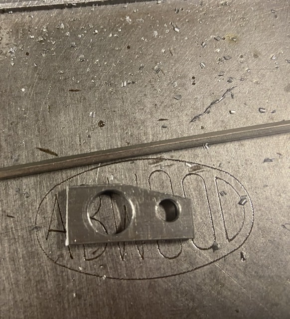

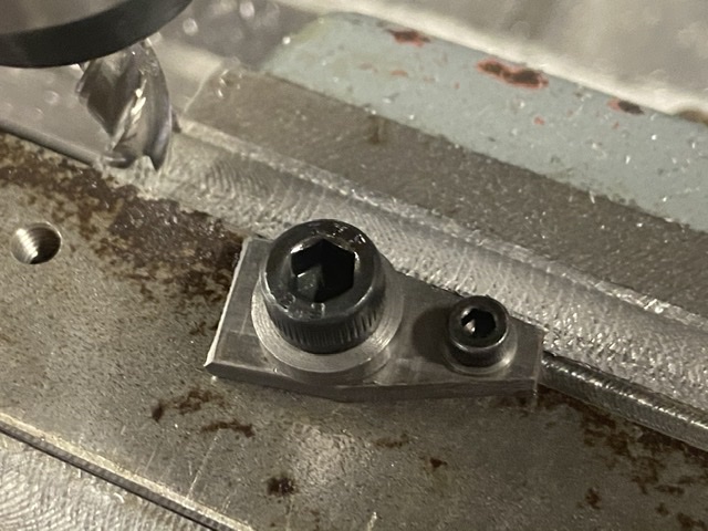

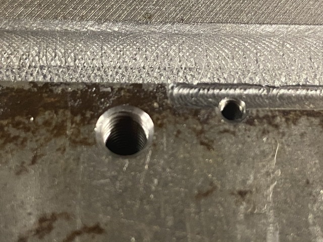

    To machine the tapered lever, the two holes are drilled at the correct pitch in the stock material. Then the coordinates are calculated to set the workpiece at half the required inclusive angle. A sacrificial piece of material is then drilled tapped at these calculated coordinates to set the piece at the correct angle. The lever can then be clamped and machined to produce the first taper. To complete the process the lever is flipped over and the second angle machined and then filed using file buttons to the final shape. The photos below will hopefully make things clearer.
    Silver soldering small components-665b5a3e-7aa2-4252-8cff-db1413cae4ae.jpeg Clamp screws and lever ready to be filed
    Silver soldering small components-1c2f9b81-75a0-4ebe-bca7-aa7f8d4bf851.jpegThe completed parts ready for soldering
    Silver soldering small components-942fcf87-5806-42a2-9b4e-e7eccdc75b8c.jpeg Sacrificial material drilled to set angle
    Silver soldering small components-fa0bf4c8-bddc-4351-b4b2-6df381ead20e.jpeg Silver soldering small components-6d060f93-f1a8-4f24-af80-b26b8b943095.jpeg Silver soldering small components-66976b61-b109-441d-868b-dc6918a77f69.jpeg Machining first taper
    Silver soldering small components-7f621444-3d36-42d3-b9c8-2dd13c169363.jpeg Second taper completed
    Silver soldering small components-82538fad-1ed2-4fd7-960a-384c78c05684.jpegCompleted taper lever
    Silver soldering small components-217ab06c-dc76-4760-a3d2-9d075b2ead79.jpeg One of the soldered links in place on the engine
