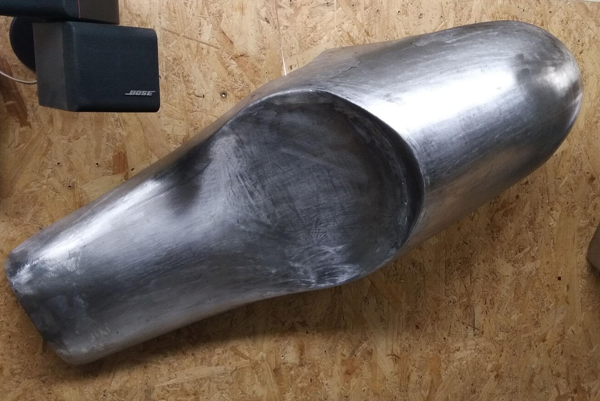

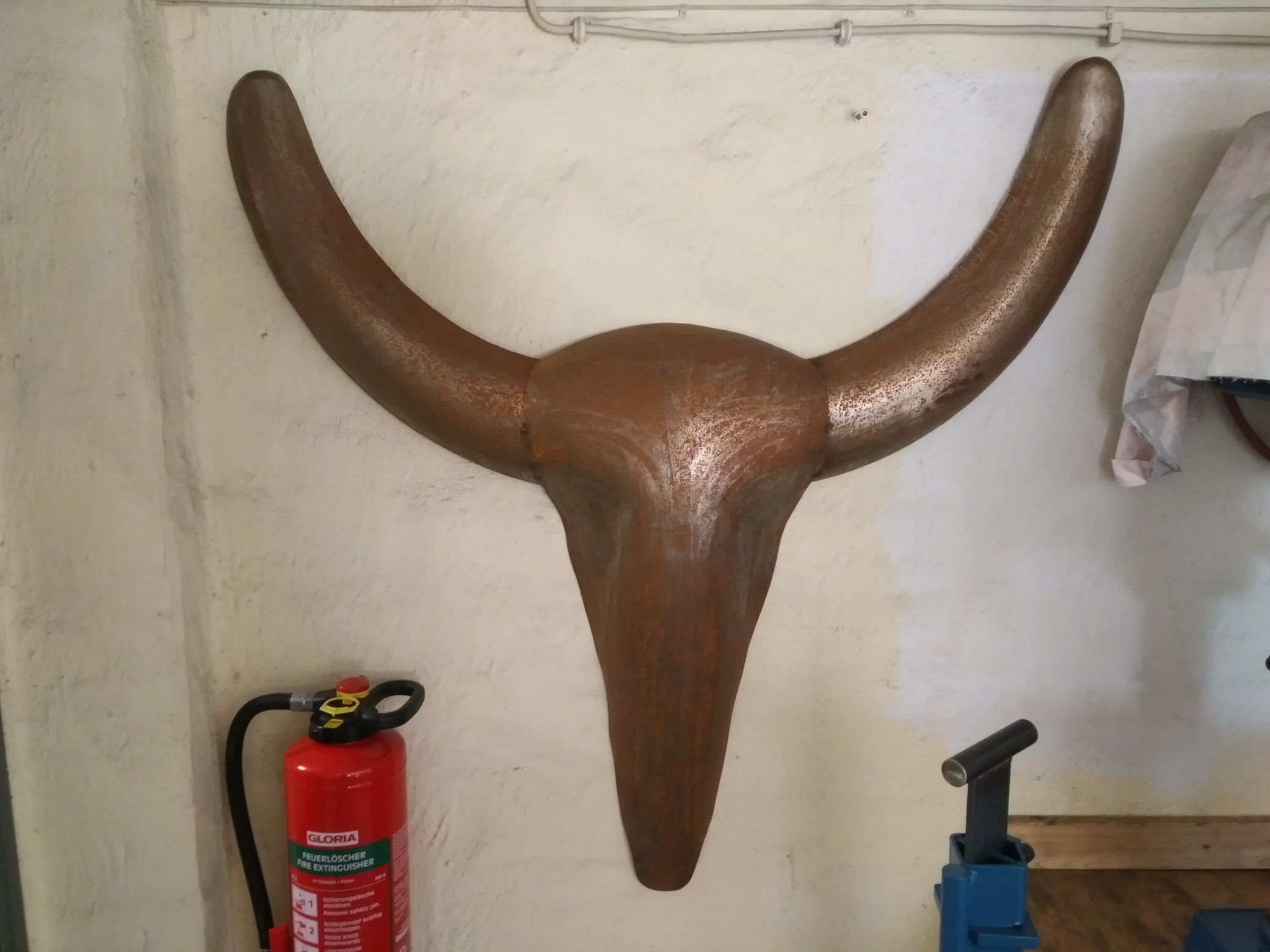

    Very nicely done! It's great to see it in action. I found it interesting to see how much the frame deflects when it is putting pressure on the material to stretch or shrink. As heavy duty as the design and built, it generates a lot of force!!
    What do you plan to make with it? I see a motorcycle in the background......
  11. #20
    Supporting Member Charst's Avatar
    Jan 2018
    18
    Thanked 71 Times in 10 Posts
    Charst's Tools
    Yes 7.800 pounds is quite something... but it's within the permissible yield strength.
    I am mainly using it for bodywork on motorcycles or artwork (see pic)
    Cheers
    Charst
