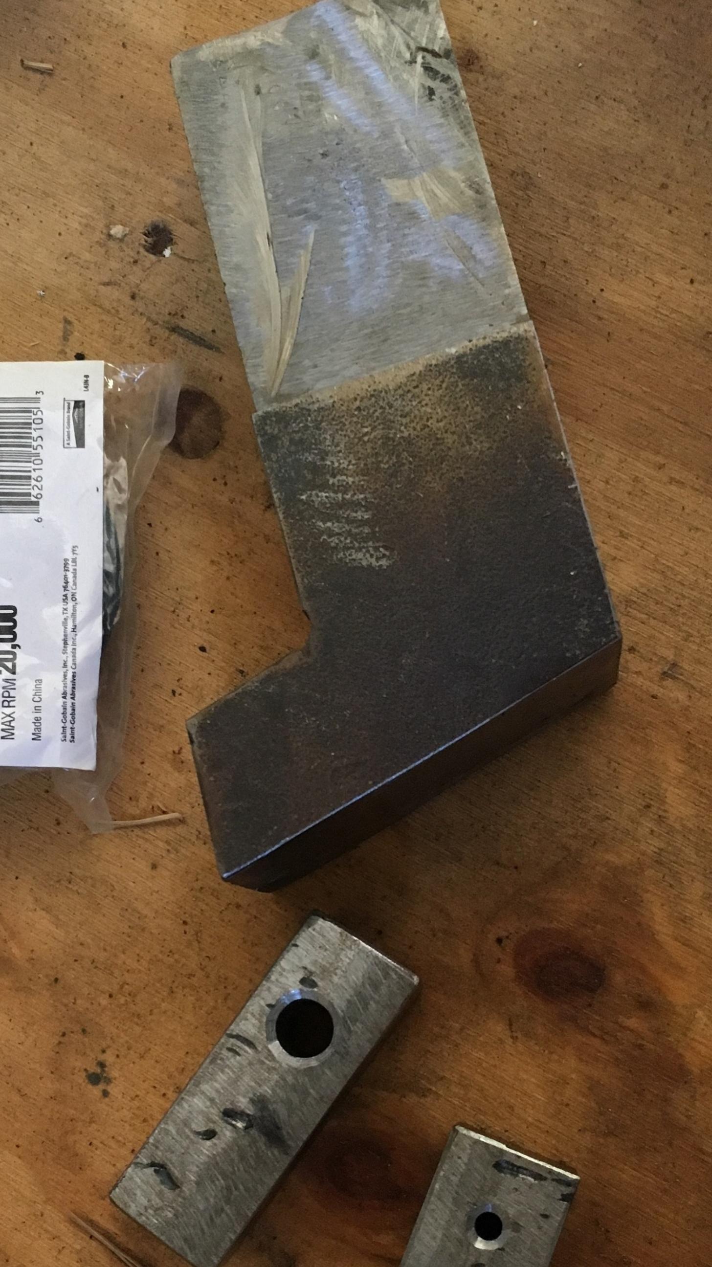

    Having a go at making my own shrinker/stretcher from plans I found on the net.
    Shrinker/Stretcher-20170503_225953795_ios.jpg

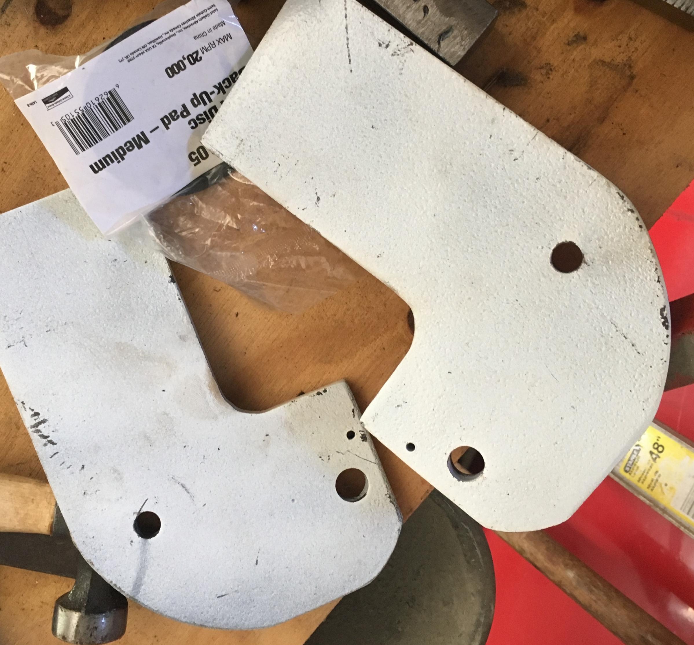

    Some of the bits.
    Shrinker/Stretcher-20170503_230047049_ios.jpg

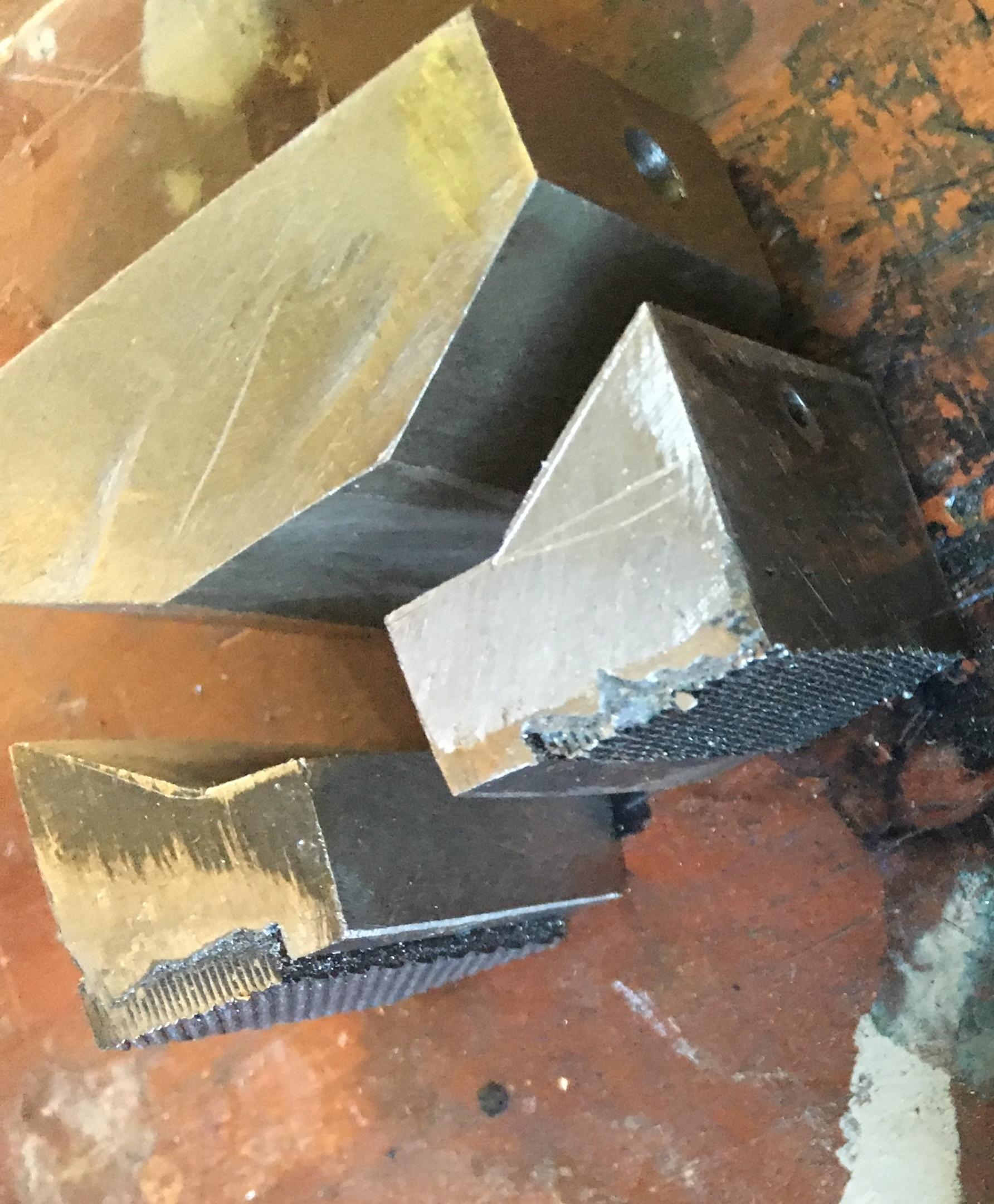

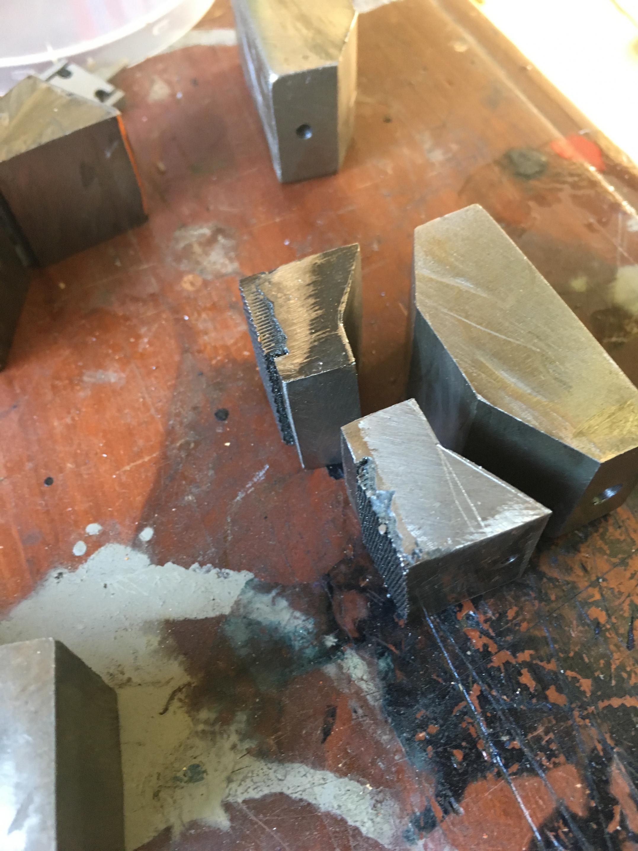

    Some more bits
    Shrinker/Stretcher-20170503_230045452_ios.jpgShrinker/Stretcher-20170503_230025861_ios.jpgShrinker/Stretcher-20170503_230014009_ios.jpg

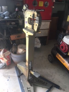

    Shrinker/Stretcher-shrinker.jpg Bought this for the right price complete with both sets of jaws. Will still finish building one though.

    Very interesting build. Are plans still available? What do you think of them, are they complete?
    I would love to see details of the build like jaws and the patterns/teeth and how to make the patterns. Do you have to use special steel or just cold rolled?

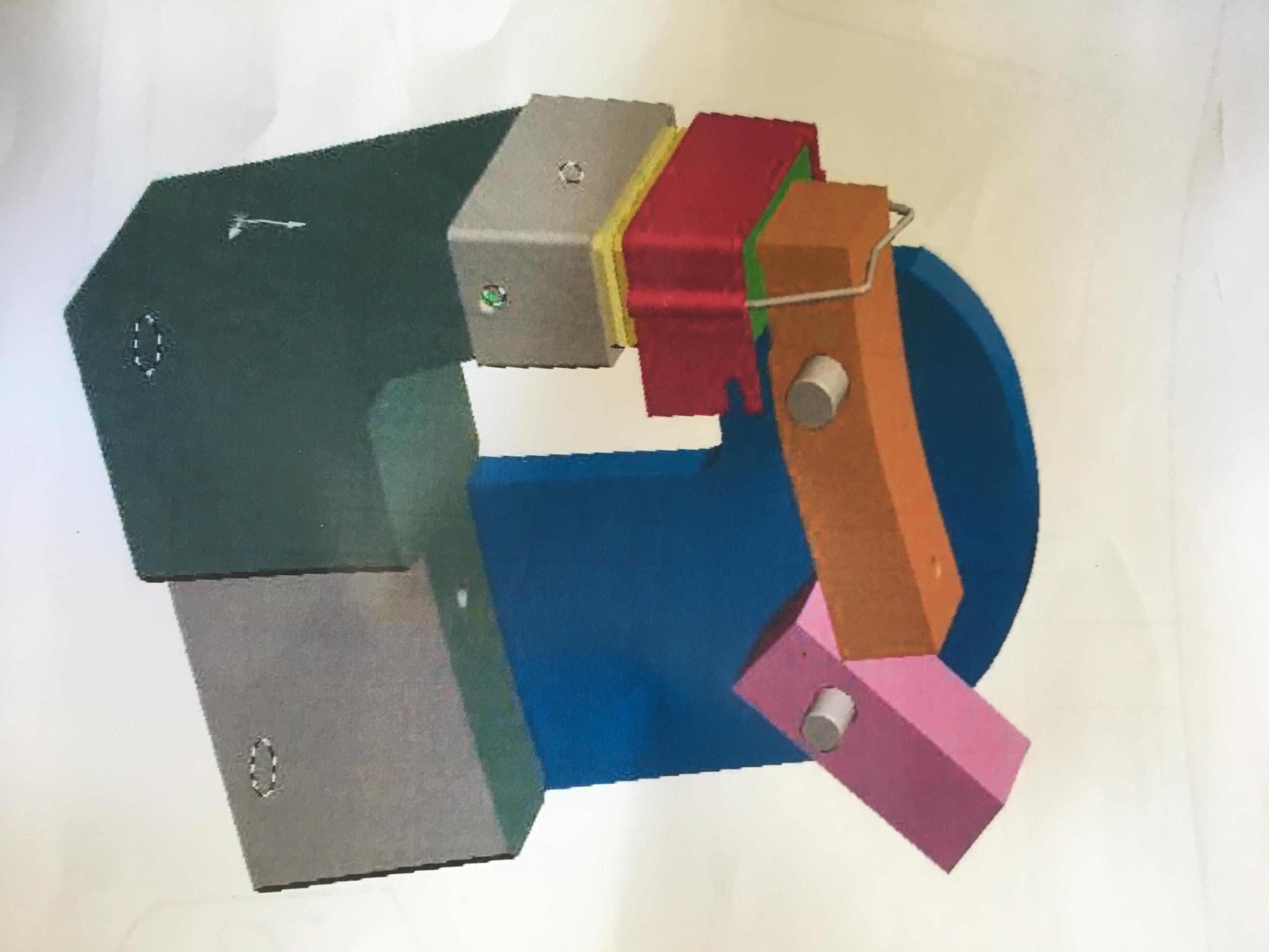

    I've only use mild steel and welded on pieces of cut file for the jaws. I don't know if it will work but time will tell. The plans look OK but after looking at the Metal Man one I bought, the jaw plans lack a little detail. Having said that though, good old google should be able to fill in the blanks with that. If you just search google images until you find a picture like the CAD one at the top of this thread you should find them. They are also on 'scribd' if you subscribe to it. All free.
    I'll add some more pics soon.

    Thanks for the tips. It would really help to check "real" one out closely. For that matter you can buy hi end jaws, but that would probably make the whole build moot. You'd end up close to what a shrinker/stretcher costs. I'm not even sure if you need or want hardened jaws. I watched a guy make new jaws for his vise with a Atlas shaper like mine. So it might not be as big a deal as I'm thinking it is, or I'm so clueless I can't know
    It looks like the one you bought is one of the nicer expensive ones. I've been contemplating metal forming for a long time and just not gotten down to it in a serious way yet so can't really justify the big $$$ a name unit costs.
