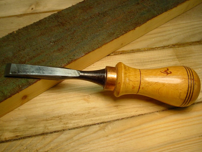

    Here is my favorite chisel :
    Short chisel are always really handy, but poorly available in hardware stores.
    I made this one by cutting out a long Chisel with the Dermel cutting wheel, and regrinding a bevel, frequently dipping it into a jar of water, to avoid loosing it's temper.
    The handle is turned out of beech. Oil finish.
    Cheers !
