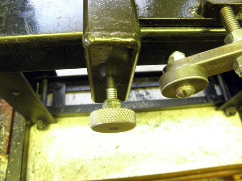

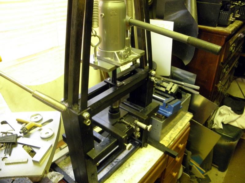

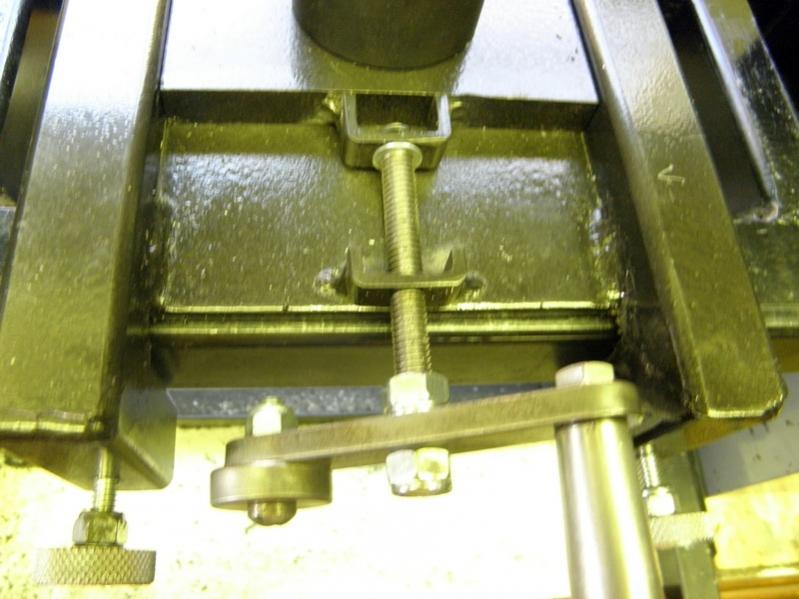

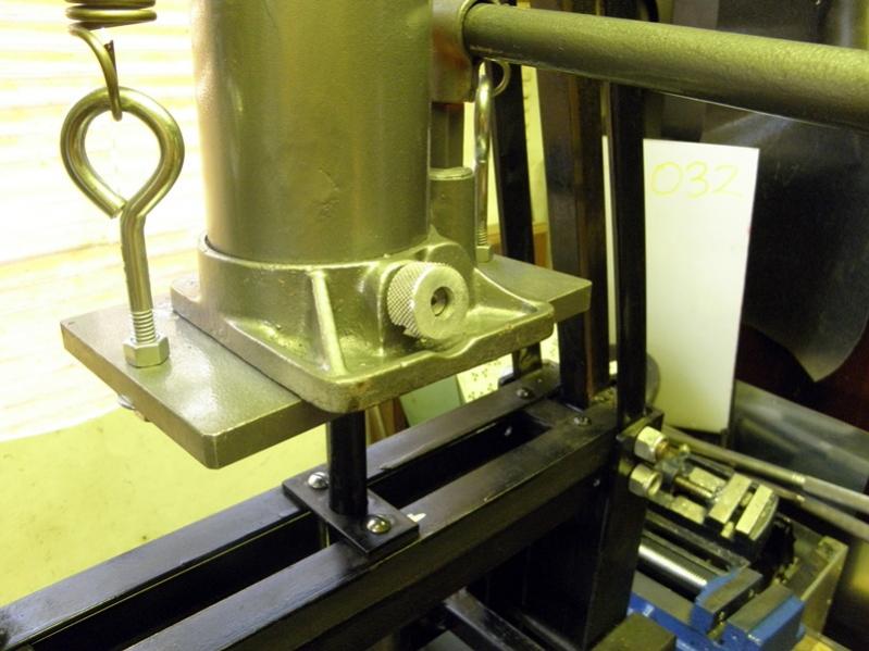

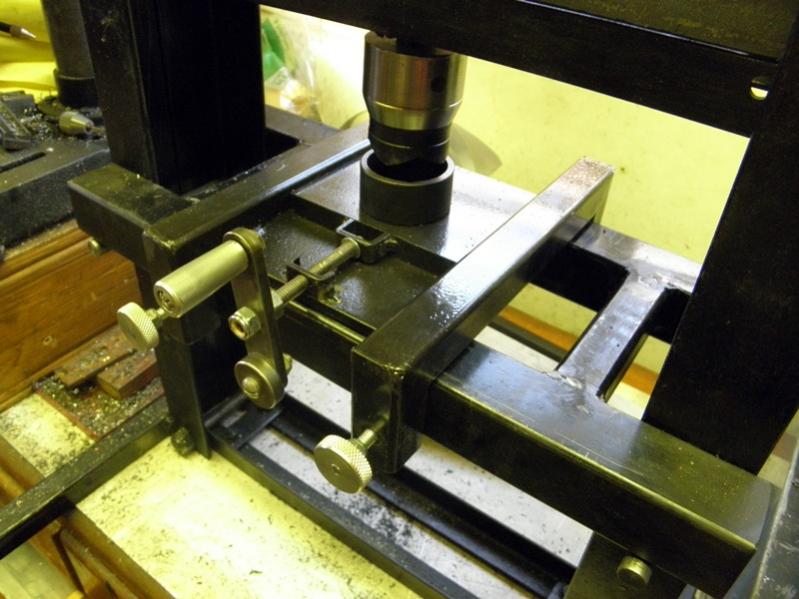

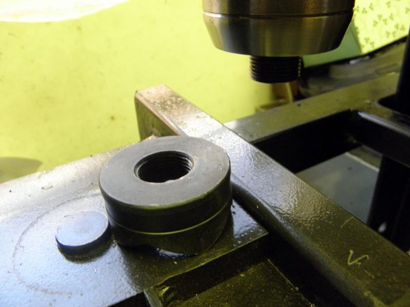

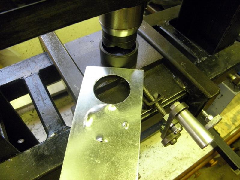

    This attachment slides on the horizontal shop press bar, and has a slider for the forward and backward movement. the slider is made up of 1/2 inch crs with a 3/4 hole drilled in the middle for a dowel that sticks up
    1/8 of an inch for the bottom die to rest in. The upper die is threaded into the ram rod.
    All that is left to do is to center the bottom die with the upper die now you can cut your hole in the sheet metal.
    I made sure my ram rod is square to the punch or bad things will happen.

    Nice, what's your rating on capacity?

    I'm using a 12 ton jack for this shop press.

    I'm sorry, I should have been more clear. What thickness of material do you think you can punch with the setup?
    Jul 2014
    San DIEGO, California
    1,097
    496
    Captainleeward's Tools
    The sheet metal I used was .035 thick. The dies can't take much more than that.

    Hi, well done captain !
    The dies are purchased ?

    Yes they are Christophe, Wow you climbed up the ladder fast can"t catch you any more...
