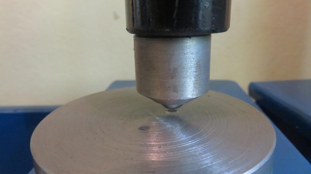

    The idea here is to use a regular shop press plus a bearing ball to conduct a Brinell test.
    My goal is identify unknown steels and relate brinell hardness with ultimate strenght.
    There is a formula witch relate load, ball diameter and indentation to material hardness:
    https://me-mechanicalengineering.com...hardness-test/

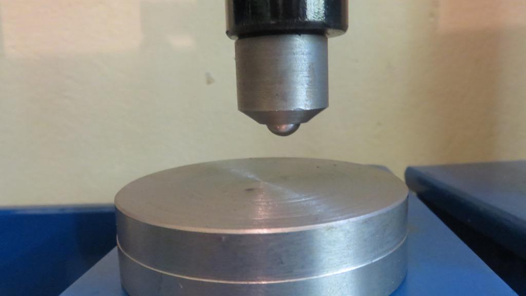

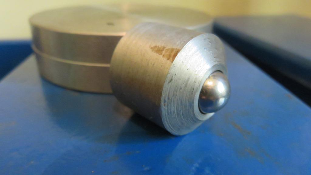

    I Made the "holder" for 10mm (3/8") ball. The holder let only 3mm (1/8") of the ball exposed.
    For sure the holder is a must if you doesn't want to brinell test your press ram.

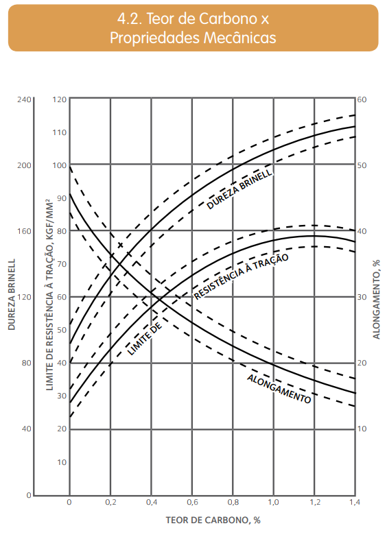

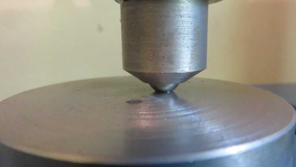

    Tested some 1020, 1045, A36, SCH80 and AL 6061 I have at scrap bin.
    Problems found:
    * My readings ended being a bit off expected numbers. Had a tough time taking precise measurements with a paquimeter. I Had read that there is a dedicated microscopes for this....maybe a good photo and convert pixel to mm....this will be my next try.
    * Not know the shop press manometer error. Need a way to check it.
    Hazards: At 3tons, there much risk of ball bearing exploding? Use safety glasses!

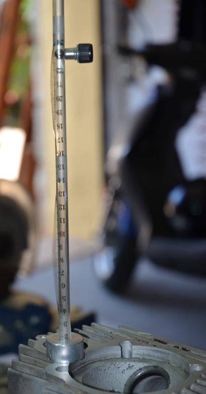

    There is a simpler test method which is perhaps better suited to DIY manufacture. Known as a Scleroscope and its modern derivative the Leeb hardness tester. These are rebound testers. Basically you drop a ball or other type of "hammer" from a know height and measure how far it rebounds. The Leeb uses modern methods of measuring drop and rebound velocities. Some copper coil wire and an Arduino could easily take care of the measuring. I made a basic scleroscope using a glass tube, down which I drop a 6 mm ball bearing, I have a scale on the side so that I can measure the rebound height.
    Here is a pic. of mine. I hold the ball up with an external magnet which I pull away to release the ball and then I note the rebound height. Not super sophisticated but simple to make and it works well. I sometimes think about replacing the magnet with an electromagnet and making a velocity transducer to measure drop and rebound velocities, but other tasks put that down the priority table.

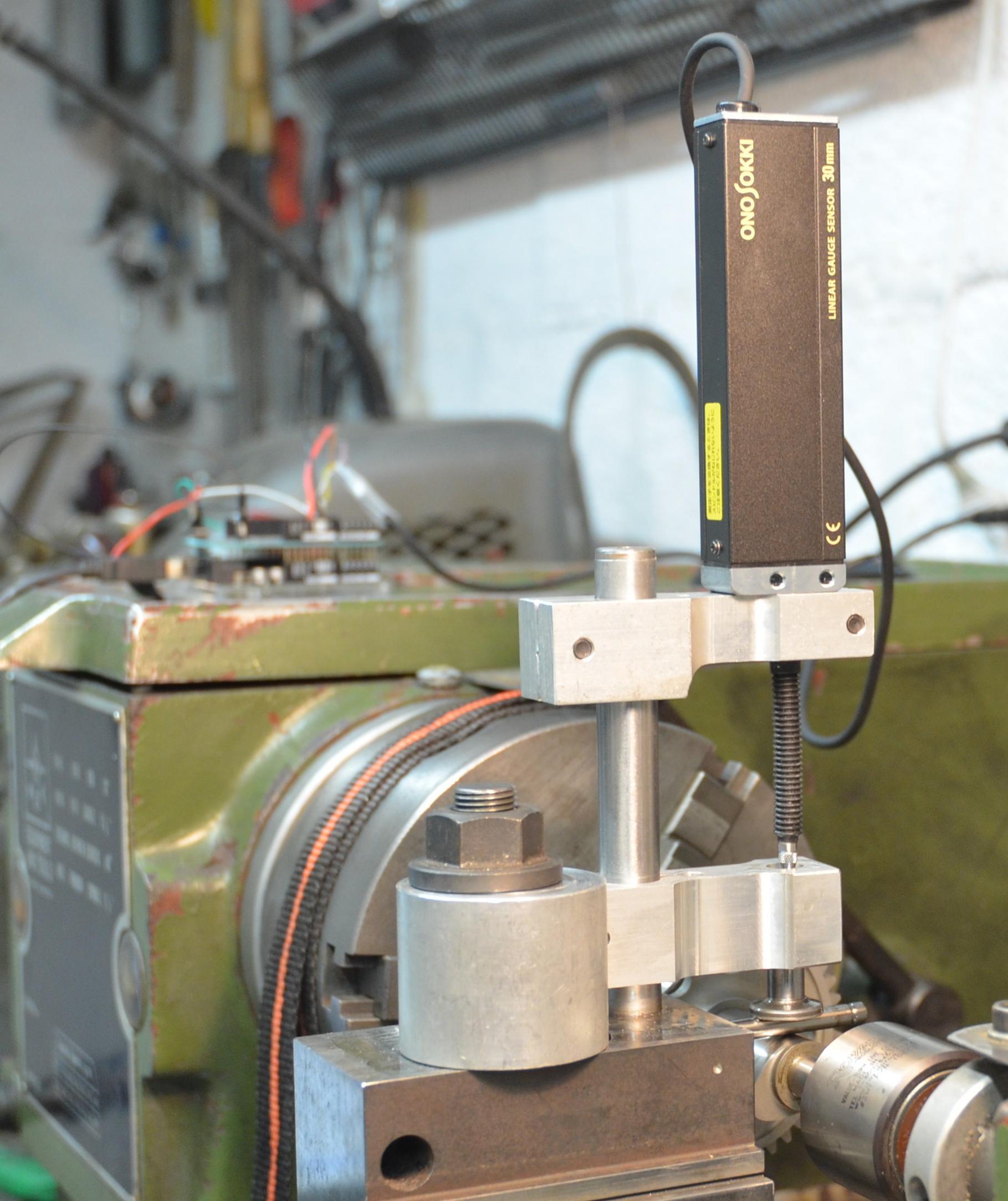

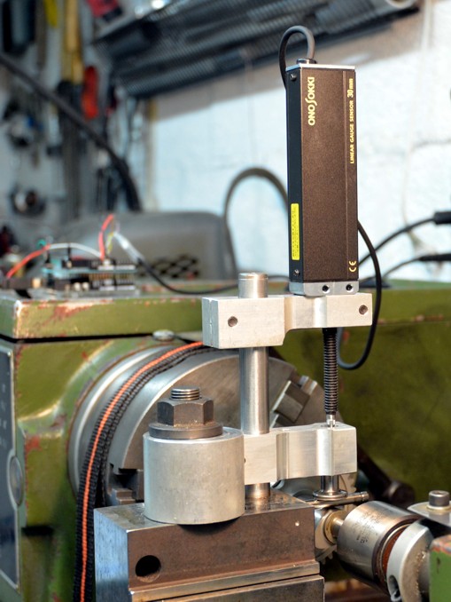

    I am just about to build a heat treatment oven and in line with the sentiment expressed here: http://www.homemadetools.net/forum/n...ilosophy-64856 , I had been thinking about how to improve my hardness measurements. I was mentally oscillating between buying a chinese Leeb tester and adding some magnets, copper, Arduino and software to make my bouncing ball device more like a Leeb. However since you started this thread my thoughts have drifted towards making a Rockwell device, in fact this afternoon I ordered some indenters. I have a 1 micron linear encoder so I have the means to measure penetration accurately.
