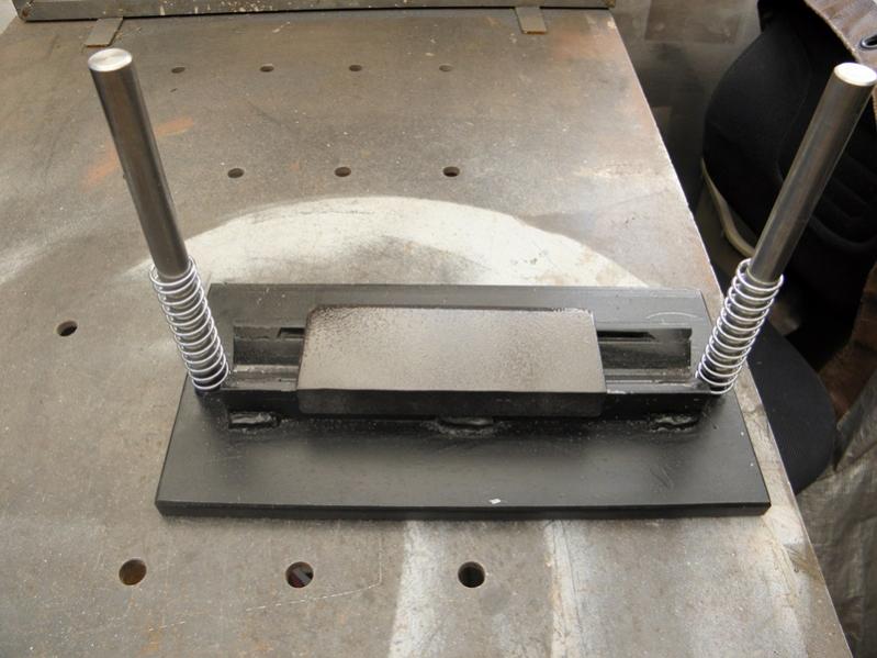

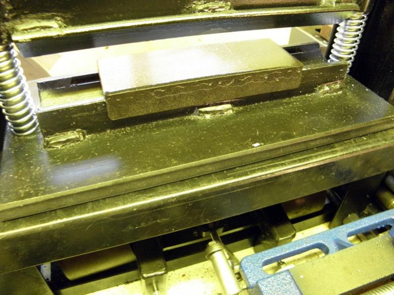

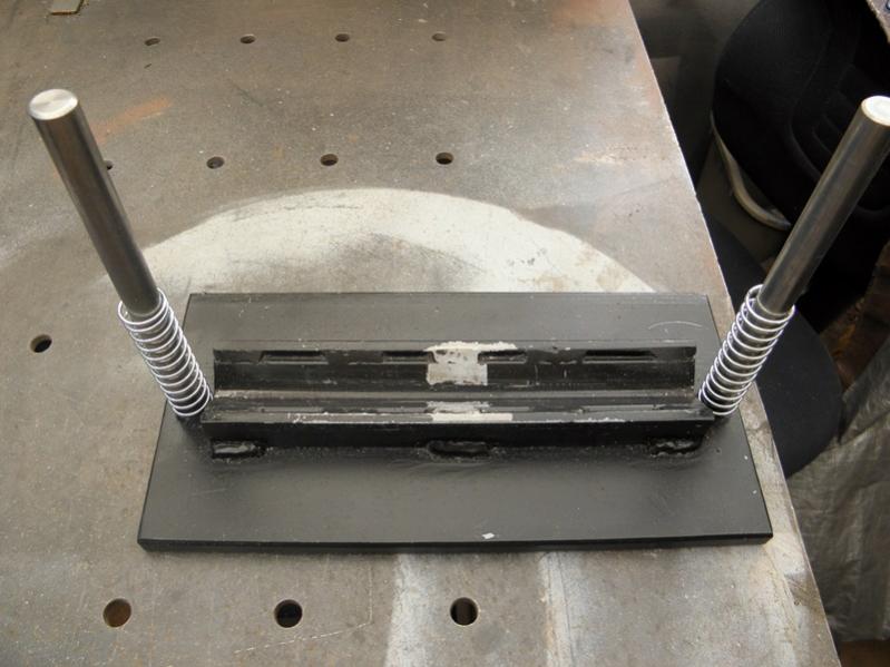

    Shop press -- Base plate Fixture
    Shop press -- Base plate Fixture, by removing the top anvil and add a foot to the ram rod, then add the base plate over the lower anvil, I can use the brake base plate as part of a normal press.
    I won't have to make an additional base for normal pressing operations.
