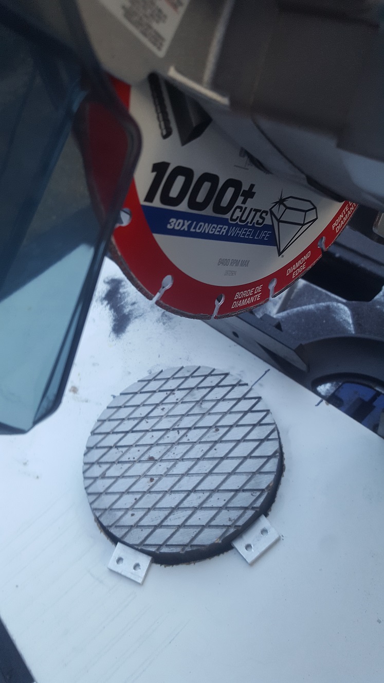

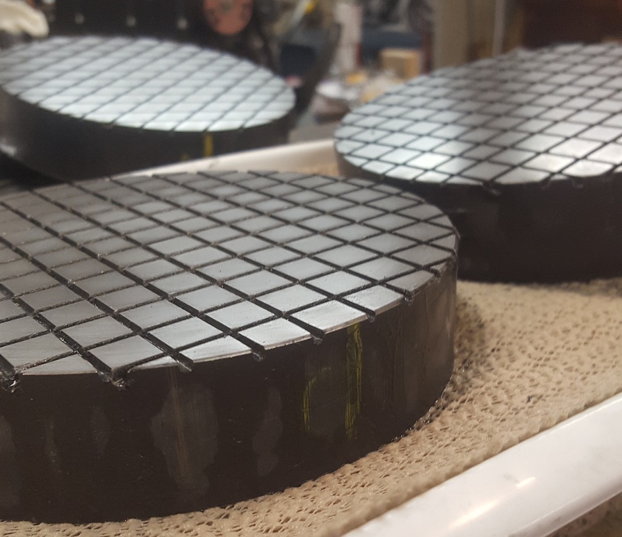

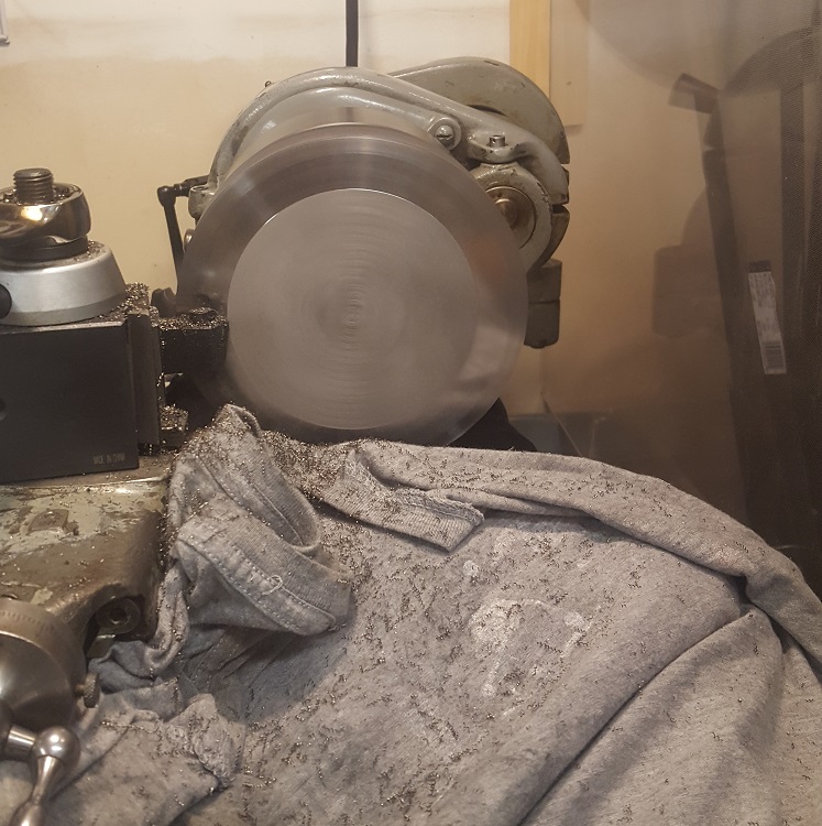

    Some time back, I was inspired to make a set of (3) lapping blocks, using 6" diameter cast iron rounds purchased from McMaster-Carr. I first faced them off on the lathe, then cut grooves using my sliding miter saw and a diamond blade. Following that came hours and hours of lapping each of the three blocks (labeled A, B and C) against each other. I didn't reach total optical flatness, but the results were good enough to use for general purposes. I now have three lapping plates that I can re-cut and re-surface whenever needed, just by rubbing them together in the proper sequence.

    It wasn't difficult, just a bit tedious with a lot of repetition during the lapping process.

    I saw youtube where the person lapped an iron flat against surface stone, using diamond grit powder
    did you use any grit?

    Quote Originally Posted by satx View Post
    Sounds to me like the method used to flatten a granite surface plate, but yes I did (more than one actually). You can use common valve grinding compound to start, and then move to finer grits once the plates show good flatness. I think I started with Timesaver #111 (green can), then moved to finer grits from there. Tom Lipton has a good set of videos on YouTube. He's also the one who encouraged me to make a set. The idea of using a sliding miter saw to cut the grooves was my small contribution to the effort...
    Hope this helps.
