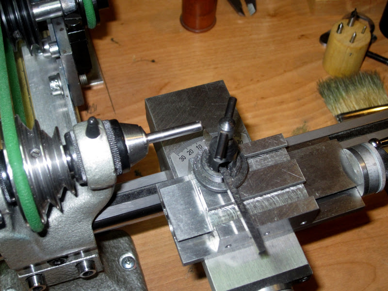

    I like working with O1 and W1 tool steel, but any good tool steel or high carbon steel that you can heat treat yourself will work just fine. Here, I'm starting with some O1 drill rod chucked into the tiny lathe:

    I start by turning the major diameter and the point taper. The angle of the point taper is completely up to you, the wider the angle, the less cutting force should be required but on the other hand they would have more of a tendency to wander. I tend to make my points a pretty narrow angle, as you can see here, and haven't had issues with chatter or breakage:

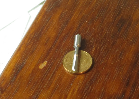

    File until there is just the faintest trace of the blue guide left:
    Even for fairly large size bits, there is such a small amount of metal to be removed, that the filing really does go quickly.

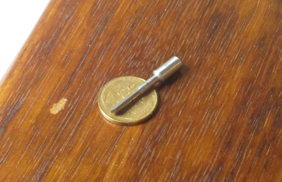

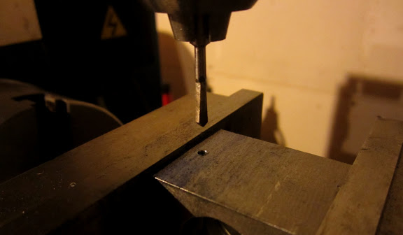

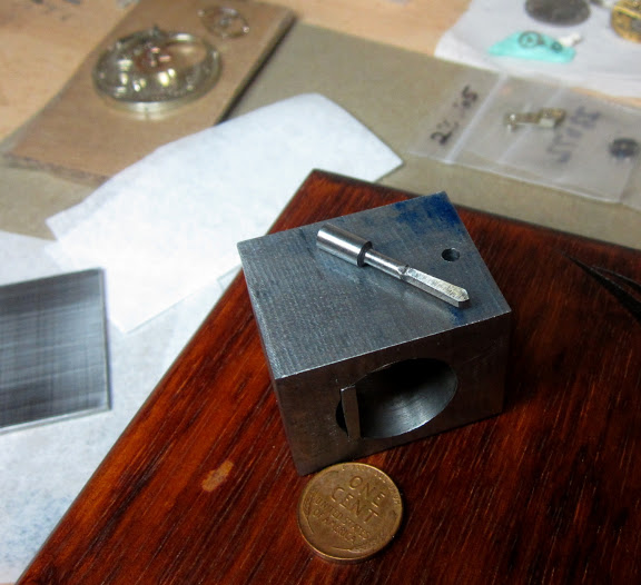

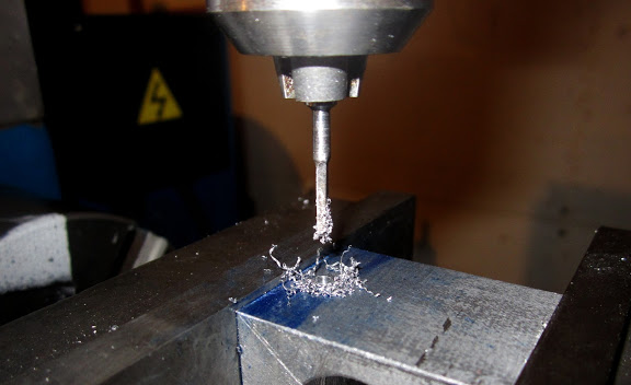

    Here is my completed bit, about to start opening up a pilot hole:
    And here is the result:
    As you can see, it makes a nice tidy hole.
