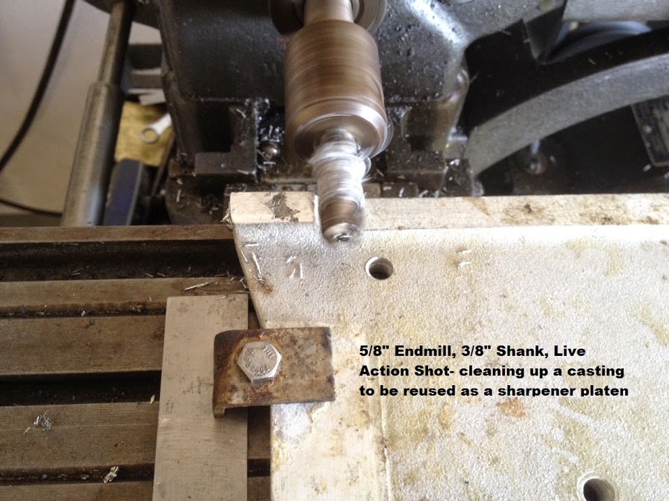

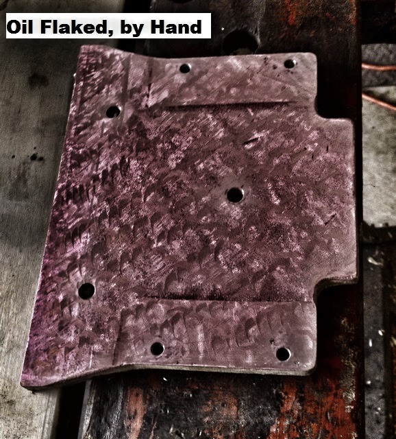

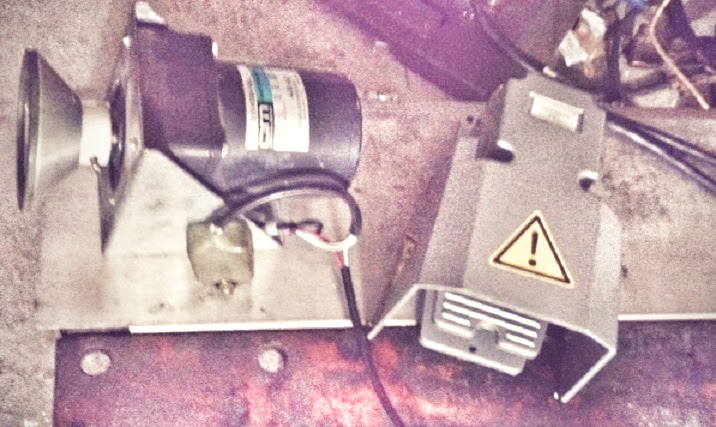

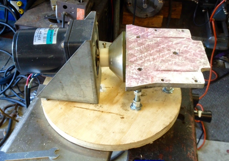

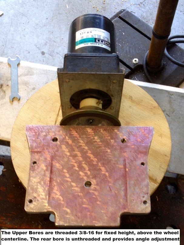

    i made a diamond tool sharpener for sharpening carbide metal scraper blades and biax carbide blades.
    Shop Made Diamond Tool Sharpener-altas%25u00252bat%25u00252bwork%25u00252b2.jpg
    it turns at approximately 280 rpm.
    the wheel is 75% concentration diamond 600 grit, 3" diameter.
    i use a few shots of windex to cool the carbide during sharpening operations.
    the platen is flat and level, the motor is tilted 3* and is adjustable.
    thanks for reading

    Mike, where did you source/salvage the motor?

    Quote Originally Posted by Toller View Post
    Hi Toller,
    the motor was salvaged from a food industry label applicator.
    it is approximately 6:1 final gear reduction, 1740 rpm(before output reduction), 115v motor.
    just about any fractional horsepower motor could be used with a little forethought.
    the slower the better, but 250-17XX rpm would be a good range.
    a motor in the 17XX rpm range could be employed with success, but heat will be a factor and additional cooling may be a prerequisite for long sharpening cycles.

    Mike,
    Why are you running it so slow? Is it because you are using it manually or was it a case of that is what the motor does?
    All the CBN and diamond wheels like that in my experience are rated at several thousand rpm, depending on diameter. I run my T&C grinder at 3 to 4000 rpm
