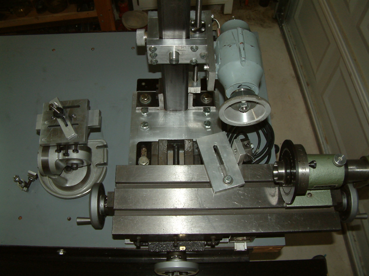

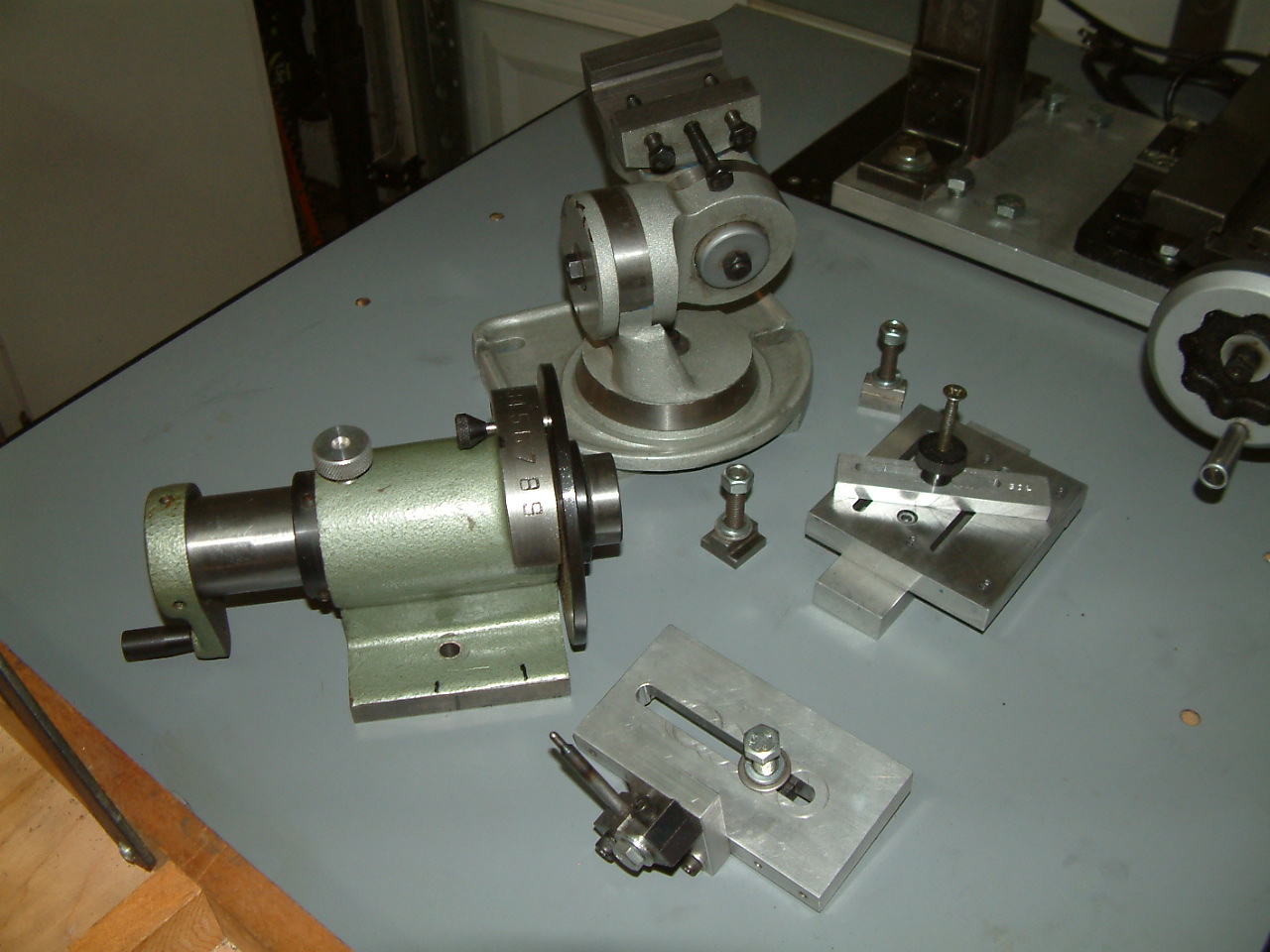

    I have good results with end mills. The ends are easy. The flutes are another thing. Hard to get a smooth run
    with the setup I am using with the spin indexer. Results are acceptable for home shop but an air bearing would be better.
    Cheers, JR
    JR,
    I have only been here for about a month and I have only just seen this. I recently posted my T&C machine based on a small mill. There are many similarities between the two. We obviously think along similar lines.
    If you have a look at my post you will see how easy it can be to modify the Spindexer to use an air bearing. It makes doing the flutes much easier.

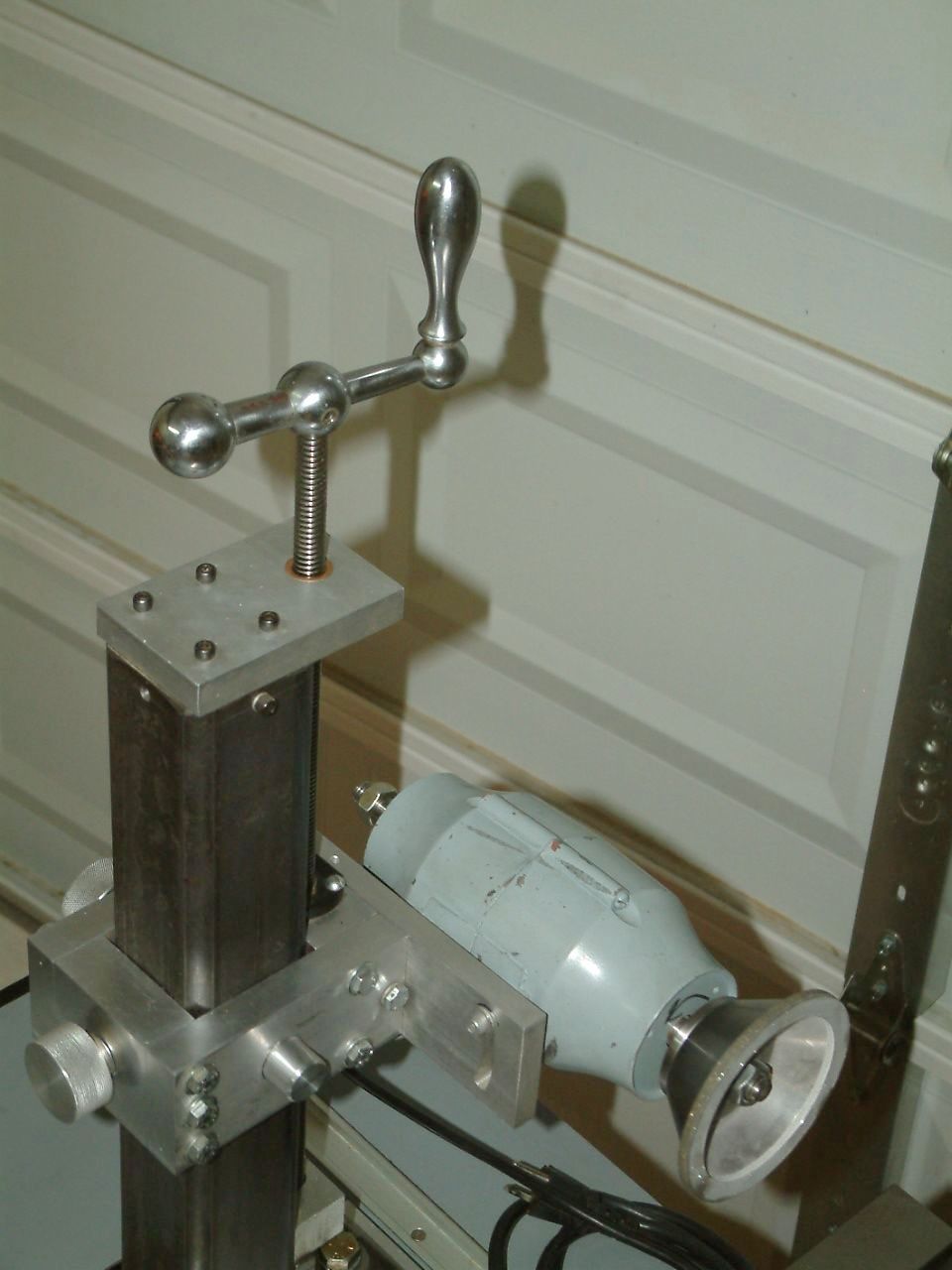

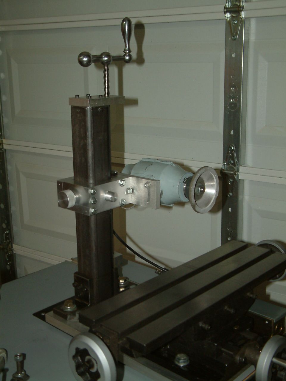

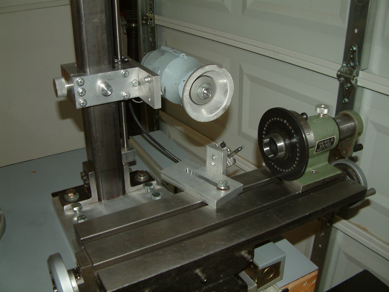

  6. #16
    5,338
    7,048
    Quote Originally Posted by jjr2001 View Post
    I have good results with end mills. The ends are easy. The flutes are another thing. Results are acceptable for home shop but an air bearing would be better.
    One need is a fine feed on the carriage. The 1/2-10 lead screw is much too coarse. Cheers, JR
    Most would vote air bearing. Need be, a longer spindle in the spin-dex and an air fitting through the body has been done. Adapting a set of linear guides carrying a collet might be a solution too.
    Far as the stop screw goes; I'd keep the ACME and attach a clamp on stop, with Marv Klotz's differential screw and the potential of any increments you desire.

  8. #17
    Jun 2016
    945
    1,191
    Thanked 2,134 Times in 570 Posts
    jjr2001's Tools
    Thanks Tony, I like your spin indexer to air bearing indexer conversion and your T&C grinder. Looks like I might try it on mine. I can see how that would be much a smoother action when grinding the flutes.
    Cheers, JR
  9. #18
    Jun 2016
    945
    1,191
    jjr2001's Tools

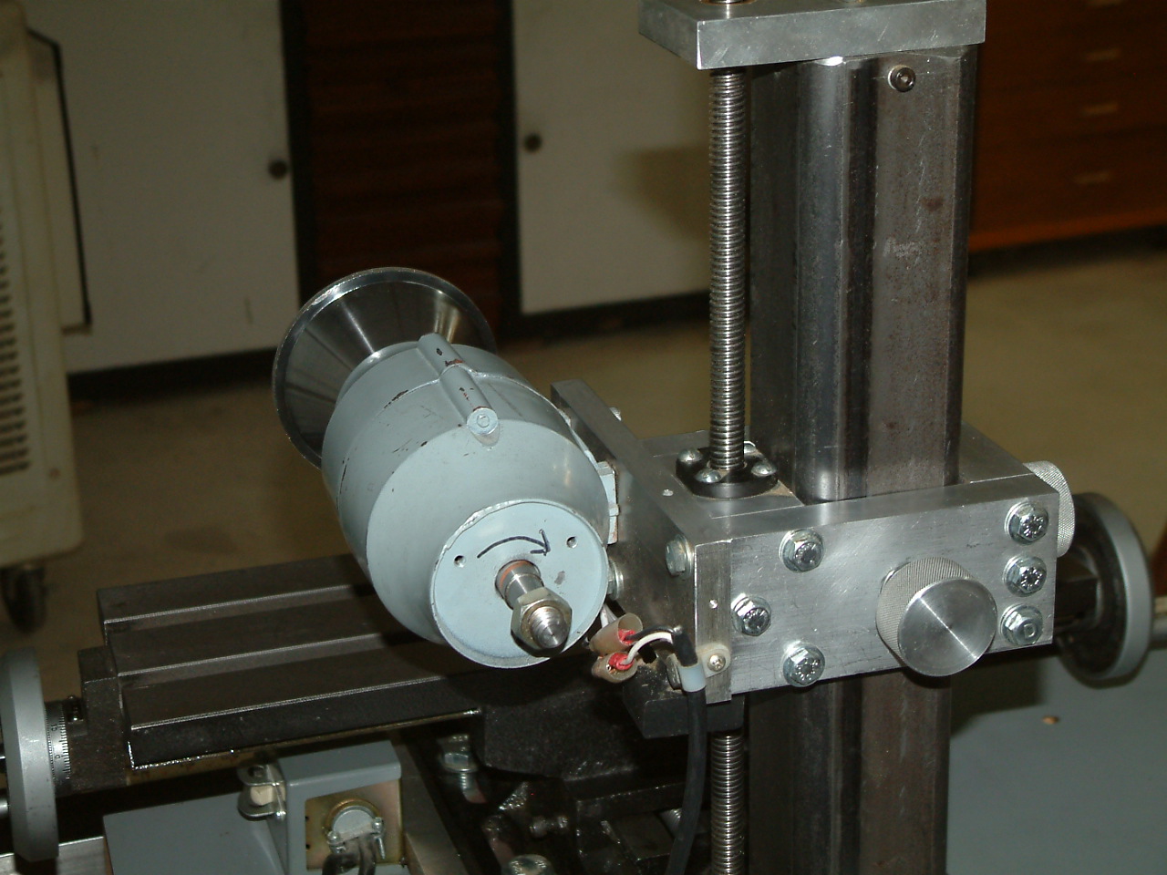

    Thanks TM51,
    I actually have the fine feed stop already on the grinder. See post:http://www.homemadetools.net/forum/u...0461#post72517
    I kept the 1/2-10 lead screw and just lower the grinder to the adjustable stop (fine feed) and I have about .100 inch of travel. It can resolve better than .0005". Works pretty good so far.
    Cheers, JR

  11. #19
    Oct 2012
    354
    23
    Thanked 181 Times in 126 Posts
    JJR

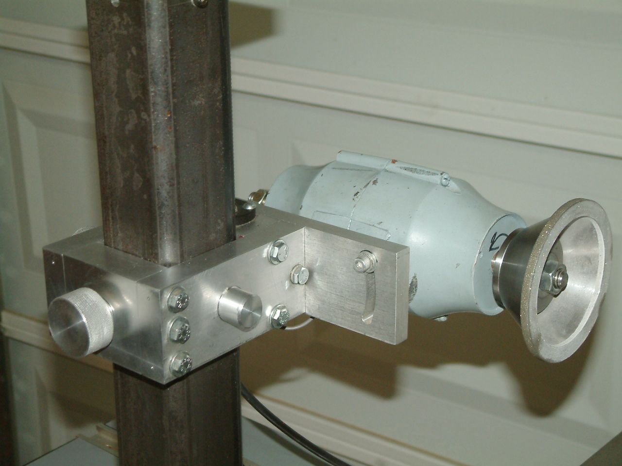

    What you could do to improve your grinder is take the long screw out and install a lever handle to push and pull the table rapidly from under the revolving wheel.
    Very nice design, good luck and be very careful because when a wheel comes apart they move like shrapnel from a bomb.
    Nelson

  13. #20
    Jun 2016
    945
    1,191
    jjr2001's Tools
    Thanks collar, I do have a guard for grinding wheels but it is not shown in the pictures.
    Of course it the wheel frags I doubt the guard will contain it!
    Safety glasses are a must when grinding but even with all the safety gear
    a grinding wheel blowing up is bad news. Never had it happen and I
    hope I never experience that.
    Cheers, JR
