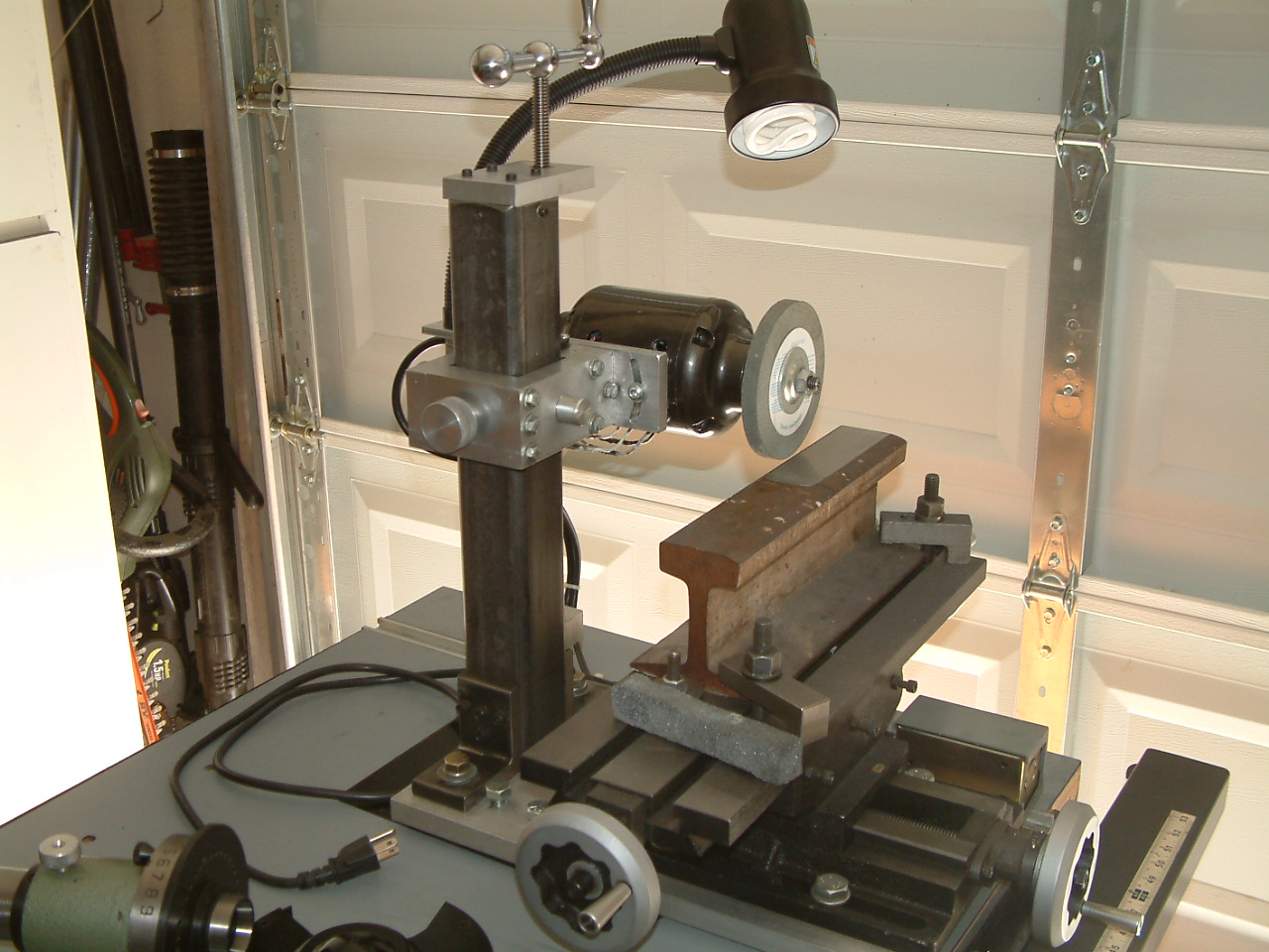

    I had this XY table for the past 30 years and only used it on the drill press.
    But then I purchased a small mill and no longer needed the table.
    Well now that I have a mill I needed to sharpen some cutters.
    Works well for Lathe tool bits as well.
    The column is just a hunk of heavy steel tubing. Riding on that is the mount for the grinder.
    That would be all aluminum except for the 1/2-10 Acme Lead Screw. Used for positioning the
    height of the grinder which is then locked by the two rather large knurled aluminum lock bolts.
    The XY table has variable positioning so it may be located for various setups. The column may be relocated
    to several fixed positions. Right now the grinder seems a little under powered. I am going to replace the grinder with a larger model and see if I can get enough power for some surface grinding. That should make this a very useful tool in the shop.
    So far it has been used for lathe tool bits and end mill sharpening.
    Several accessories are shown which include a multi angle fixture that can hold just about any tool at almost
    any angle. It's main use if for lathe tool bits.
    The spin indexer along with the shop made index pointer is used for end mills. With the index pointer it can sharpen the flutes as well as the ends.
    I will post the new motor and report on how well it can be used for a simple surface grinder.

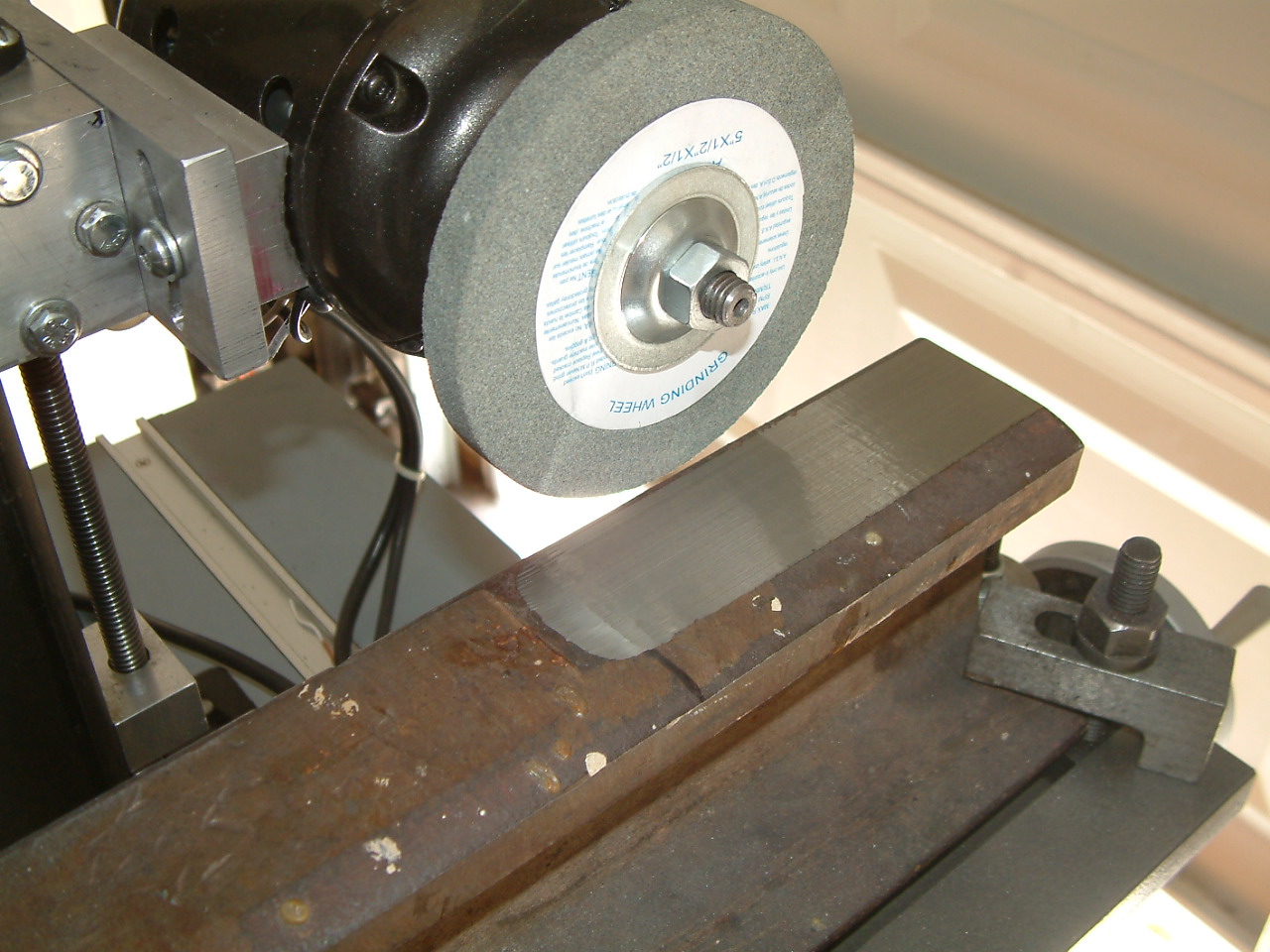

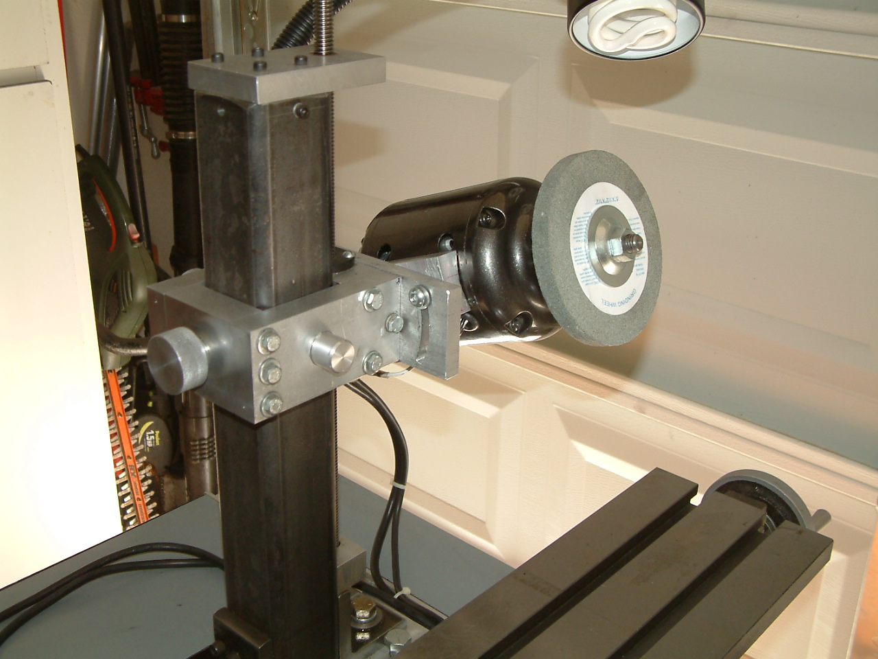

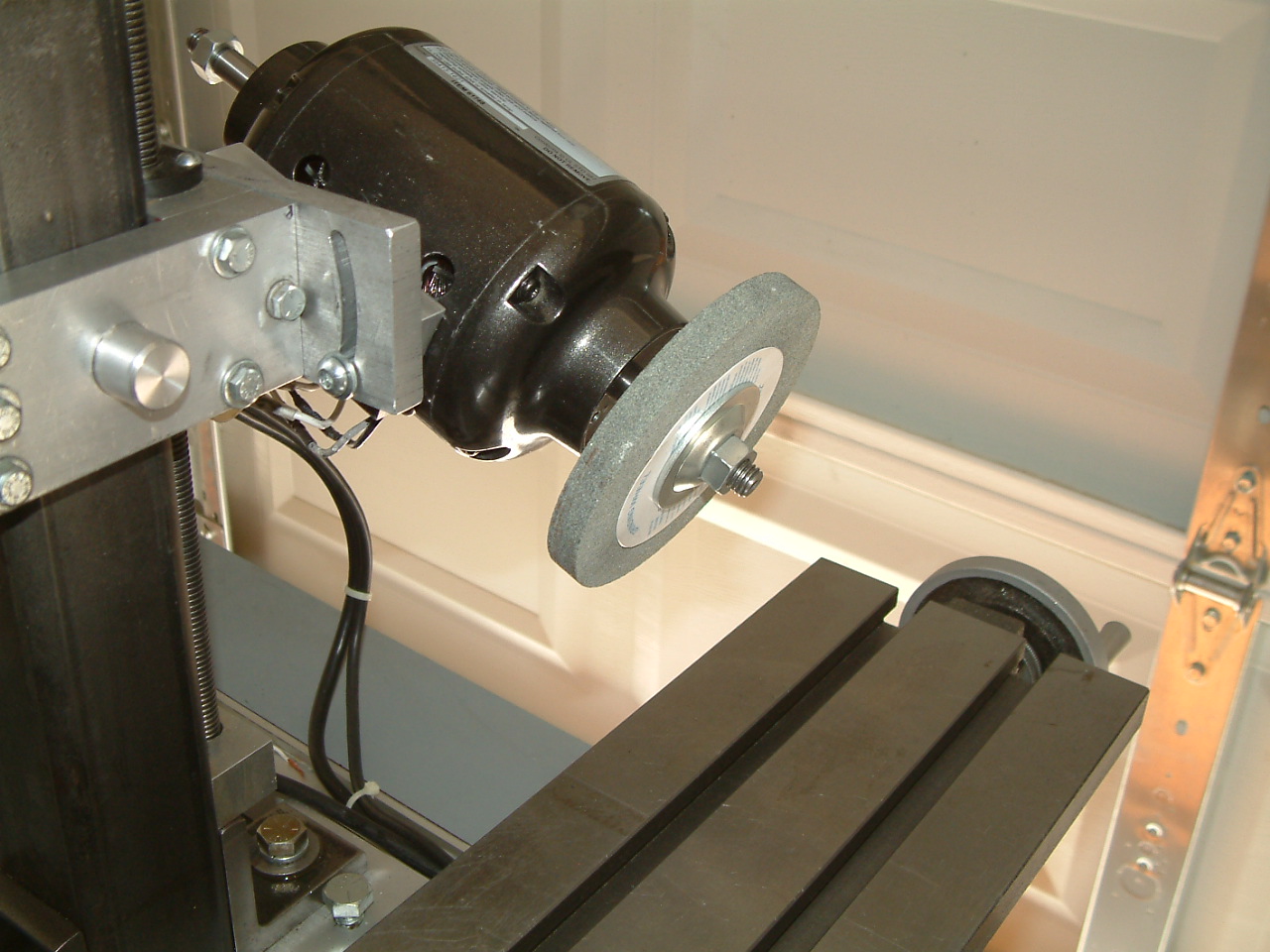

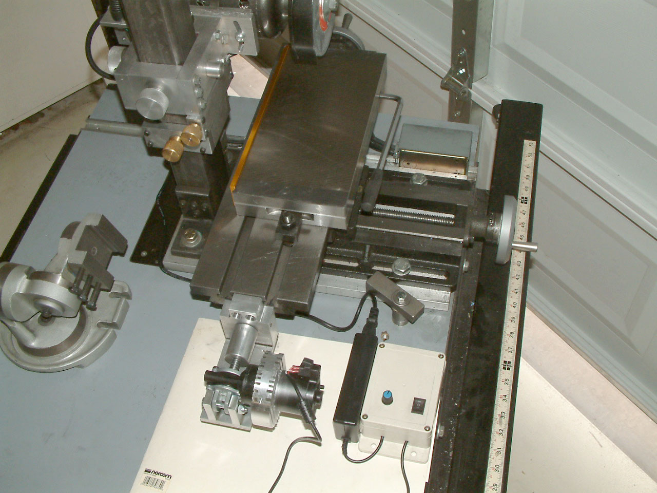

    I have good results with end mills. The ends are easy. The flutes are another thing. Hard to get a smooth run
    with the setup I am using with the spin indexer. Results are acceptable for home shop but an air bearing would be better.
    Put the new motor on today and what a difference. Both were rated at 1/3 hp but the first one (gray) was less than 1/4 hp. I tried a bit of surface grinding on an old rail road track cut off that I use for an anvil. Worked pretty fair. Not as smooth as I would have liked but it is flat. I will mainly be using it for flats on shafts or putting a flat on a cylinder etc. Should be useful for grinding any hard steel tools or parts.
    Still need to retry lathe tool bits with the new motor. Can't wait.
    Have a couple of end mills that could use some sharpening too.
    The new motor mount moves the motor back 1" and allows more tilt. Up to 20 degrees up or down.
    One need is a fine feed on the carriage. The 1/2-10 lead screw is much too coarse. I will add a fine feed in addition to the lead screw since I want to keep the fast speed to raise and lower the motor during any major setup changes.
    A few pics of the new motor and mount:
    Cheers, JR

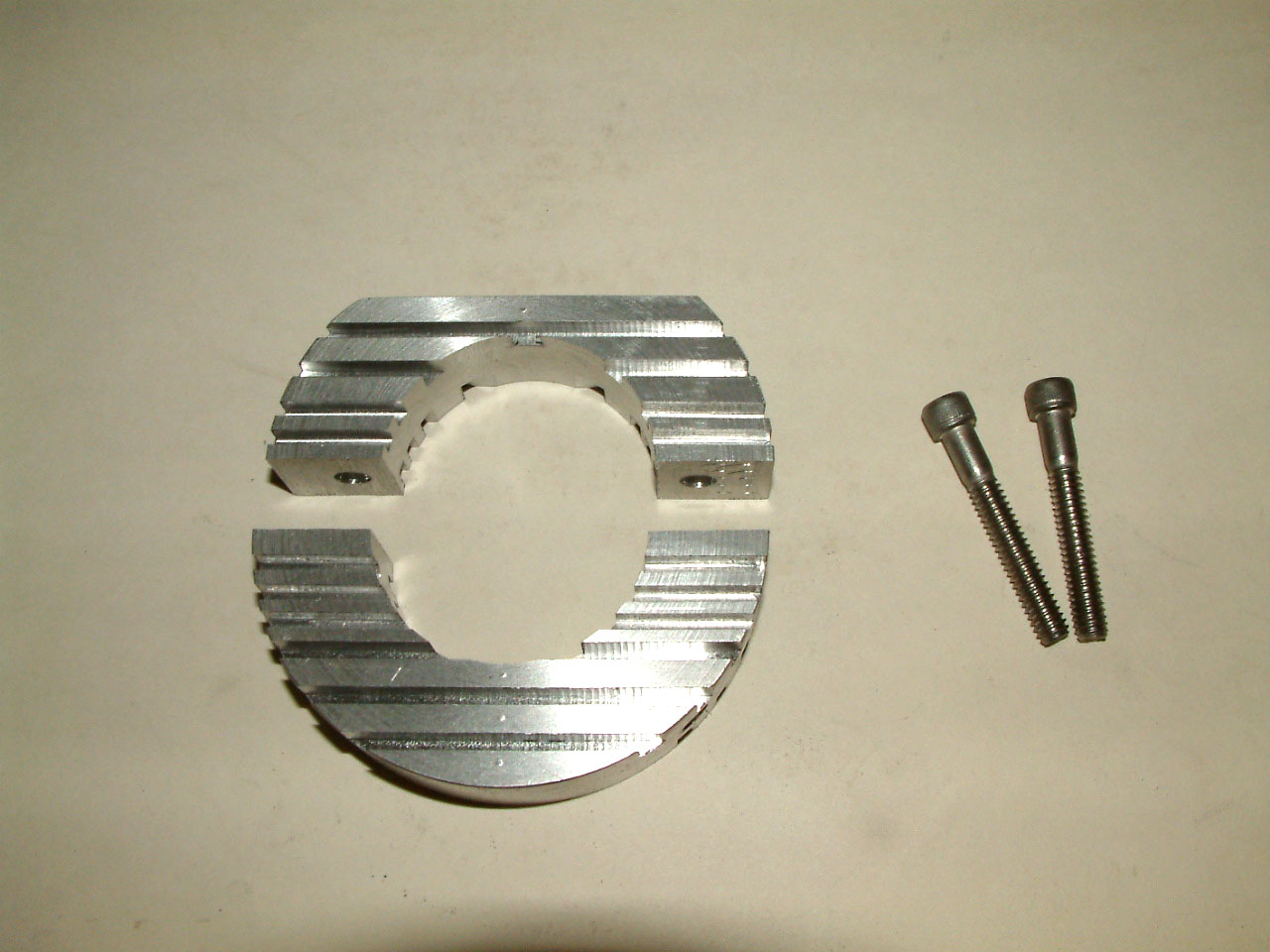

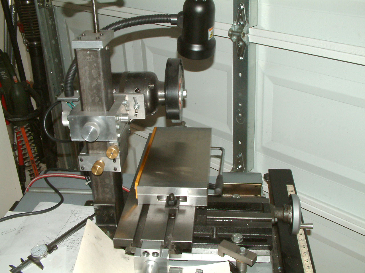

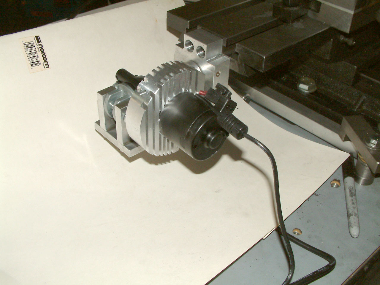

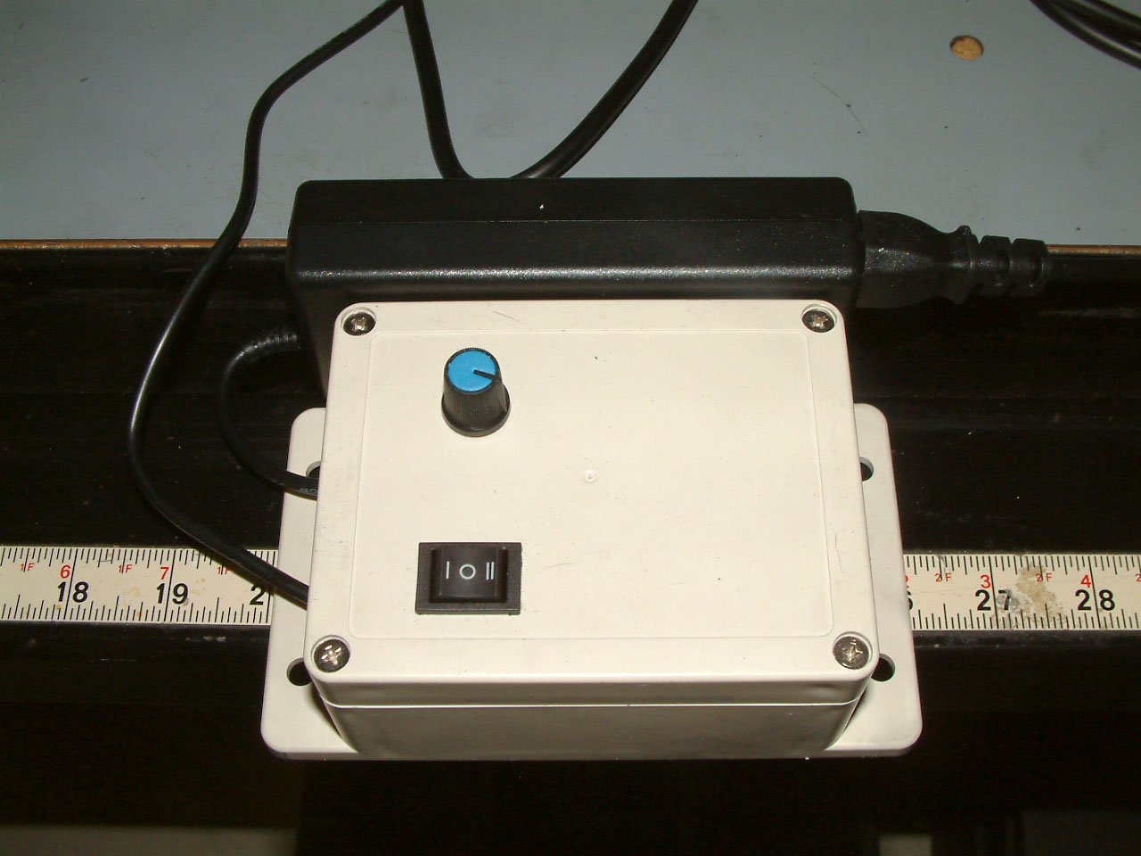

    Upgrades Magnetic Chuck and Power Feed Heat Sink
    First I received my magnetic chuck and was ready to check it out with my power feed. The motor is just a car seat actuator and not intended for continuous use. Hot it was. Hotter than the one on my mill and I suppose that is due to the constant use while surface grinding. So, we made a bit of a heat sink from the scrap pile. Should do the job. The portable control box is shown in one of the pictures. The more I use it the more I wonder how I would do without it.
    Cheers, JR
