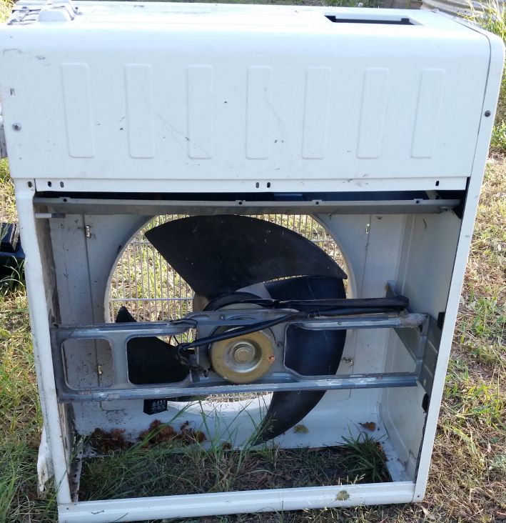

    Darn that is smart. I just happen to have scrapped an air conditioner and have spent the last hour stripping it as I think that may work for the case and fan with a little tampering - and take two sets of filters simultaneously. I will download the specs on the filters and explore further then it hopefully just depends on ending the lockdown so I can get parts. At 76 I am in no hurry. Or maybe the squirrel cage from inside the house will work with a LOT of modification. I guess I better find out how loud it is too.
