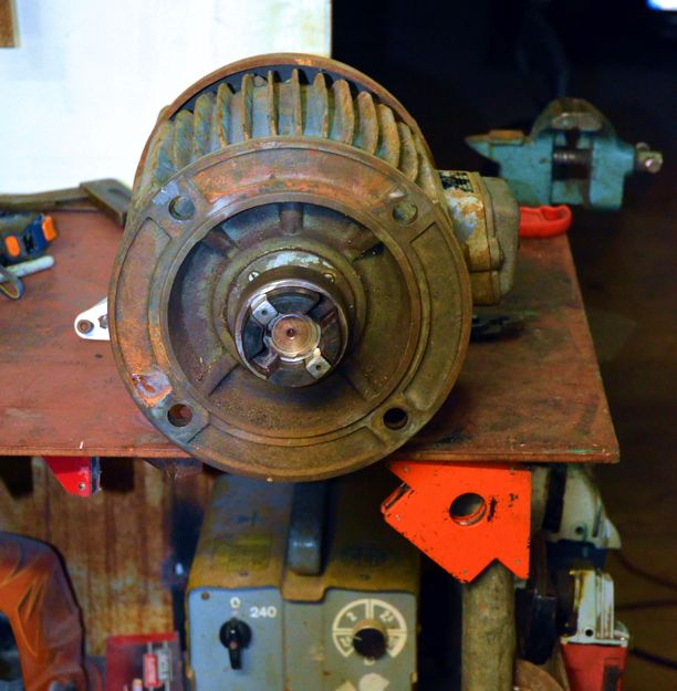

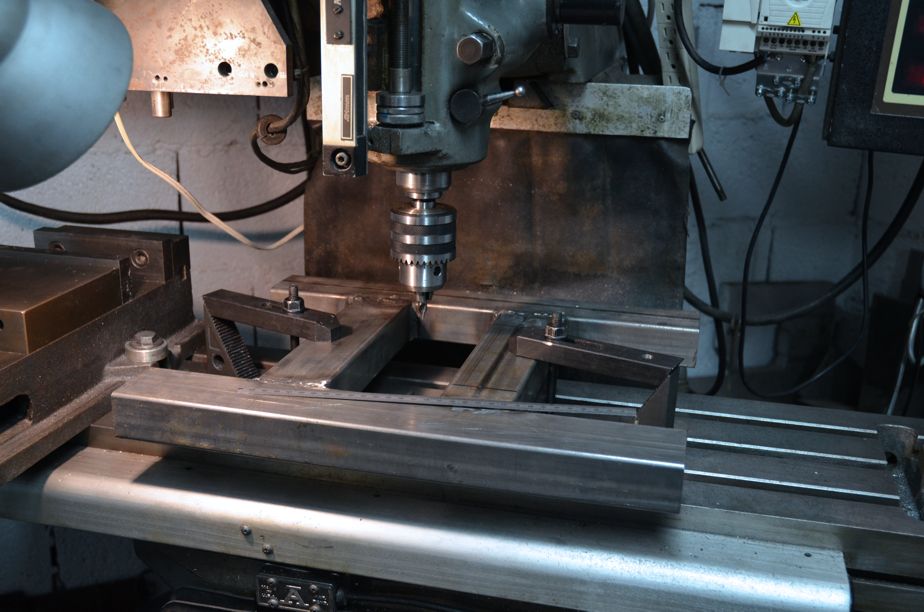

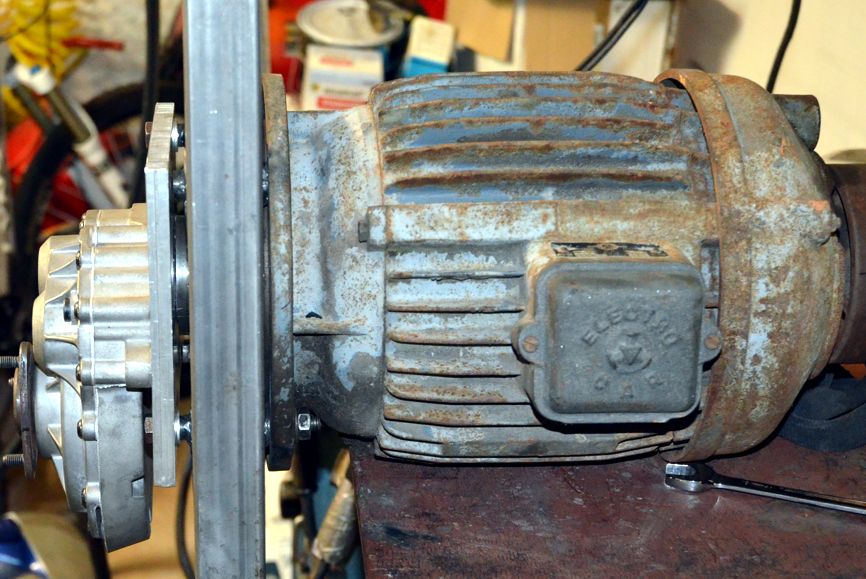

    On the left is a 5 hp 3 ph motor which I kept from an old lathe which I had earmarked to power the machine. It was a flange mounting motor, I'd have preferred a base mounted type for ease of fitting. The start of the motor mounting is shown on the right being setup for making the holes for the mounting bosses.
    Shock dyno (or Shock absorber dynamometer)-shockdyno_03.jpg Shock dyno (or Shock absorber dynamometer)-shockdyno_04.jpg

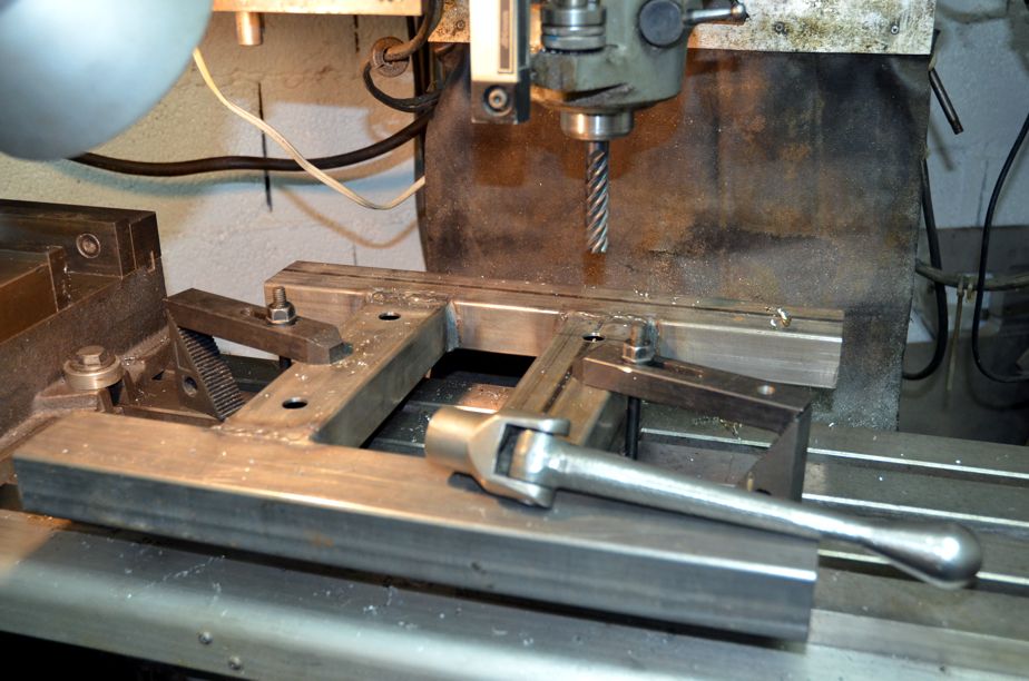

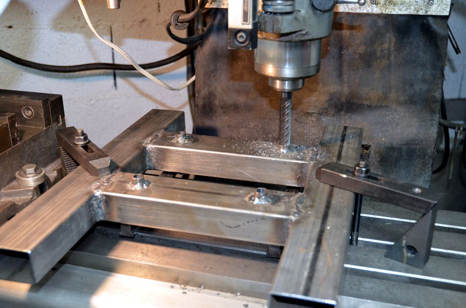

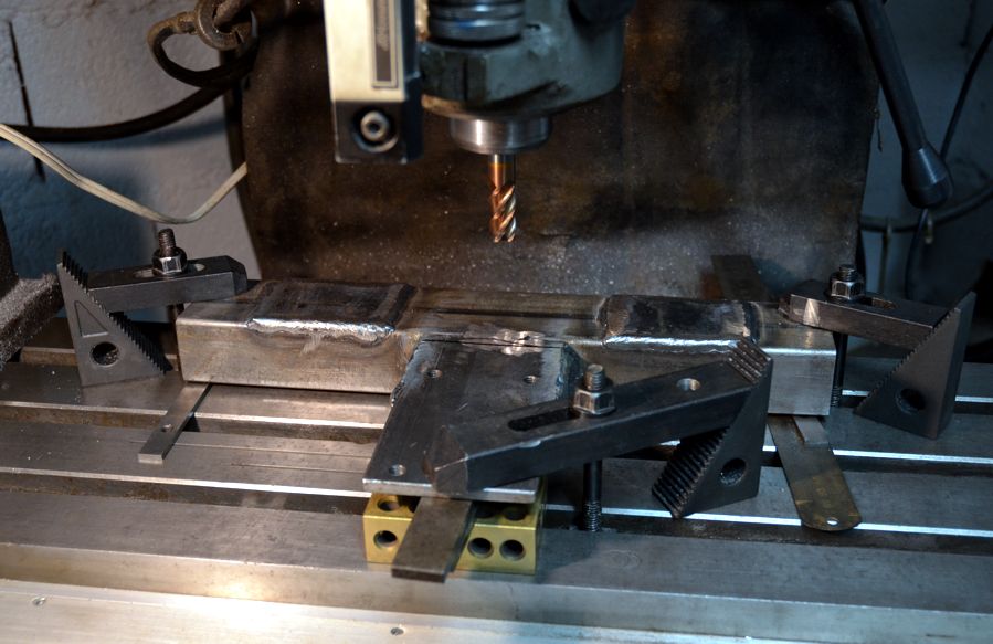

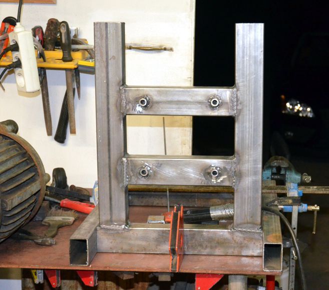

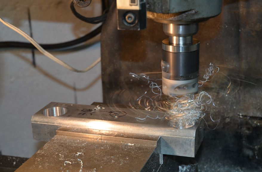

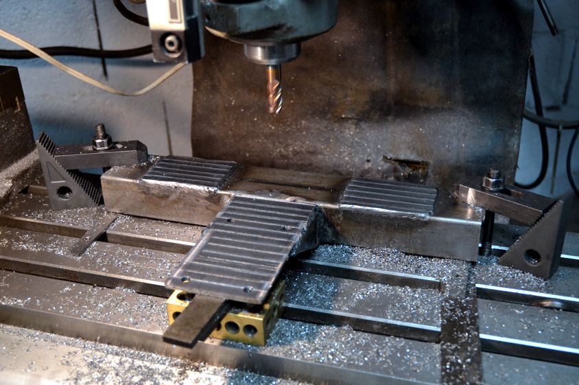

    Preparing holes for the mounting bosses and then machining the bosses level.
    Shock dyno (or Shock absorber dynamometer)-shockdyno_09.jpg Shock dyno (or Shock absorber dynamometer)-shockdyno_10.jpg

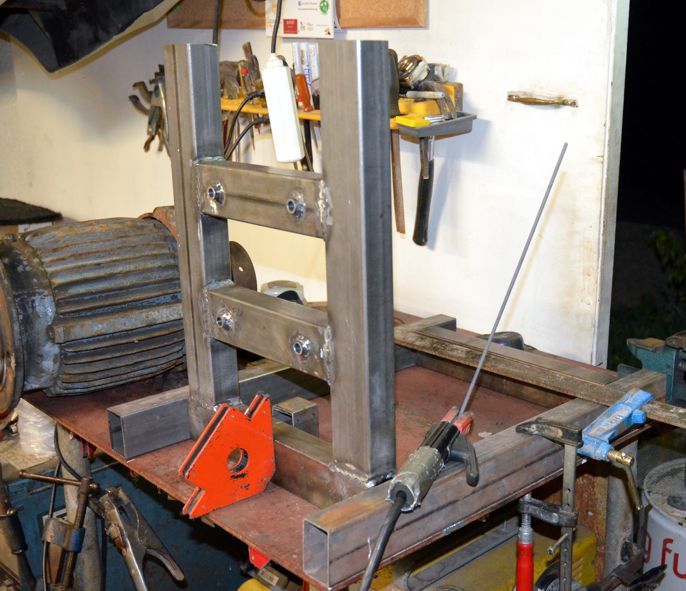

    Attaching the motor mounting sub-frame to the base frame.

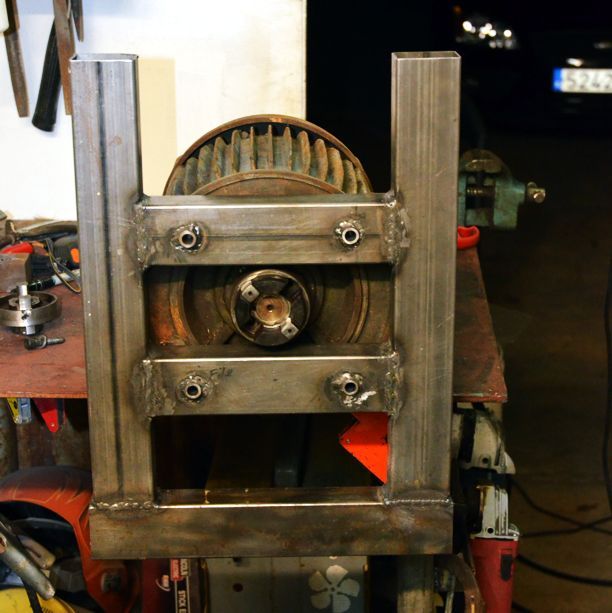

    Shock dyno (or Shock absorber dynamometer)-shockdyno_05.jpg Shock dyno (or Shock absorber dynamometer)-shockdyno_06.jpg

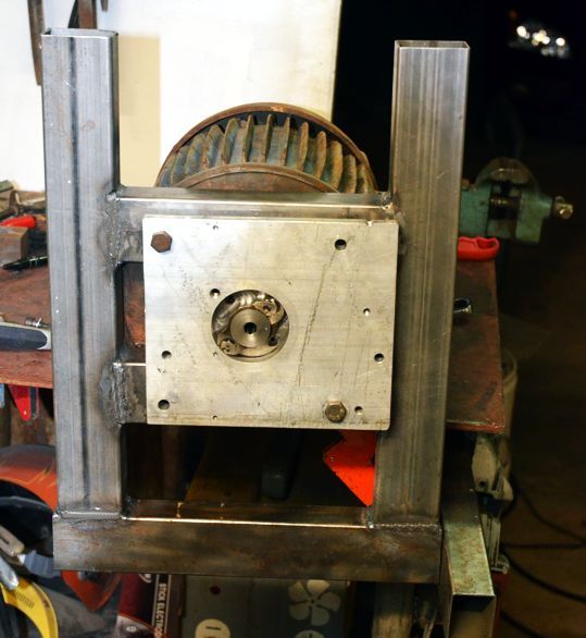

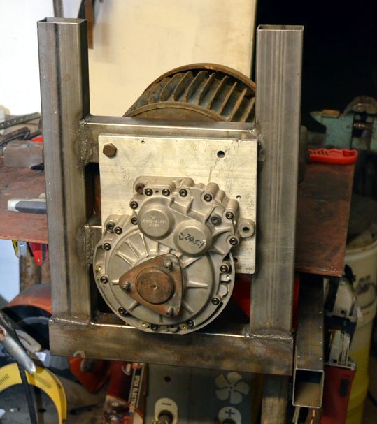

    Here we have the motor mounting frame welded to the base, and also the mounting plate for a reduction gearbox.
    Shock dyno (or Shock absorber dynamometer)-shockdyno_07.jpg Shock dyno (or Shock absorber dynamometer)-shockdyno_08.jpg

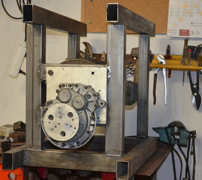

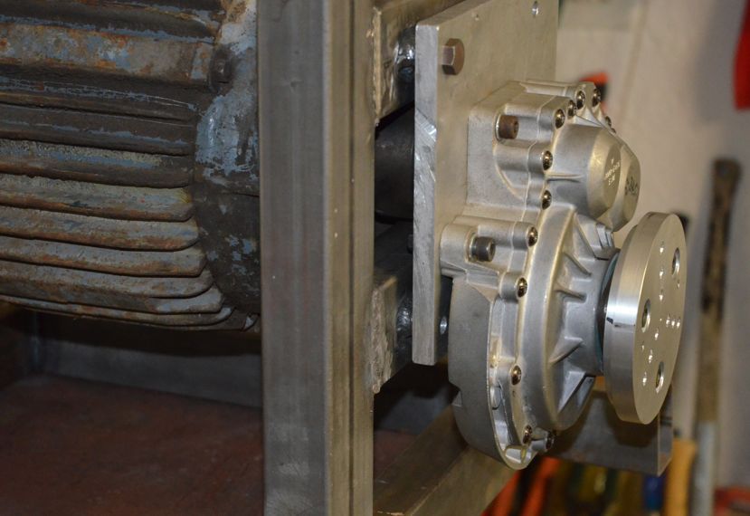

    Showing both motor and 25:1 reduction gearbox mounted to the part completed frame.
    Shock dyno (or Shock absorber dynamometer)-shockdyno_13.jpg Shock dyno (or Shock absorber dynamometer)-shockdyno_14.jpg

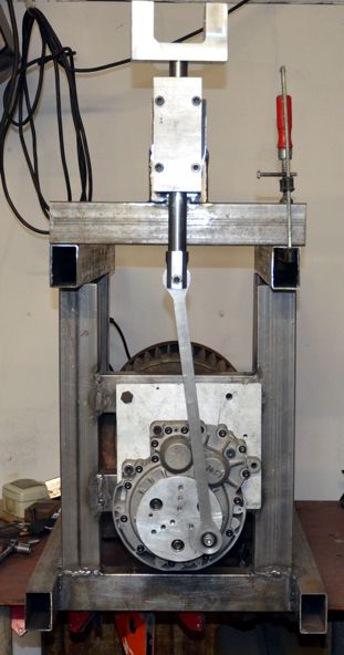

    A couple of views showing the crank plate fitted to the gearbox output shaft. The tapped holes allow different maximum strokes of the shock.

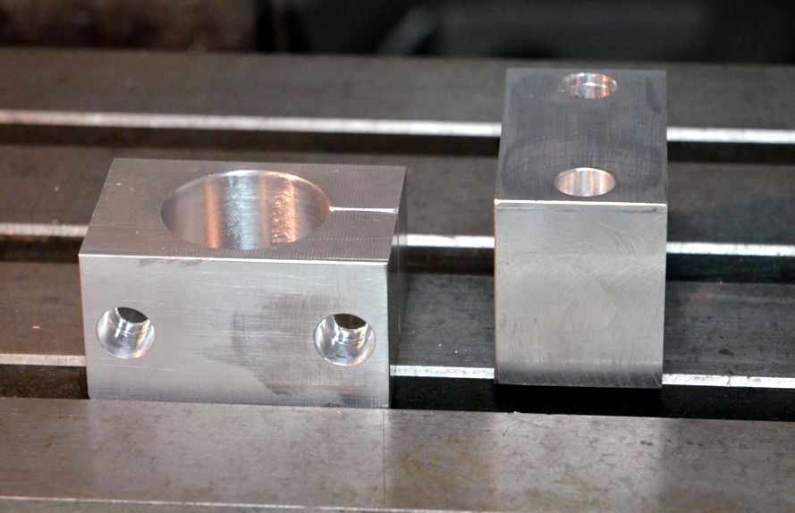

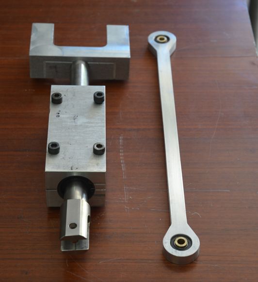

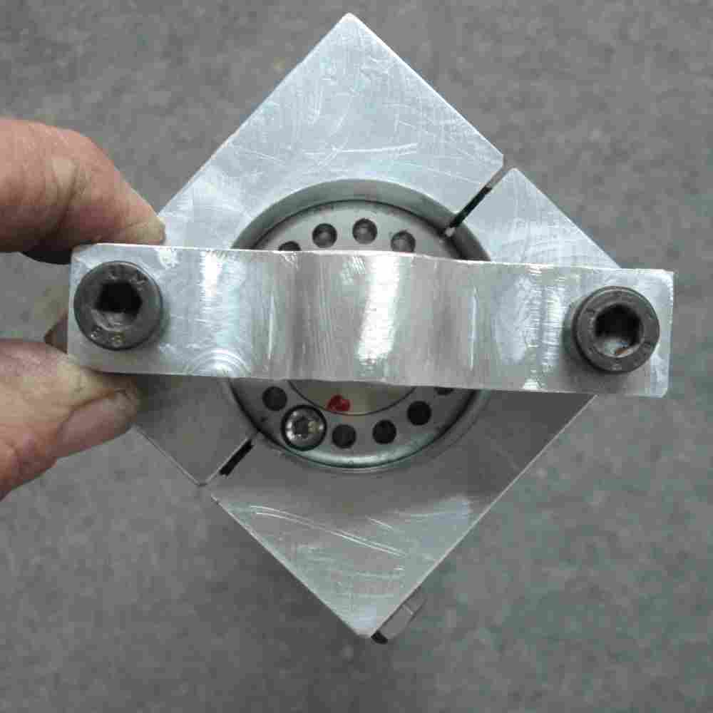

    On the left is the slider block and conrod. I had some 1" ID linear ball races so I got a length of 1" Thompson shaft and made an aluminium housings for the bearings. The shaft moves very smoothly with a high degree of rigidity. The yoke at the top is for mounting a shock or fork slider. The second photo shows a trial mockup of the assembly.
    Shock dyno (or Shock absorber dynamometer)-shockdyno_17.jpg Shock dyno (or Shock absorber dynamometer)-shockdyno_18.jpg Shock dyno (or Shock absorber dynamometer)-shockdyno_19.jpg

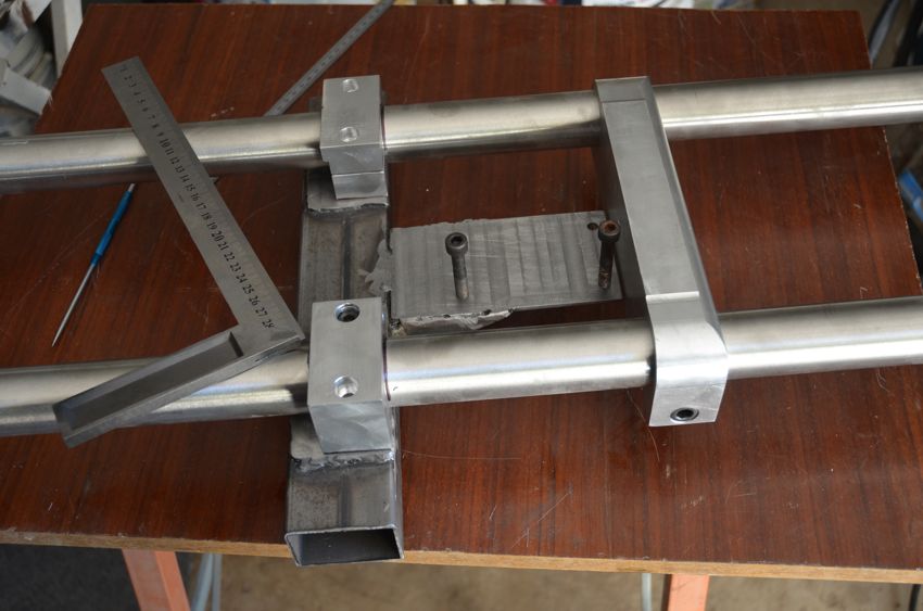

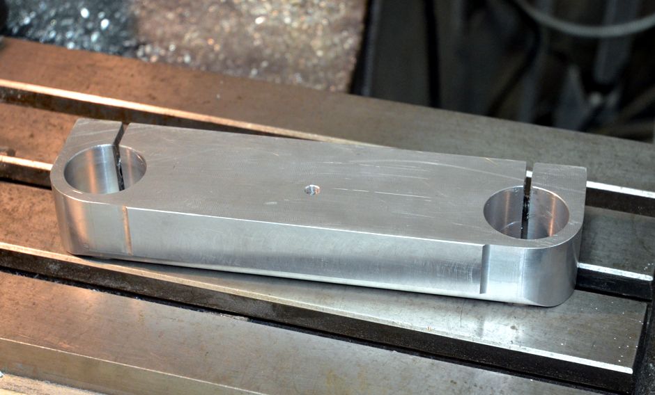

    Making the top support bracket for the two uprights. Below are the two fixed lower mountings.
    Shock dyno (or Shock absorber dynamometer)-shockdyno_20.jpg Shock dyno (or Shock absorber dynamometer)-shockdyno_21.jpg
    The sub assembly for mounting the bearing block and mountings for the uprights.

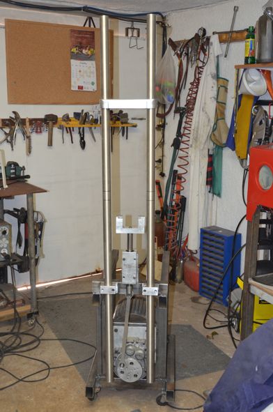

    Testing alignment prior to welding of sub-assembly.

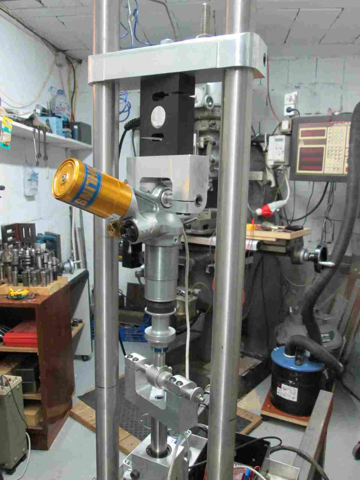

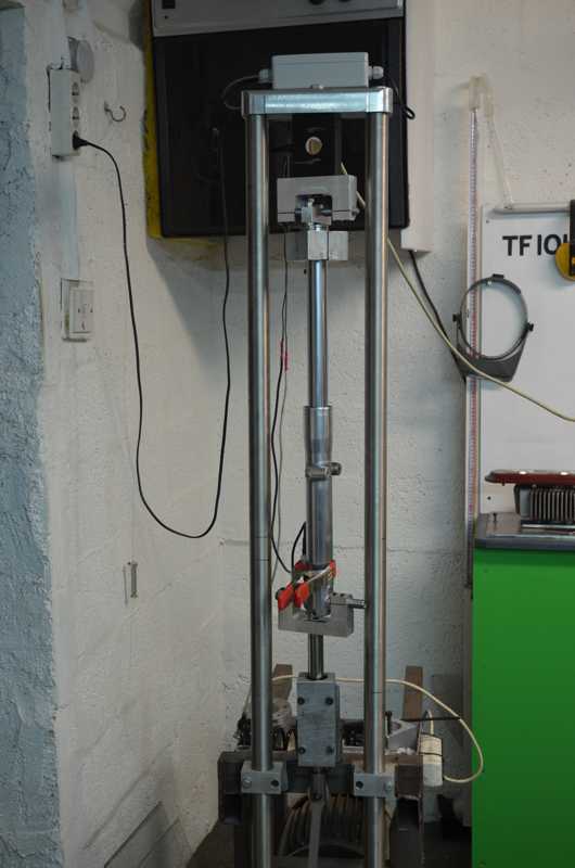

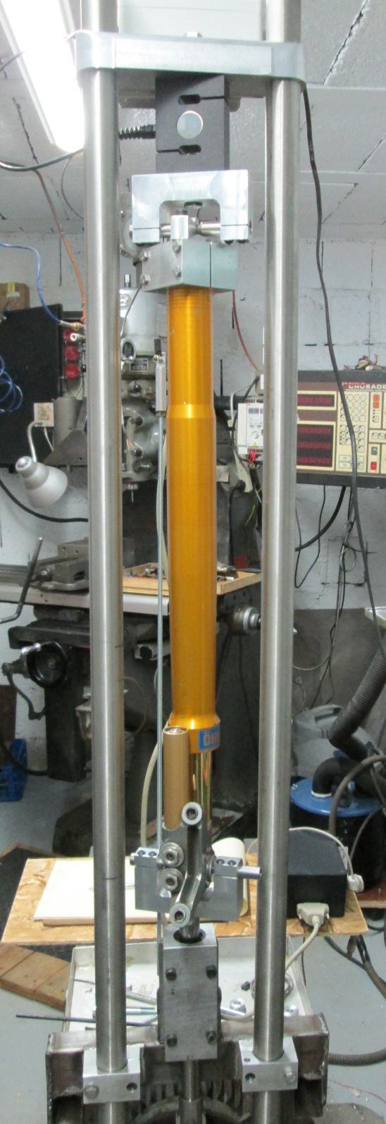

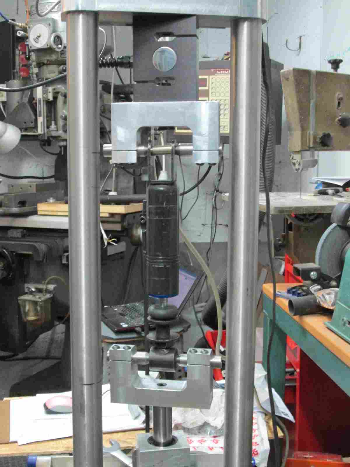

    Nearly finished, it just needs the load cell for measuring force, the string pot for measuring displacement and the top shock mounting yoke.
    Examples of shocks on test
    Shock dyno (or Shock absorber dynamometer)-marzocchiondyno.jpg Shock dyno (or Shock absorber dynamometer)-ohlinsfork.jpg
    On the left is an old Marzocchi fork for classic racing and on the right is a modern Ohlins race fork. Note the load cell and upper mounting yoke.

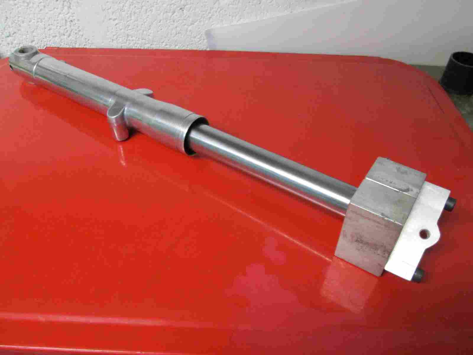

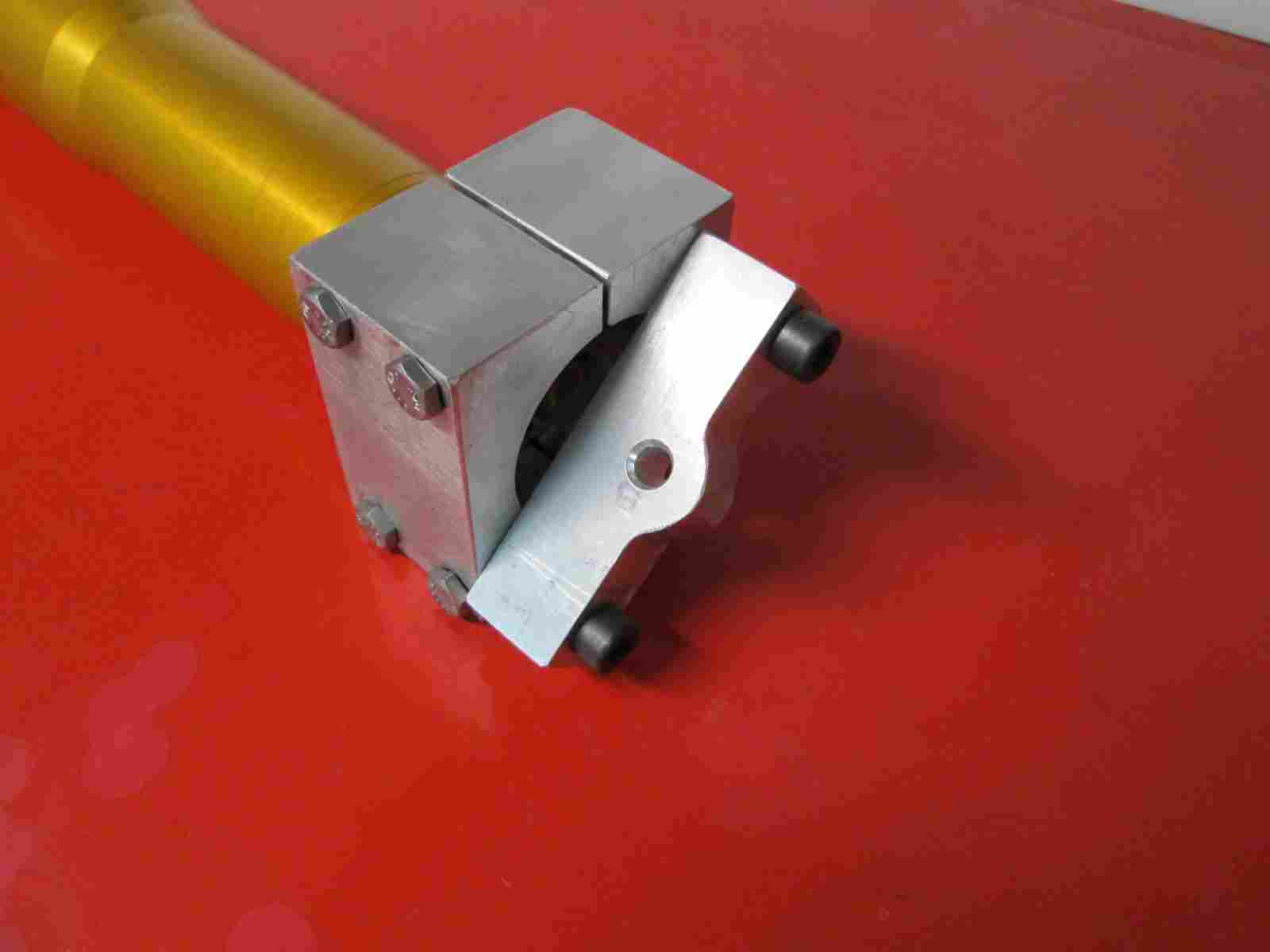

    Shock dyno (or Shock absorber dynamometer)-img_0042s.jpg Shock dyno (or Shock absorber dynamometer)-img_0045s.jpg Shock dyno (or Shock absorber dynamometer)-img_0046s.jpg
    Upper mounting fixtures for front forks.
    Shock dyno (or Shock absorber dynamometer)-img_0041s.jpg Shock dyno (or Shock absorber dynamometer)-sachs.jpg
    An Ohlins and a Sach rear shocks.

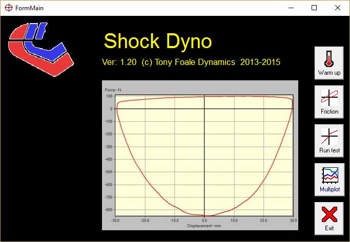

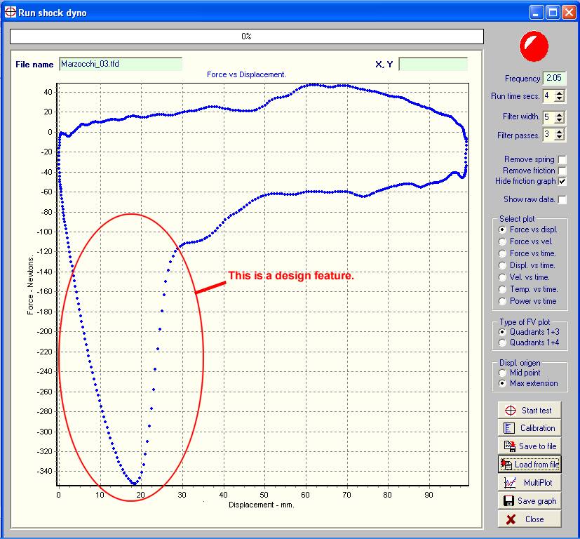

    The input voltage and output signal of the load cell are connected to a dedicated instrument amplifier, which together with the displacement info. from the string pot is feed into a LabJack DAQ (Data Acquisition) system which then passes it on to a laptop for analysis and plotting in some software that I wrote for it. I have also potted some temperature sensors in small aluminium housings which I attach to the shock. Thus enabling temperature sensitivity to be measured.
    Software opening screen.

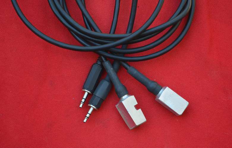

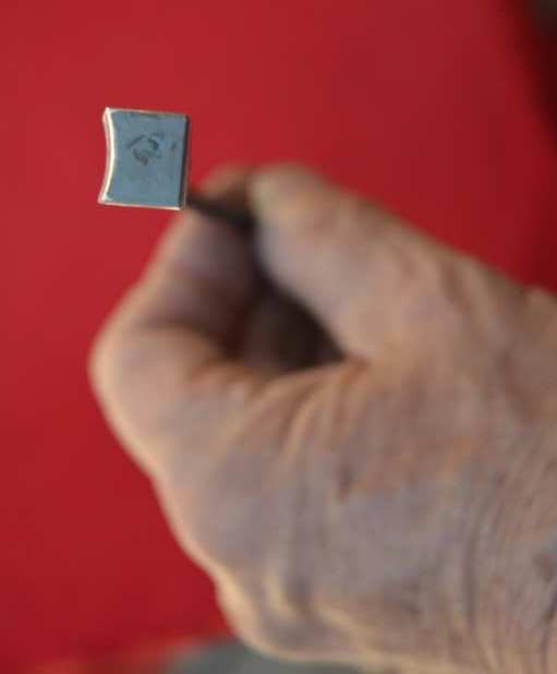

    Shock dyno (or Shock absorber dynamometer)-tempsensor-1.jpg Shock dyno (or Shock absorber dynamometer)-tempsensor-2.jpg
    The temperature sensors. Note the concave block to better fit the shock body. For those shocks with an external gas chamber there is a 2nd sensor for that.
    Older forks didn't always perform too well. Here are the diabolical characteristics of a standard fork. The problem was that the orifice for rebound oil was drilled such that it became blocked off way too early in the rebound stroke.

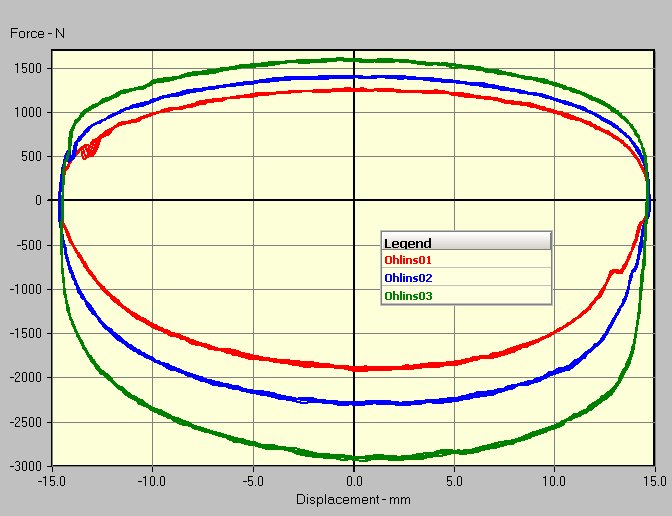

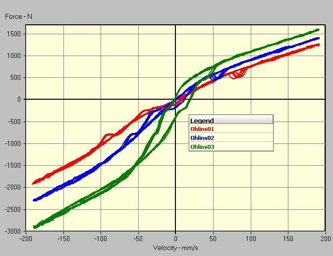

    Shock dyno (or Shock absorber dynamometer)-ohlins_f_d.jpg Shock dyno (or Shock absorber dynamometer)-ohlins_f_v.jpg
    The much better characteristics of modern cartridge forks. On the left is the force/displacement curves with the force/velocity curves to the right. The 3 different sets are with the damping adjustments set to different values. These curves are several repeated runs superimposed.

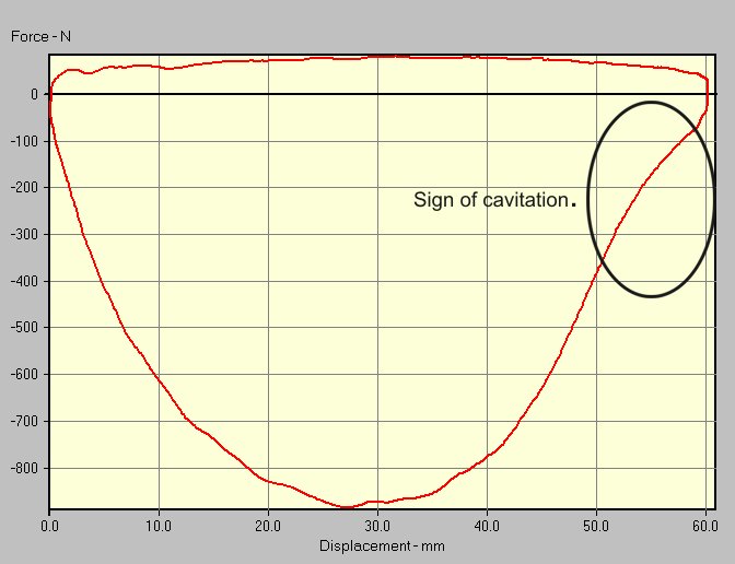

    An example of cavitation due to insufficient gas pressure in the shock.
