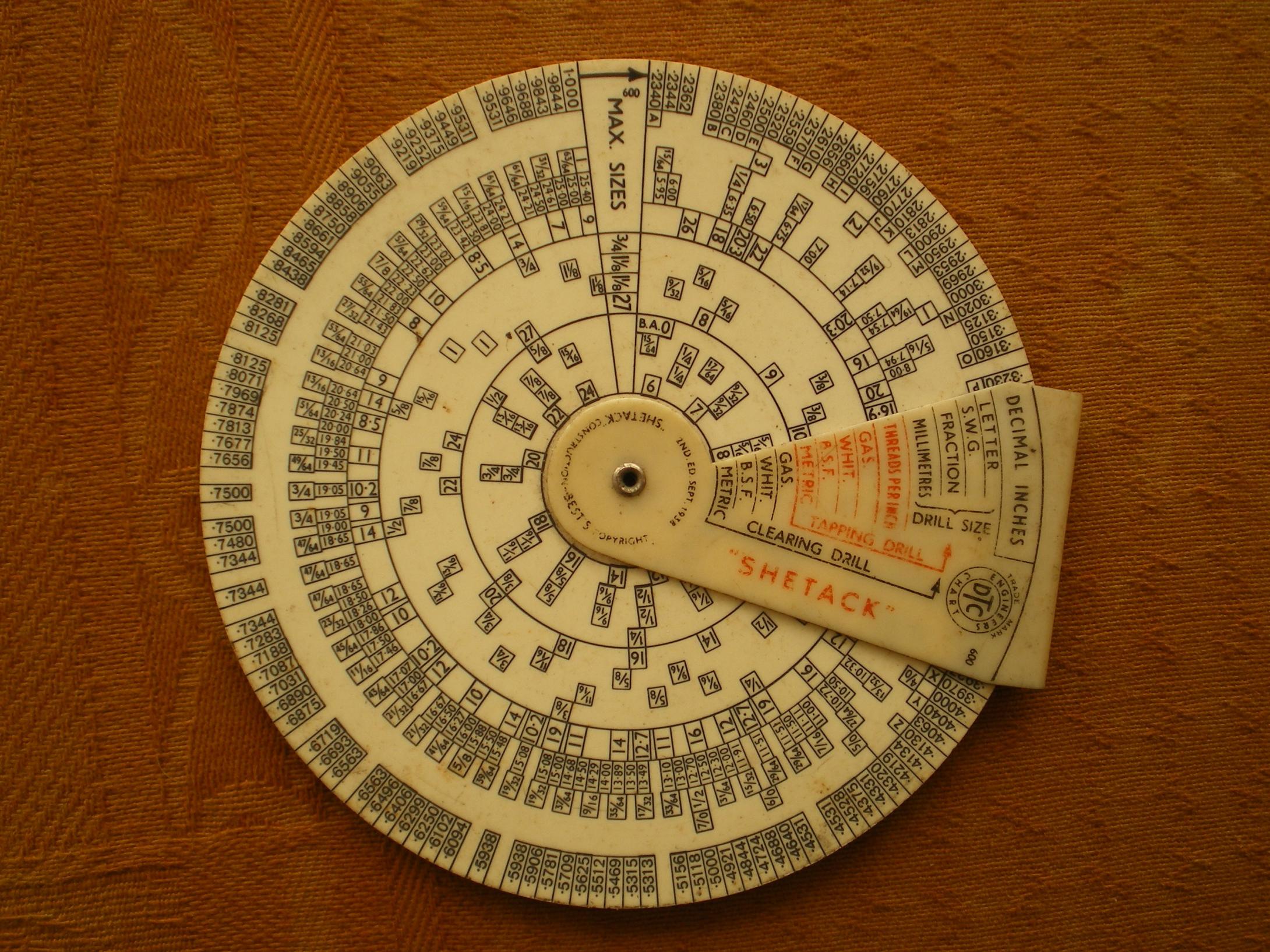

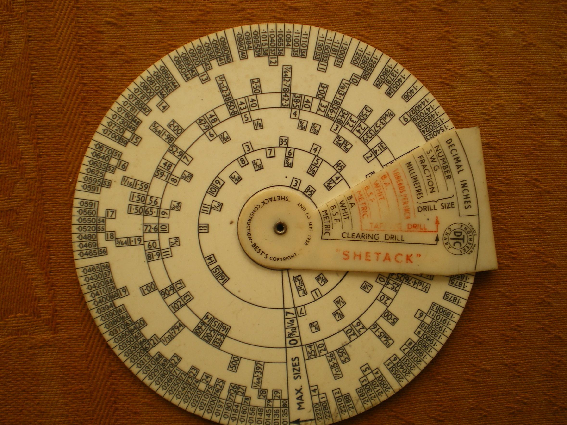

    The Shetack engineers chart
    The Shetack engineers chart-imgp0020.jpgThe Shetack engineers chart-imgp0021.jpg
    I have used one of these for longer than I care to remember, this is a second edition from 1938 bought from a boot sale. I do not know if anything like this is sold these days but it should be as it is virtually a Zues book in your pocket and very handy when working out of the workshop. If you see one don't pass it up.
    BTW I totally agree with Marv that everything should be identified by size and not some reference code.

    Ok, are you going to tell us what it does? It's impossible to tell from the pictures.

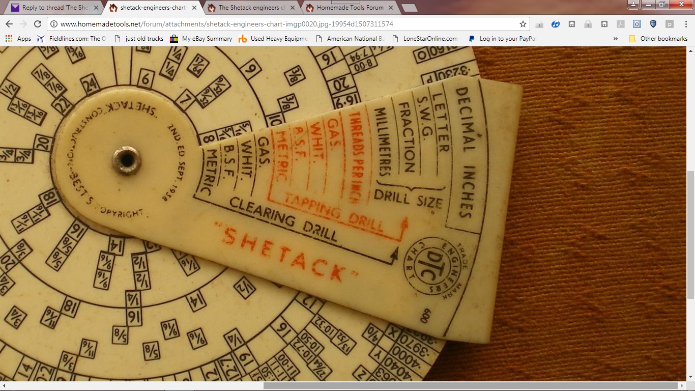

    Marv if you click on the image it will open then click again then it will allow you to click one more time to zoom in here is a screen shot of the close up

    From my observation, this is a thread and clearance hole drill size chart for British Association (BA, BAF), and Whitworth treads (gas piping?). Looks like it gives letter and number drill sizes, as well as fractional, and metric.

    Maybe it's handy for the British branch of the inferial nightmare but it's not exactly simplistic for metric.
    Say I want the tap drill for a 10 x 1.5 mm thread. I line up "metric tapping drill" with 10 as is shown in the photograph. The TPI now reads 16.9. How many machinists can do the math needed to convert that to pitch expressed in mm per thread? Well, when you do that you get 1.503... which is close enough. You look at the outer ring and see you need a 0.323" drill. Now, if you're using metric drills you need to convert that to mm since nothing shows on the dial in the millimeter ring. So, you quickly mentally calculate 0.323 x 25.4 and get 8.2 mm which is close to the right value but will produce more than 75% DOT making threading more difficult?
    Of course, you could have done the whole thing in your mind with a trivial calculation...
    10 - 1.5 = 8.5
    Now, maybe someone can explain how you use the chart to find the tap drill for a 10 x 1.25 mm thread.
    Another puzzle...The chart shows 8 mm "clearing drill" lining up with 0.323". Does that imply that 8 mm = 0.323" (presumably for small values of 0.323)?

    I don't think that a 1938 chart was ever intended to be used for metric (in the UK), other then it had the drill bit size equivalence (if available).
    I was just commenting on what my observation was, I think Olderdan does antique motorcycle restorations (I recall some past post, maybe not him), and here these non SAE/SI "standards" are his repair source sizes.
    This chart even has the wire gauge sizes, even into the 'ott' nomenclature. We know how useful that system is.

    Regardless, 0.323" isn't very close to 8 mm, even if the chart was made up before the inch was set at 25.4 mm.
