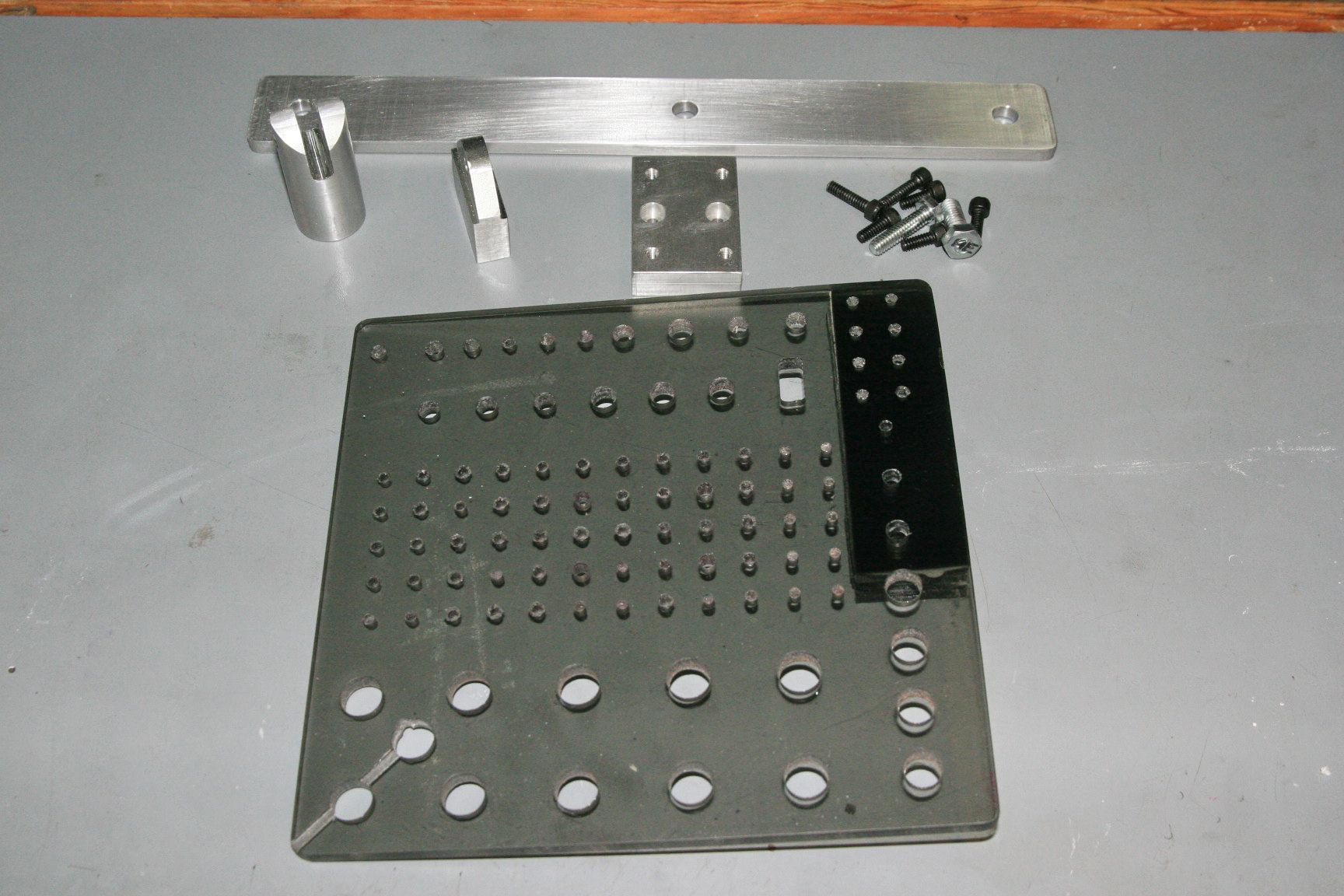

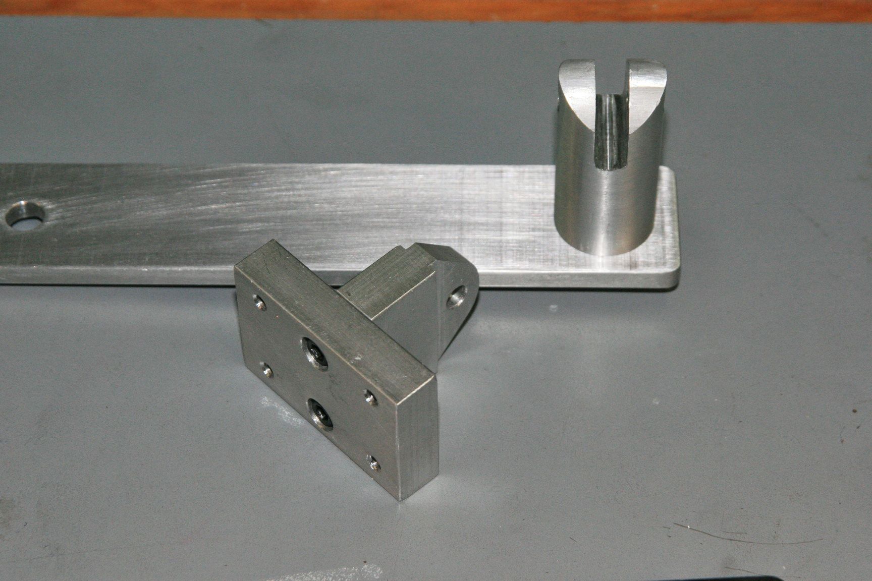

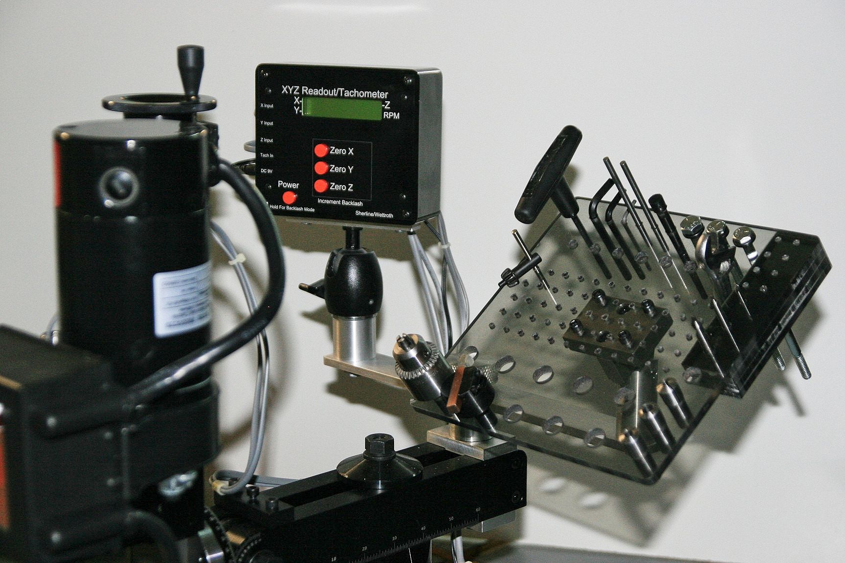

    Well the little Sherline needed a place to keep all the accessories so I made the DRO
    mounting bar longer and added a mounting pillar for a polycarbonate plate. The plate
    has a three thickness block on the upper right side. This is to keep bits like center drills
    from falling through the plate. Extra holes for new accessories are in place. Many are
    just .125" and can be enlarged for whatever. Should improve workflow.
    Cheers, JR

    JR you will never have all of the tooling made but that is the best part of it. I like you tooling storage everything is at finger tip reach but out of the way and neatly arranged.

    Thanks Frank, I find making my own tooling is at least half the fun. My little storage plate
    is something I have seen in other shops or on the net. Kinda like the ones on the drill press etc.
    Paul, In my case the Sherline 2000 was purchased with the DROs already installed. I am not sure how
    they would adapt to the Unimat or other small machines. I like them since they do not get in the way of anything.
    No bar and transducer to install. It is all in the encoder and knob assembly that replaces the original knobs.
    May not be as accurate as the bar and transducer however the Sherline kit (available separately) has an electronic
    adjustment to compensate for backlash. Looks like it should work well.
    https://sherline.com/digital-readout-faqs/
    https://sherline.com/product/8100-24...ill-dro-240-v/
    Package for DRO is quite expensive when bought by itself.
    If you are familiar with Arduino programming I would think it possible to build one that would work using something like this:
    https://www.amazon.com/Wheel-Encoder.../dp/B00NPWGEIM
    However the number of steps would have to match the lead screws.
    Better price for Sherline kit from Amazon:
    https://www.amazon.com/Sherline-Mill...ncoder+readout
    Cheers, JR

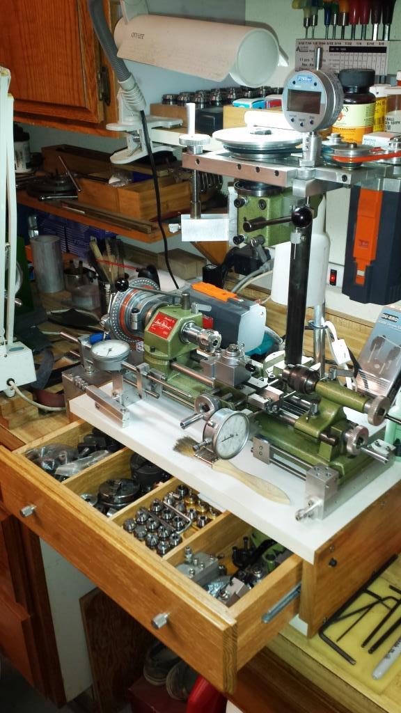

    Most of my machining with the Unimat SL is typically less than 2" so the dial indicators work well. I have a digital dial indicator on the vertical direction for the milling head that can be easily reset to zero or into mm and wish I had the same on the other two axes now that some of my projects are using metric dimensions. See photo below for the 3" swing Unimat lathe with the milling head addition and indexing plates added to the horizontal and vertical axes.
    Sherline 2000 Mill Accessory Plate for Tooling-unimat-sl-1000-modifications-cabinet.jpg
    Great info,
    Paul Jones

    My mill is 20 tpi for the lead screws. Sherline does have metric versions of most of their equipment. They do have a metric version of the DRO.
    I also use a 0-2" dial indicator on my lathe as well as a converted 6" digital caliper. (not at the same time). The 2" dials are great especially if you are not working with parts longer. Mine is an inexpensive import like this one on eBay:
