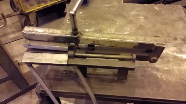

    Hi
    This a prototype from sheetmetal bending brake.
    Its for making boxes, handles 1.5mm thick sheets.
    Bending radius is 7mm.
    This one is quickly weld together.
    My intention is to make better one without weldings.
    But i think that the idea can be seen from this one too.
