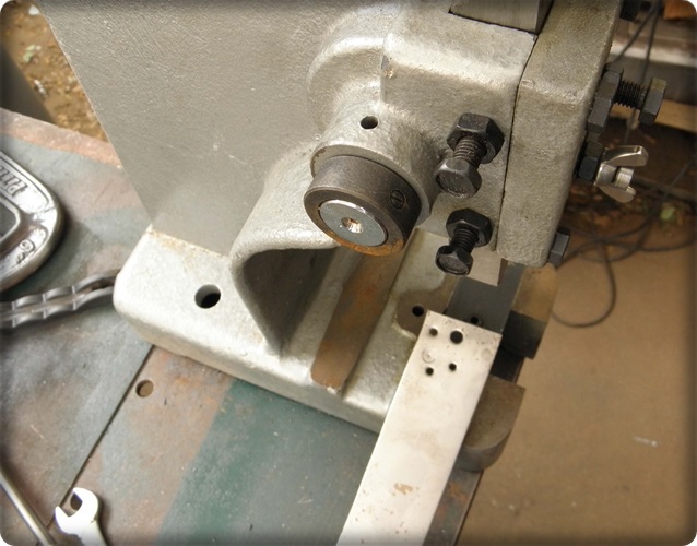

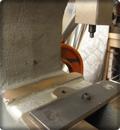

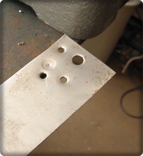

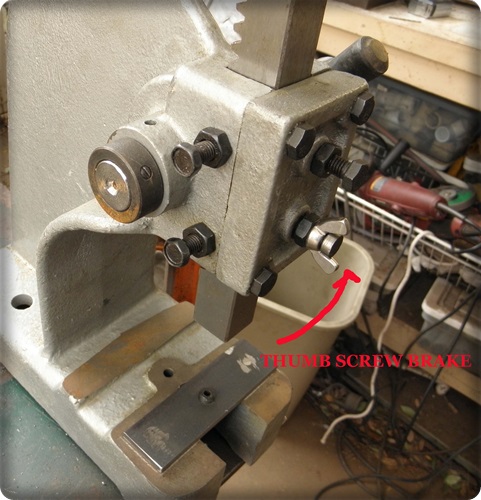

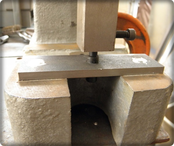

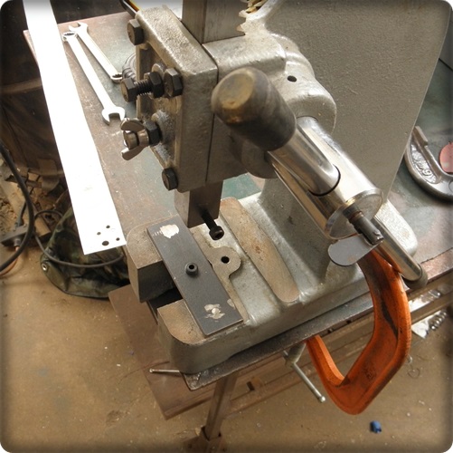

    Sheet metal hole punch mod. made from steel.
    When making metal boxes this punch is a great time saver. when adding the hinges and latches.
    Sheet metal hole punch mod.-001.jpgSheet metal hole punch mod.-002.jpgSheet metal hole punch mod.-003.jpgSheet metal hole punch mod.-004.jpgSheet metal hole punch mod.-005.jpgSheet metal hole punch mod.-006.jpg

    Nice idea. did you chose a 1 or 2 ton arbor press?
    simon
    Jul 2014
    San DIEGO, California
    1,097
    496
    Captainleeward's Tools
    My guess is 1 ton. :O)
