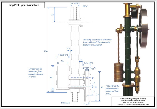

    Plans for this Lamppost Engine are now available as a pdf
    Hand drawn on a drawing board, lots of notes and photographs of the parts.
