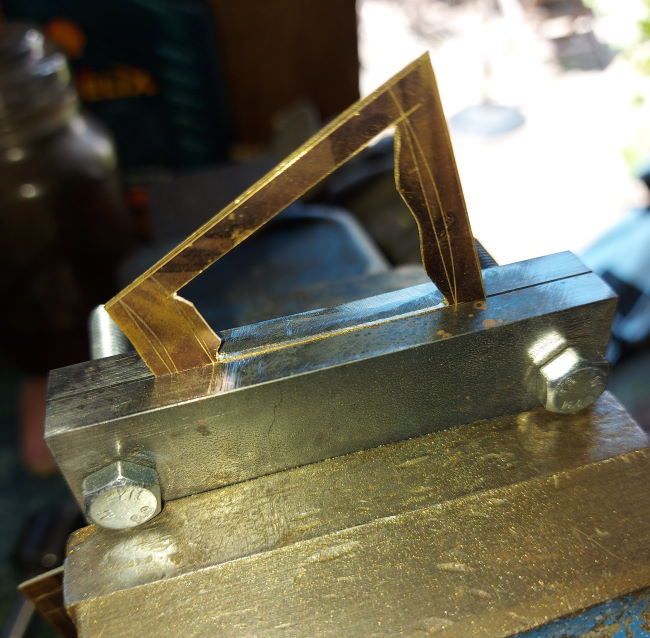

    I've been making a lantern folded out of brass sheet and wanted an accurate edge to file to.
    Just 2 pieces of 1/4" mild steel, edges case hardened and 2 6mm bolts.
    This allows me to align the edge against the marked line and then to file to it.

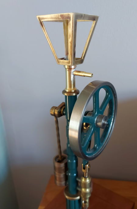

    Work in progress for the lantern on the lamp post engine...

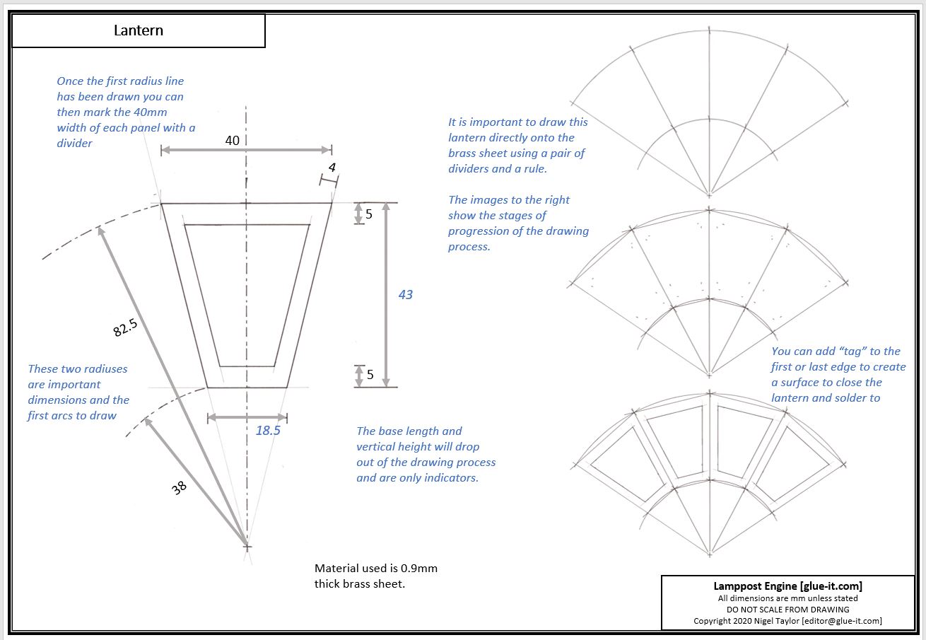

    I'm gradually turning out the plans for this engine, but thought I would share an image of the very simple way I drew the lantern that was then folded
    This is the engine then running, the small generator is driven by the flywheel
