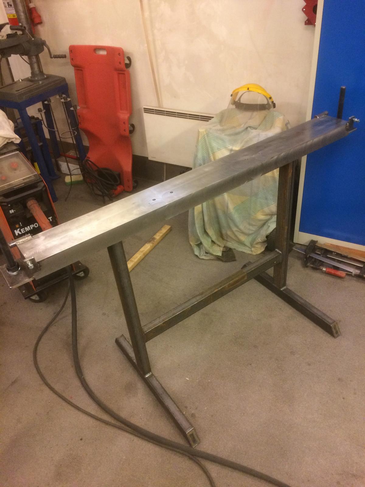

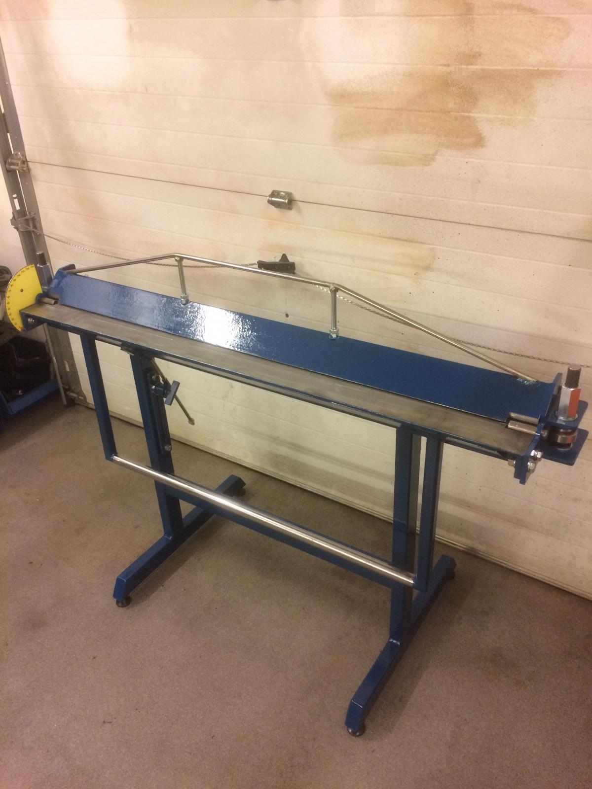

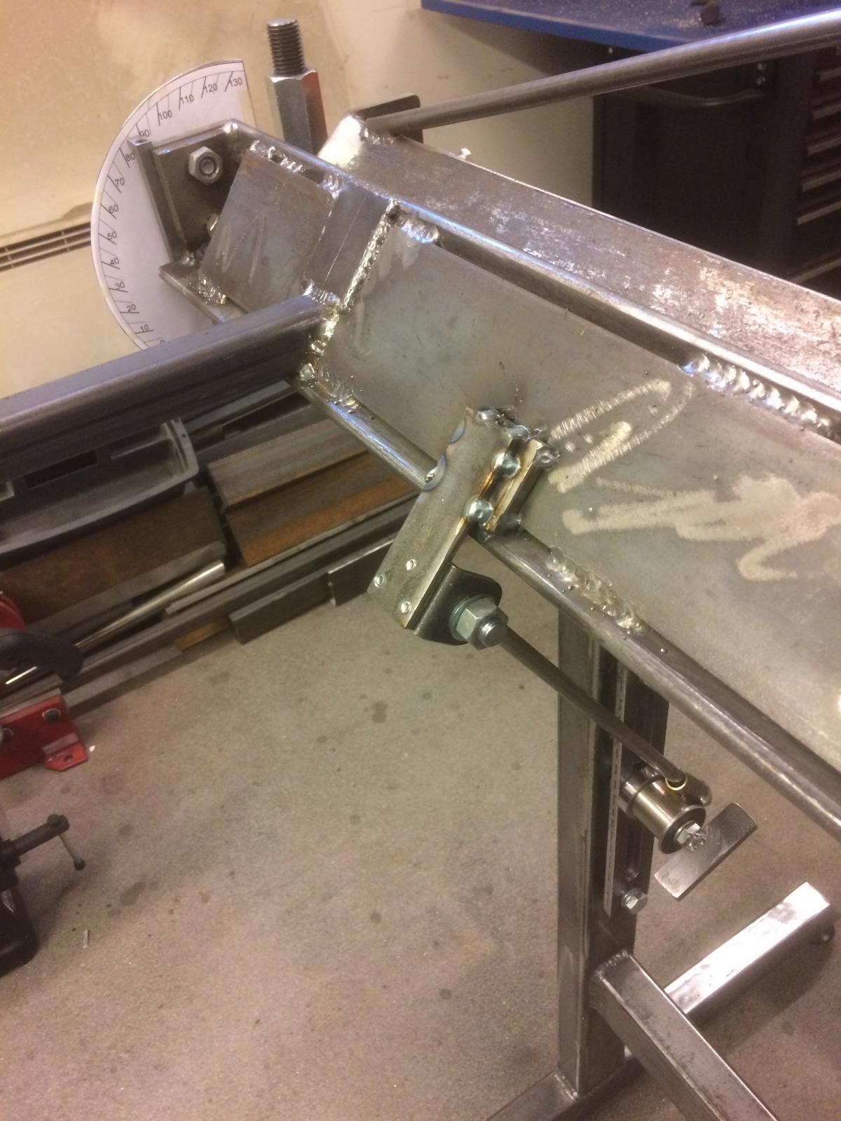

    For a while I have been planning to make a sheet metal brake that could bend parts up to 125 cm wide that is the common width of sheet metal plates here in Finland. When my daughters family needed window and door sill plates for their garage and storage building I had a good reason to start the project.

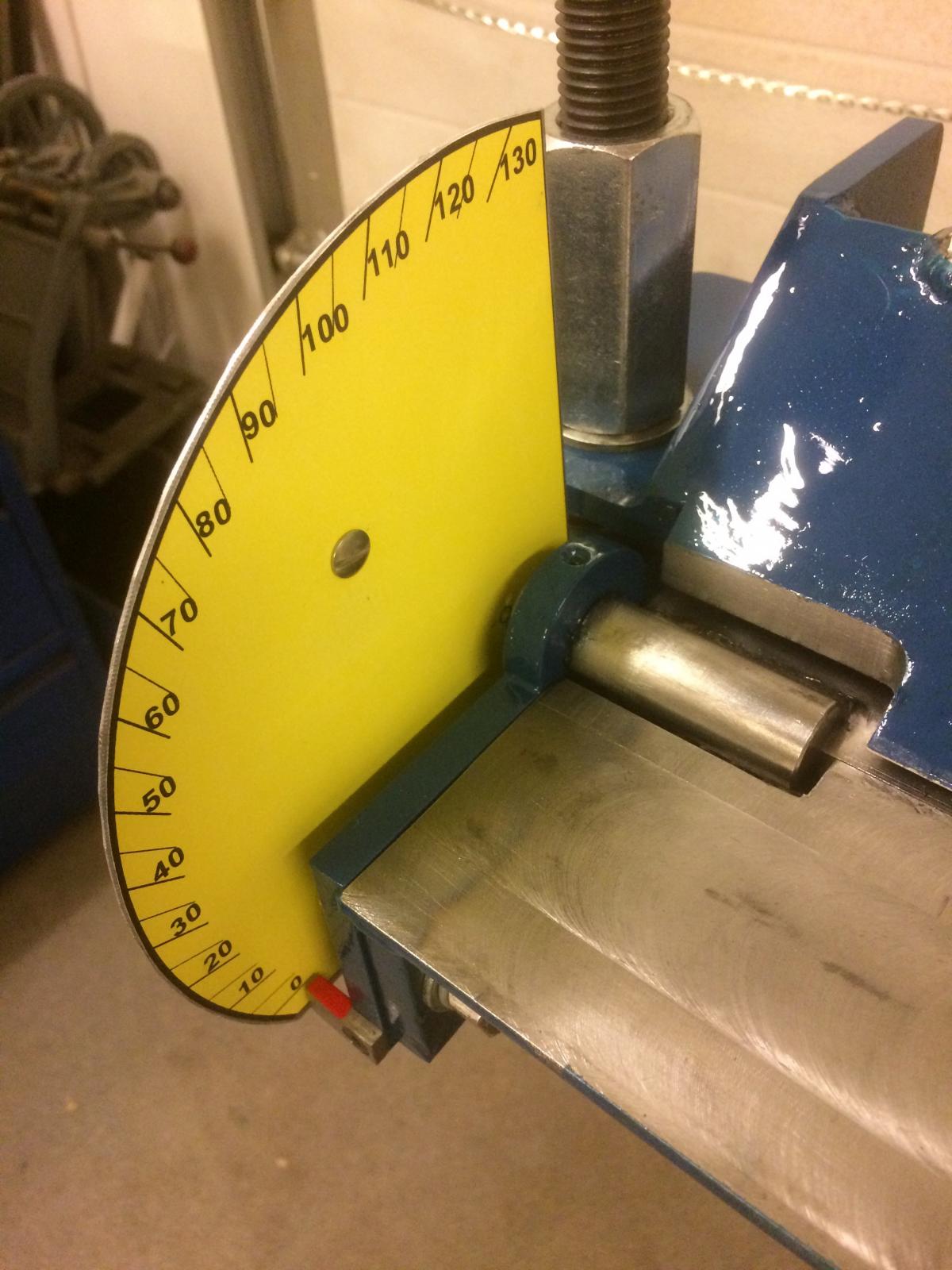

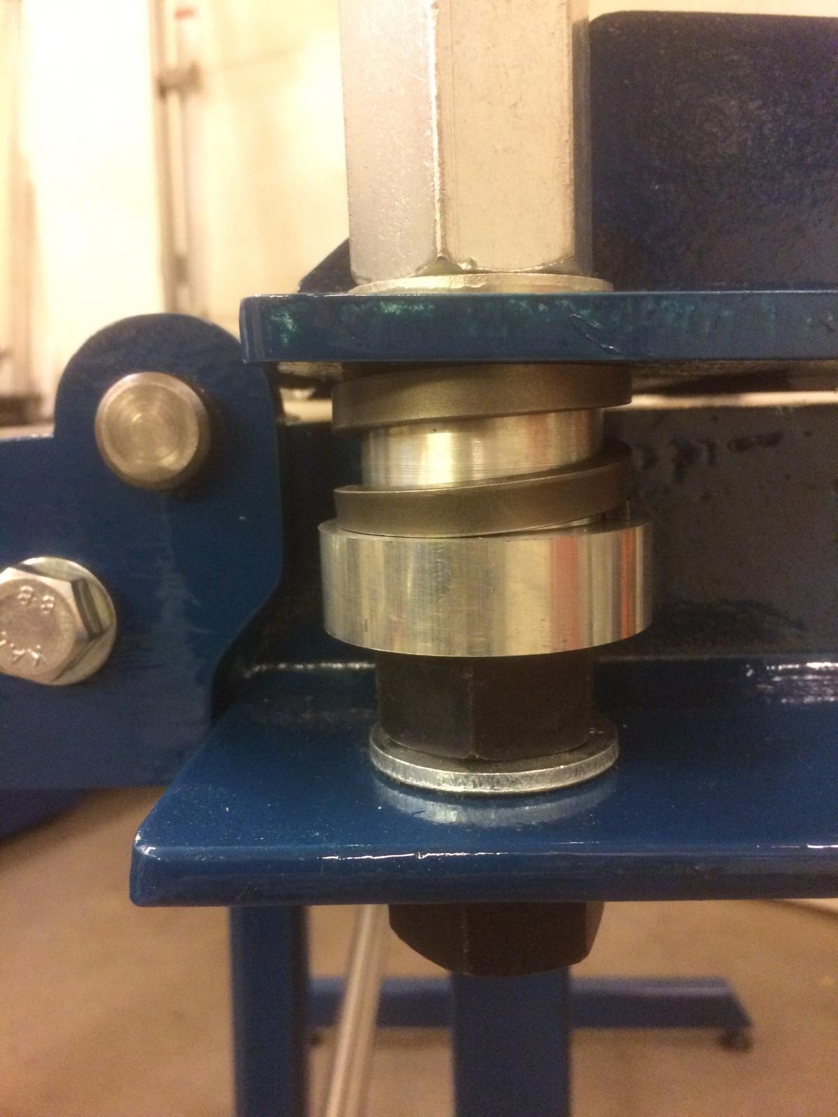

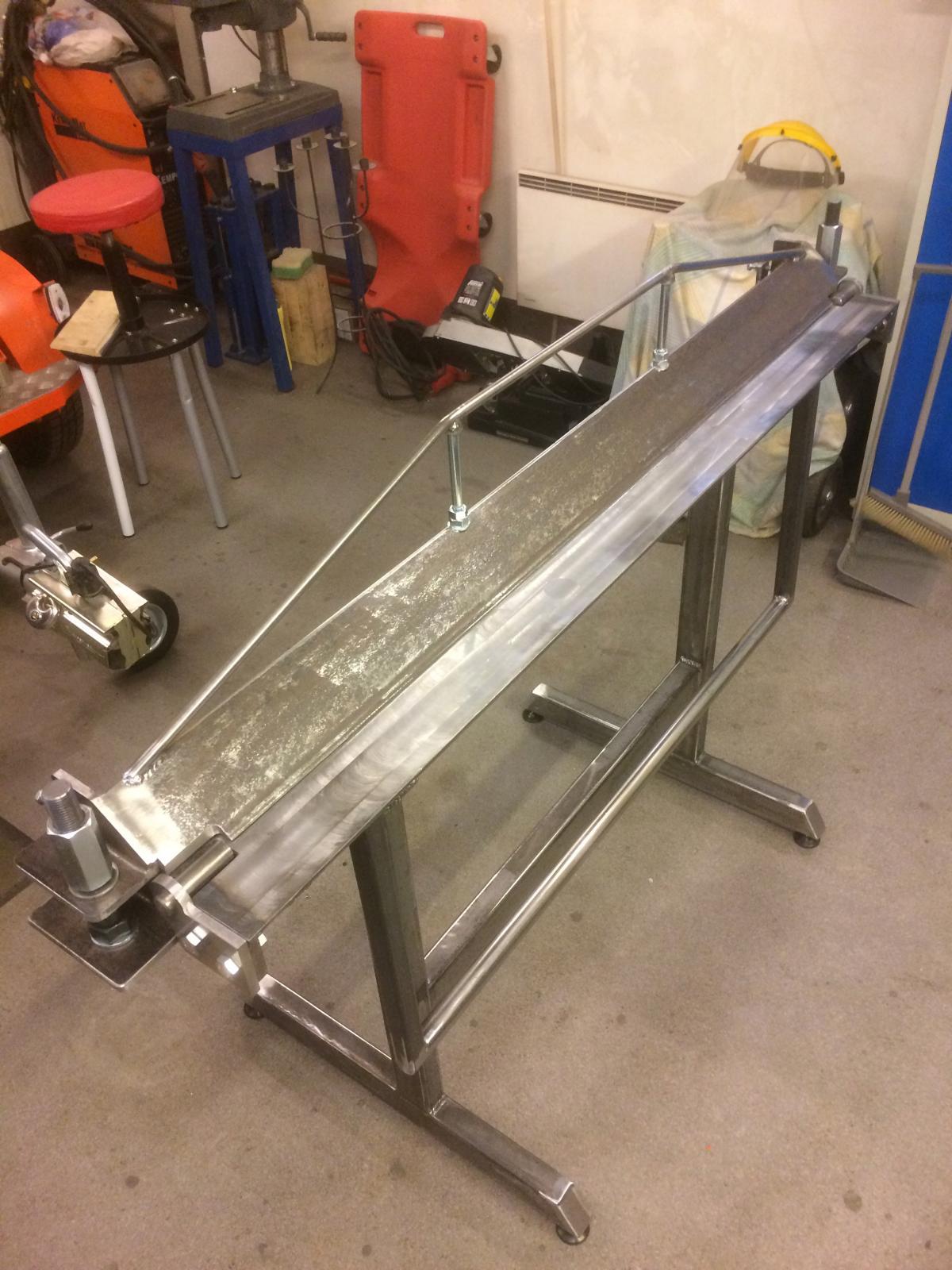

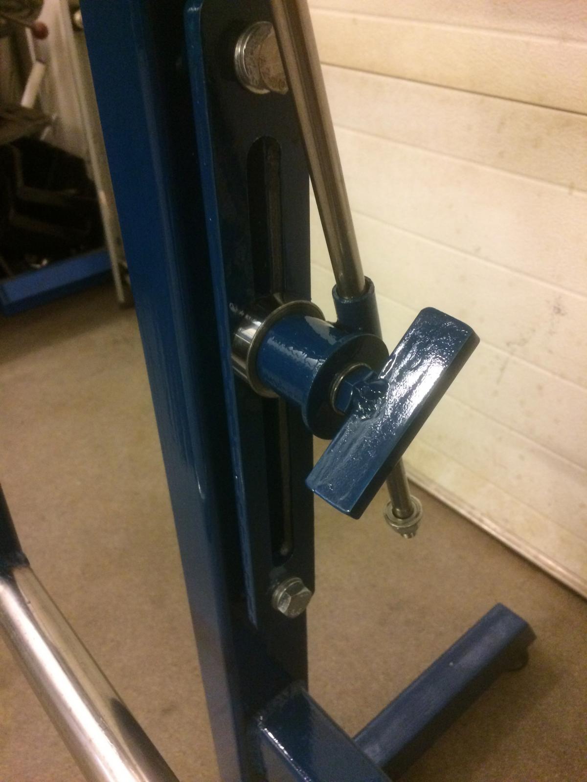

    Here are some pictures of the painted and assembled sheet metal brake. I made an angle scale in the left end of the brake. In order to be able to do repetitive angles I made an adjustable stop mechanism. In order to make it easier to insert the workpiece under the upper hold down angle I used two strong springs salvaged from a VW Golf driveshaft flange to rise the hold down angle about 5mm above the bed when you loosen the tightening nuts.
    Sheet Metal Brake-img_2300.jpg Sheet Metal Brake-img_2301.jpg Sheet Metal Brake-img_2302.jpg Sheet Metal Brake-img_2303.jpg

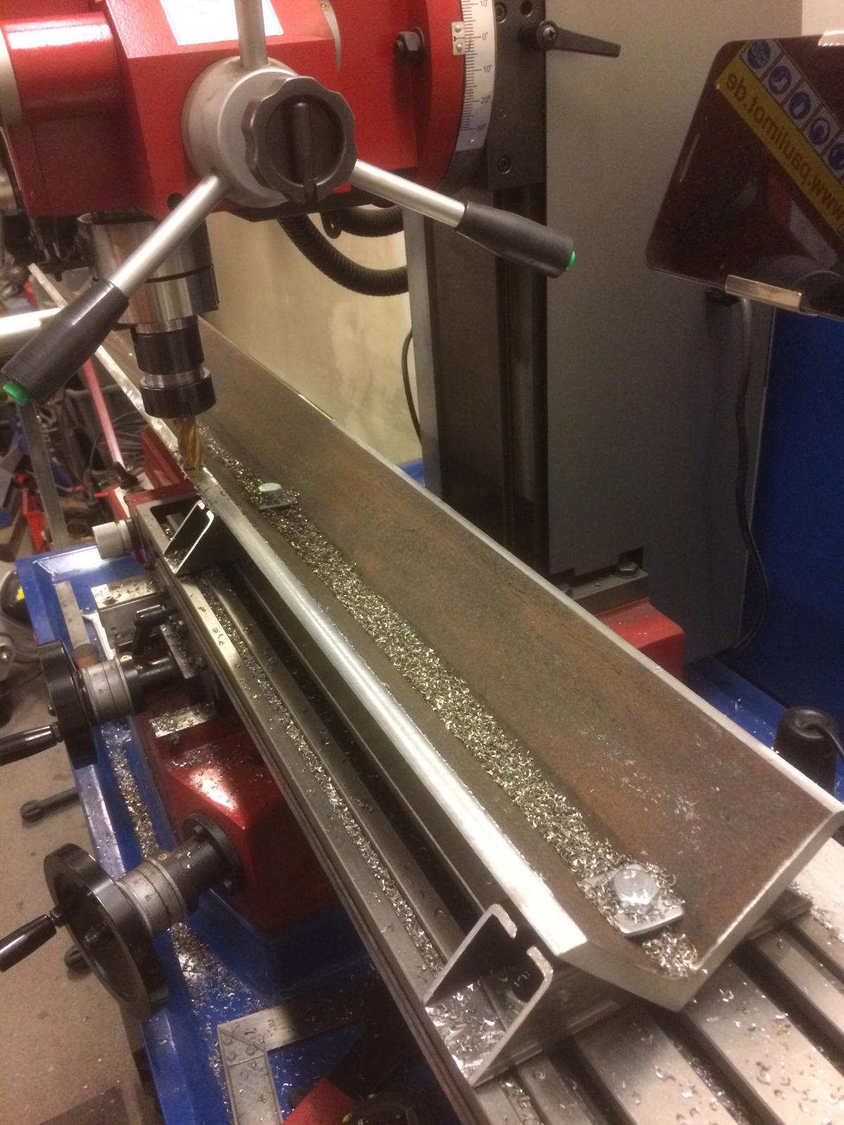

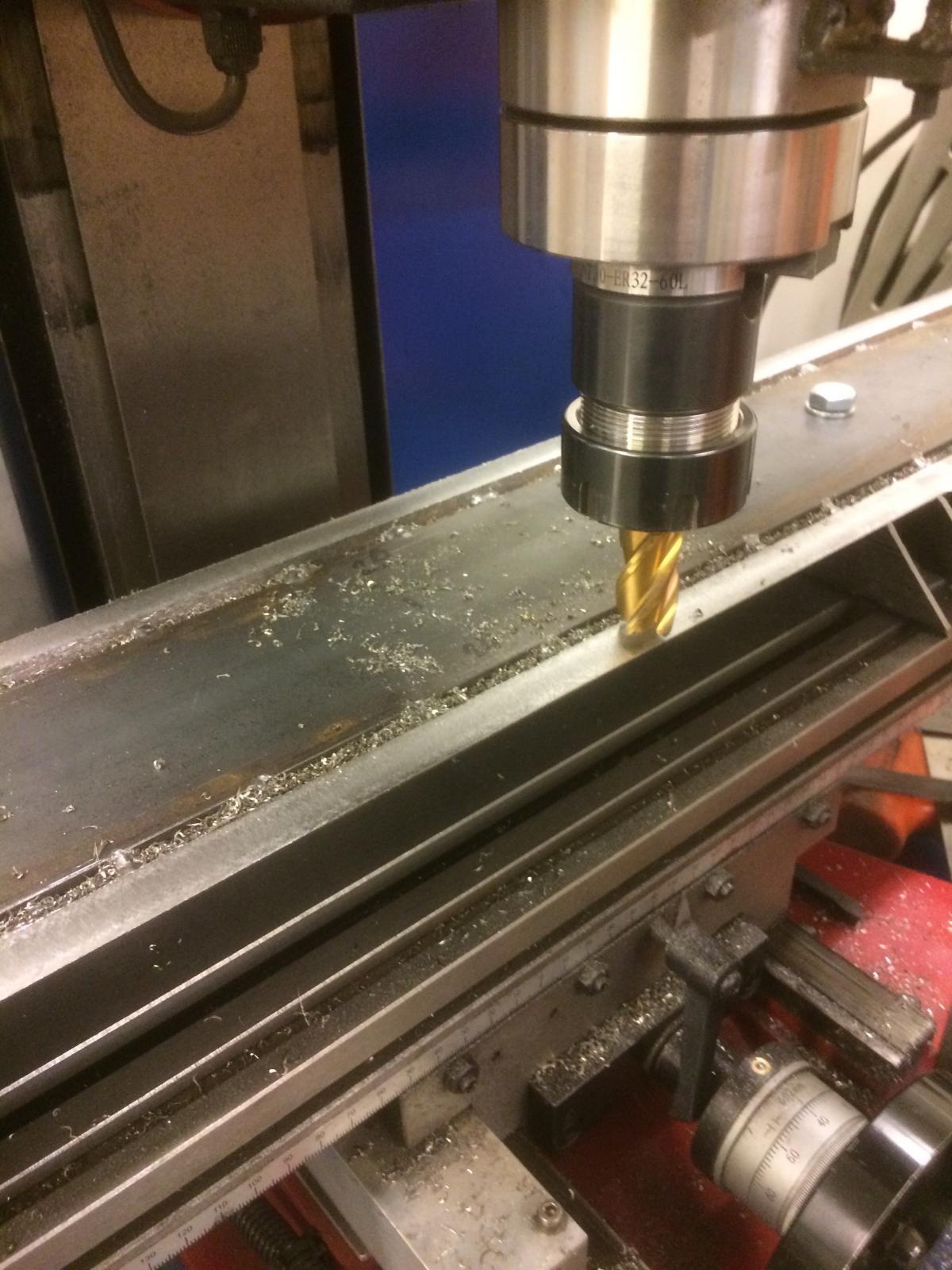

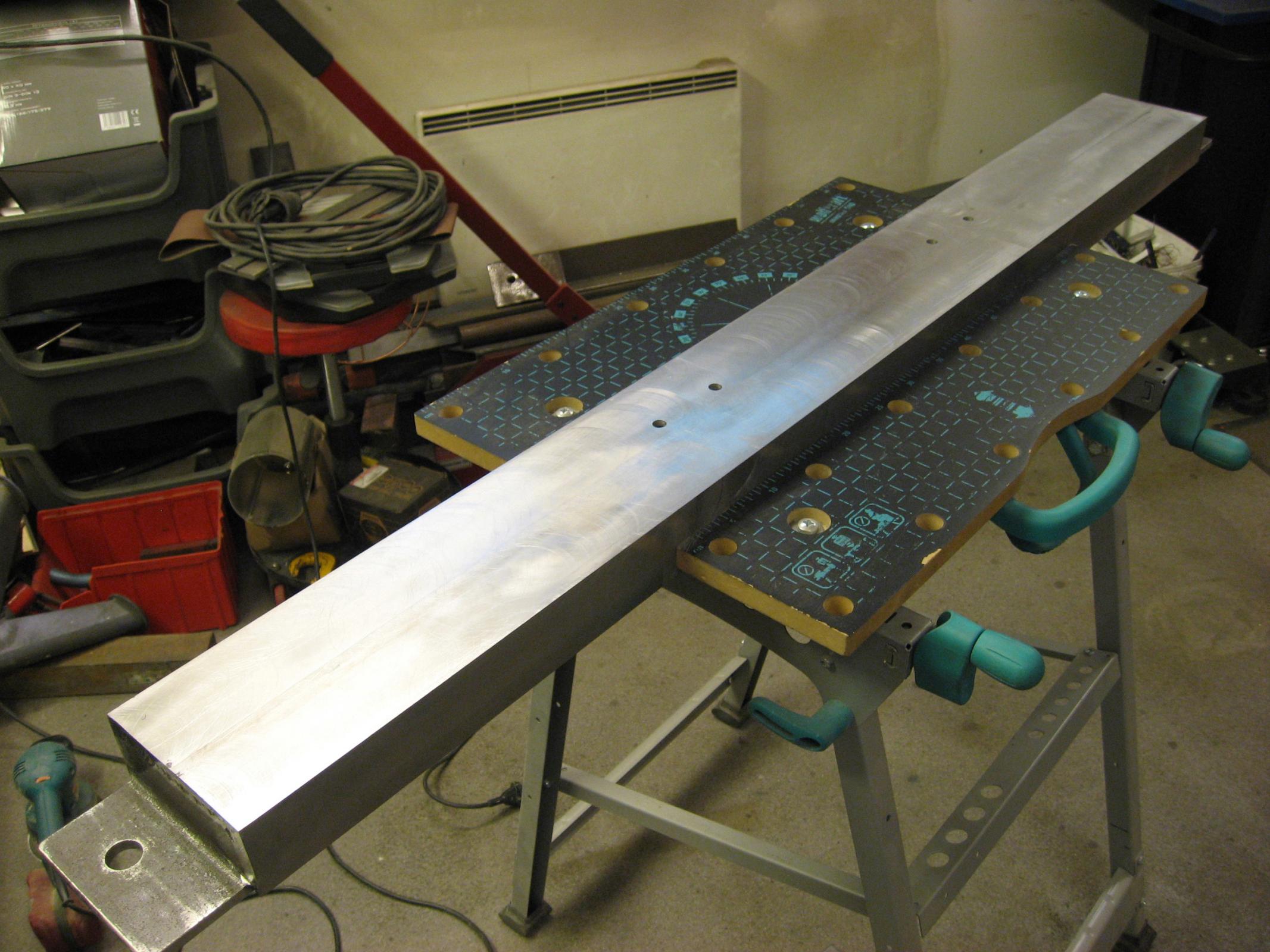

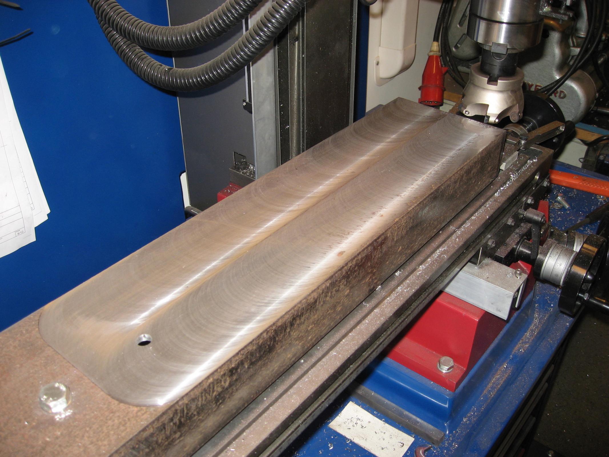

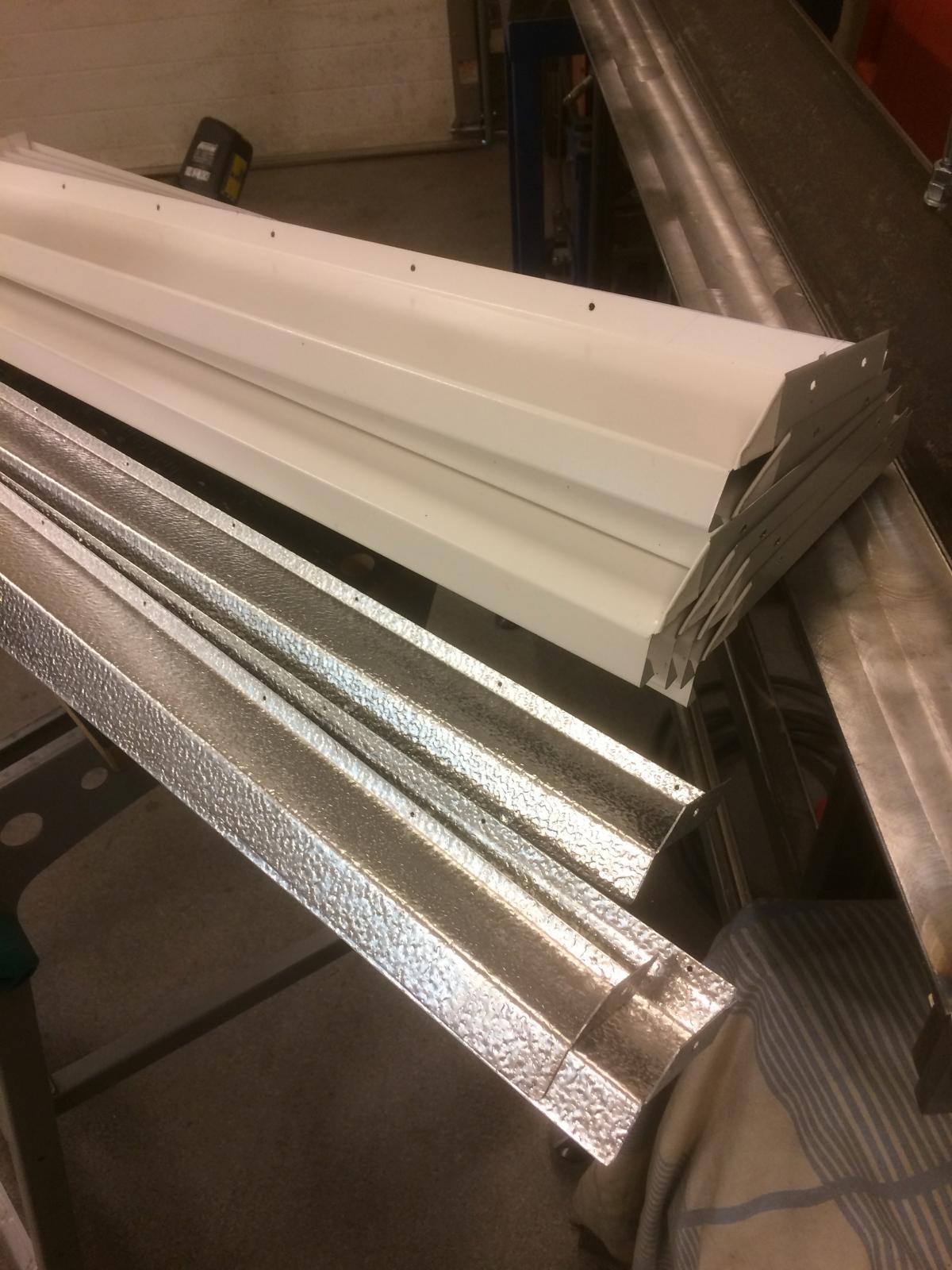

    Here are some additional pictures from the building process. The hardest thing was to mill the bed and hold down angle surfaces with my Sieg SX3L mill that has a travel of about 560 mm and the workpieces were 1400 mm long so I had to mill them in three passes. The surface finish is not perfect but they are pretty straight. The last picture shows the window sills that I bended as testing before painting the brake. Before anyone asks about how I bended the end bends - I did them with loose Promecam tools in my bench vise.
    Sheet Metal Brake-img_0124.jpg Sheet Metal Brake-img_0127.jpg Sheet Metal Brake-img_2272.jpg
    Sheet Metal Brake-img_2240.jpg Sheet Metal Brake-img_2150.jpg Sheet Metal Brake-img_2273.jpg Sheet Metal Brake-img_2275.jpg

    [QUOTE=ruxu;141634]For a while I have been planning to make a sheet metal brake that could bend parts up to 125 cm wide that is the common
    well done!!! how is it holding up with deflection in the top beam?
    what size angle did you use?

    [QUOTE=desbromilow;141650]
    Quote Originally Posted by ruxu View Post
    Des

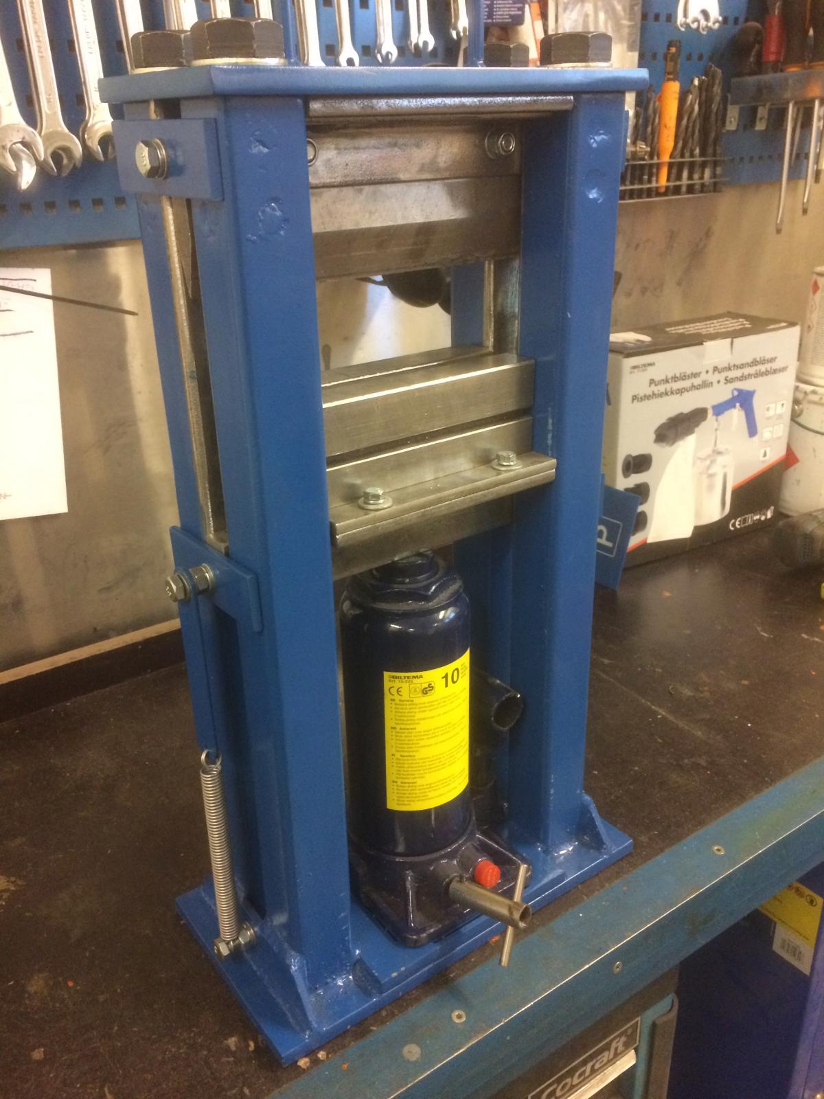

    At first I did not make the adjustable preload bar on the top beam and then there was a slight deflection problem. After adding the preload bar the deflection is no longer a problem. Mostly I need to bend materials with thicknesses of 0,8 - 1,2mm, occasionally 1,5mm. For thicker materials I have this small hydraulic bender but the max. width is only 160mm.
    The angle bar is 100 x 100mm with a material thickness of 10mm. It is strengthened with a 80 x 8mm flat bar welded to the bottom of the top beam angle as you can see from one of the pictures.
    The bed is made of a U-bar 60 x 140mm with an average material thickness of 8mm. The moving bending angle is 80 x 80mm with material thickness of 8mm. It is also strengthened with a 80 x 8mm flat bar.

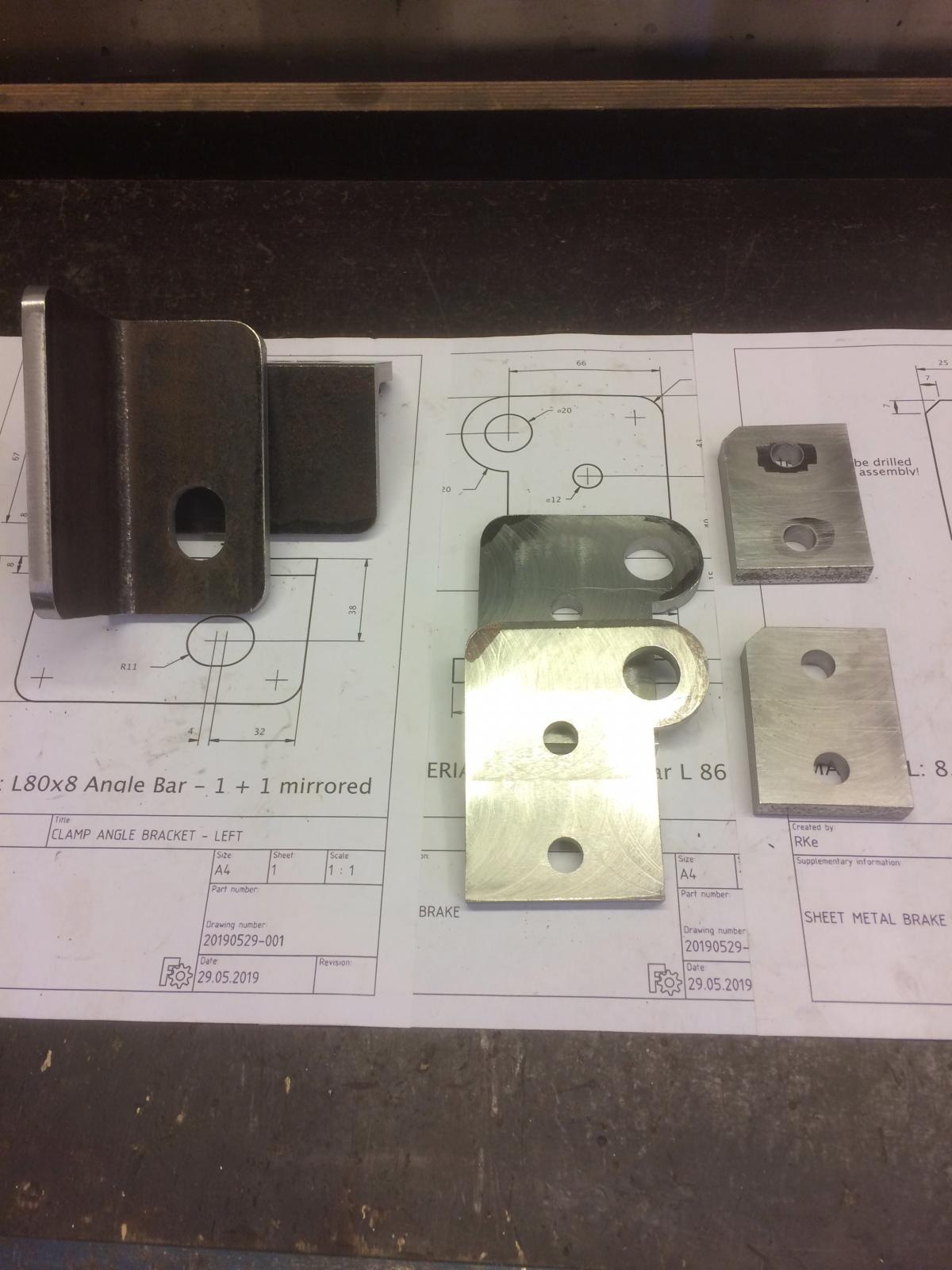

    Very nice tool. one of the pictures shows in the background a set of drawings. Did you design this and if so, will you share them?

    Quote Originally Posted by mdhatter3 View Post
    Yes I designed it wit FreeCAD using some ideas found on the internet and adding some own solutions. I did not make many drawings as I mostly used the 3D model dimensions directly as many parts are very simple. And as usually during the process some parts were modified from the drawings. For example in the picture you are referring to two of the three parts had to be slightly modified from the original design to be able to make bends up to 140 degrees.
    So now when the sheet metal brake is done I find it very hard to motivate myself to make the design up-to-date and produce accurate drawings. If I had an almost complete set of drawings I would of course be willing to share them.
