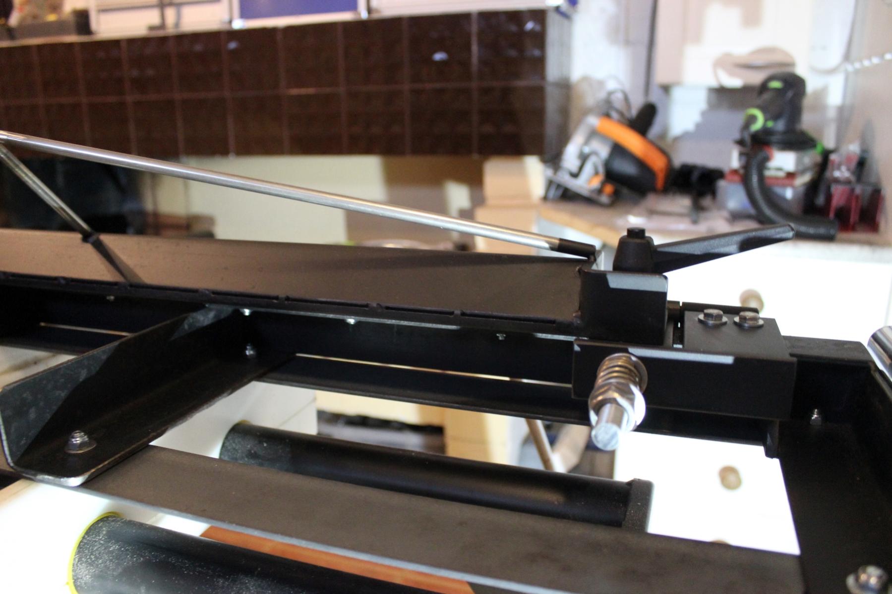

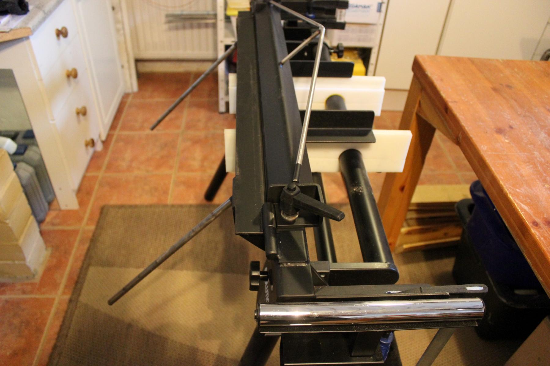

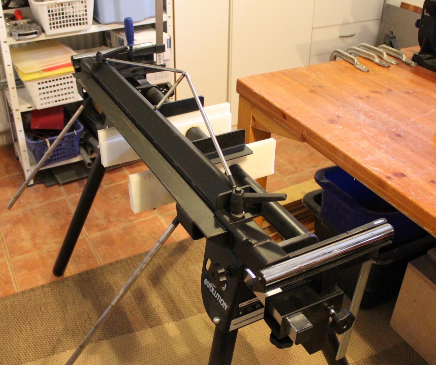

    This is my bending brake.
    I made it from 4mm thick 40 x 40mm L-profile
    6 and 12mm steel bars.
    And 3, 4 and 6 mm thick flat bars.
    This short video shows my space saving idea in it:

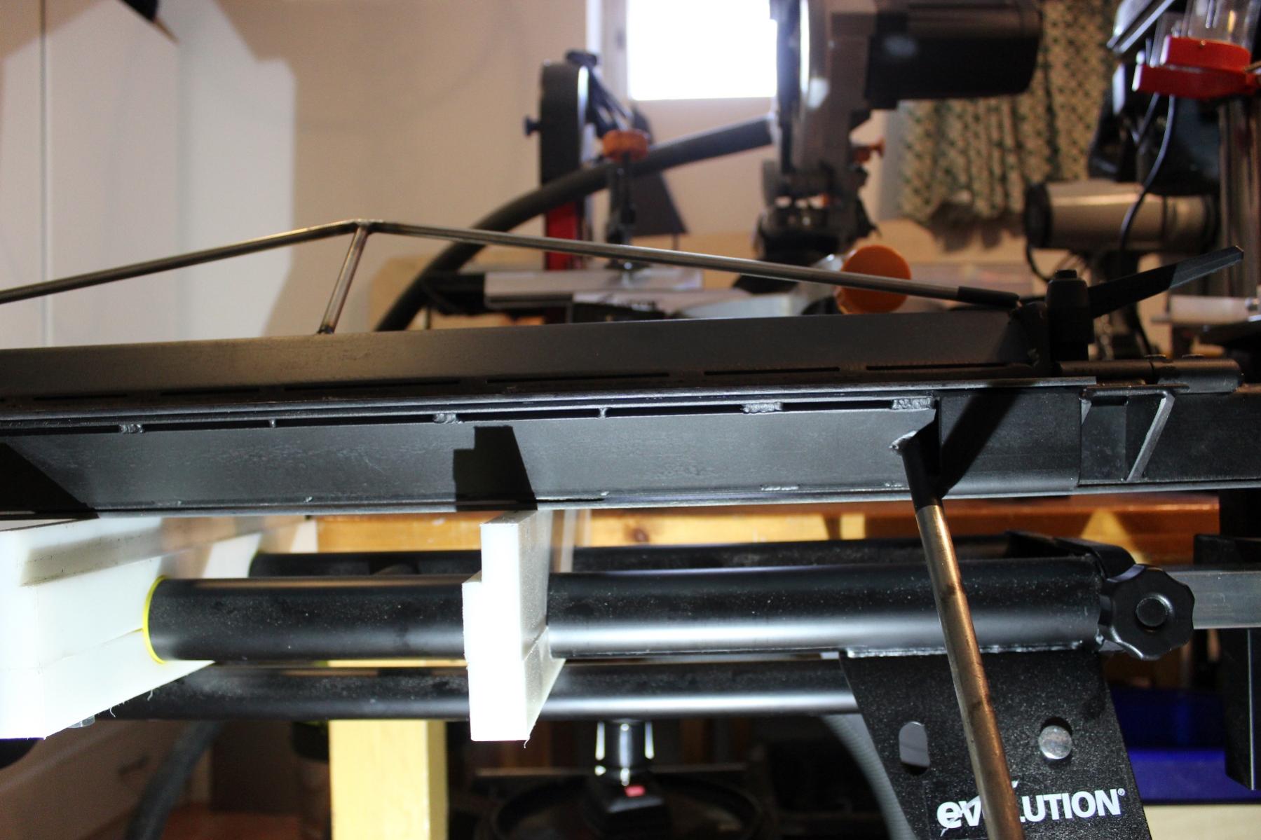

    I wanted to get brake that could bend 2-3mm thick steel. Also i wanted to be able to do some bends with bigger radius, without noticeable marks. That's why i made bending radius adjustable.
    This video shows the actual making the frame:
    You can see the main idea of the structure and the radius adjustment from these pictures.
    Sheet metal bending brake.-1.jpgSheet metal bending brake.-2.jpgSheet metal bending brake.-3.jpg
    I bought hinges, screws and nuts from my local hw-store. Those costed 5 euros.
    All other material is from the recycling center and costed 30 euros.
    Used tig for welding, but it could be done with mma, mig/mag too, of course.

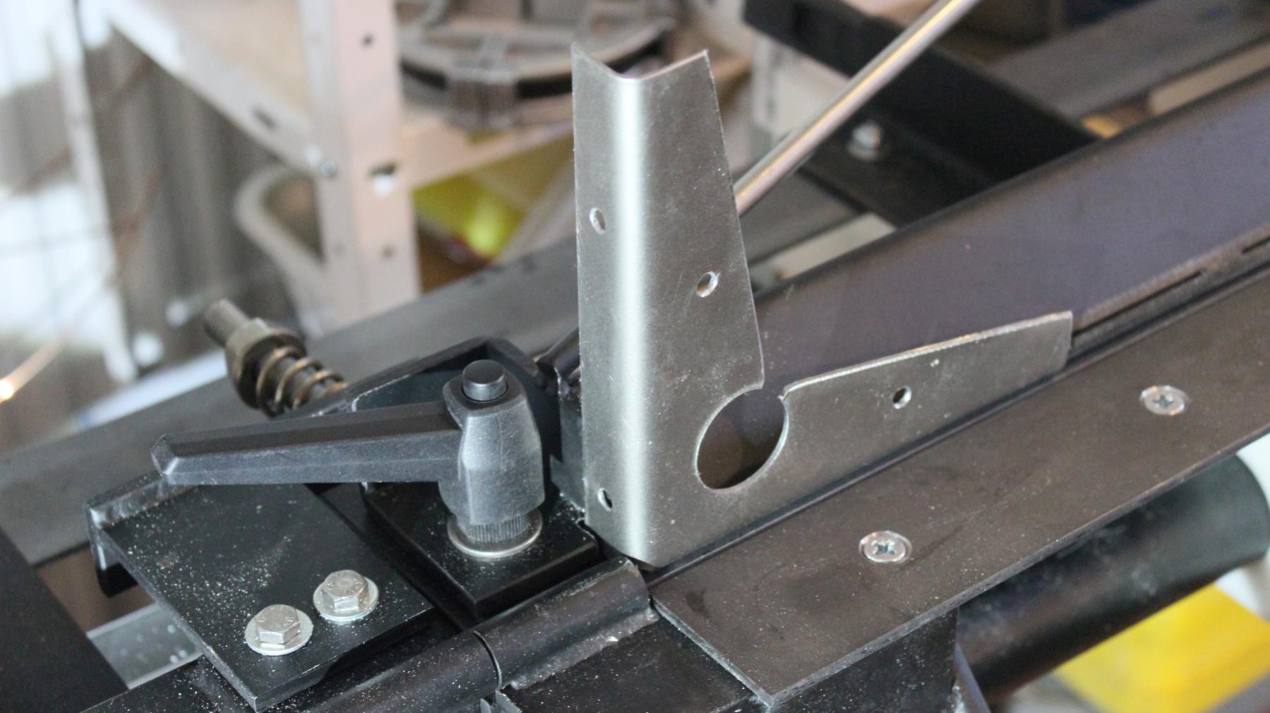

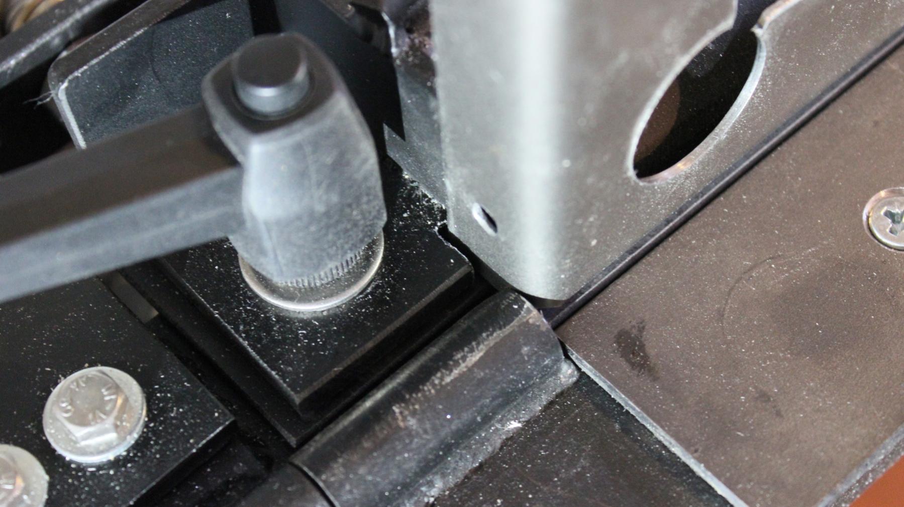

    Closer look for the "corners" little groove allows to make brackets and stuff like that.
    I like to use tig, it doesn't make splatters. Build was very simple process, all parts are cut straight.
    I used chop saw and angle grinder for cutting. But that's optional.
    Drill press and hand drill.
    M6 threading tap. M12 threaded rod. M6 nuts and bolts.
    2 pieces of tight springs. Washers.
    This video shows the radius adjustment:

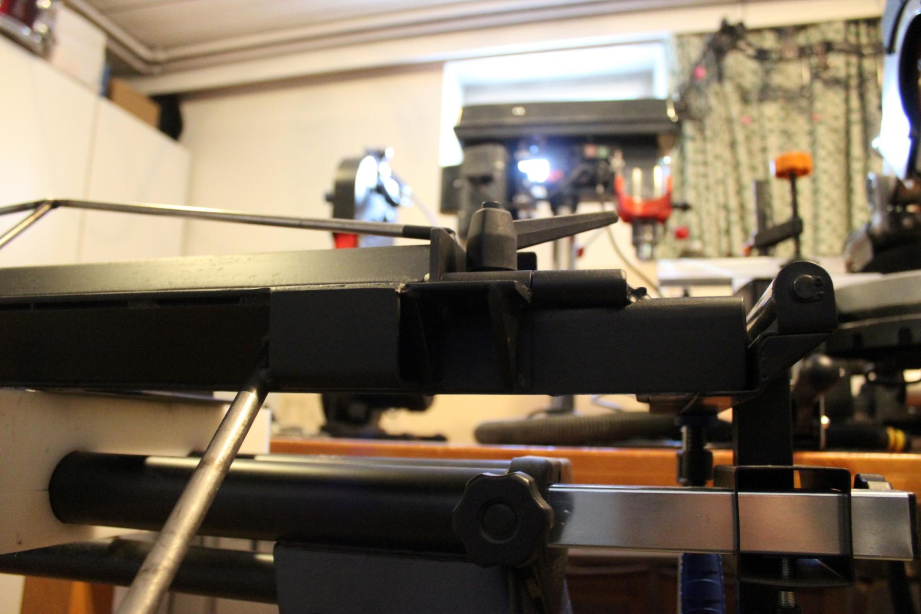

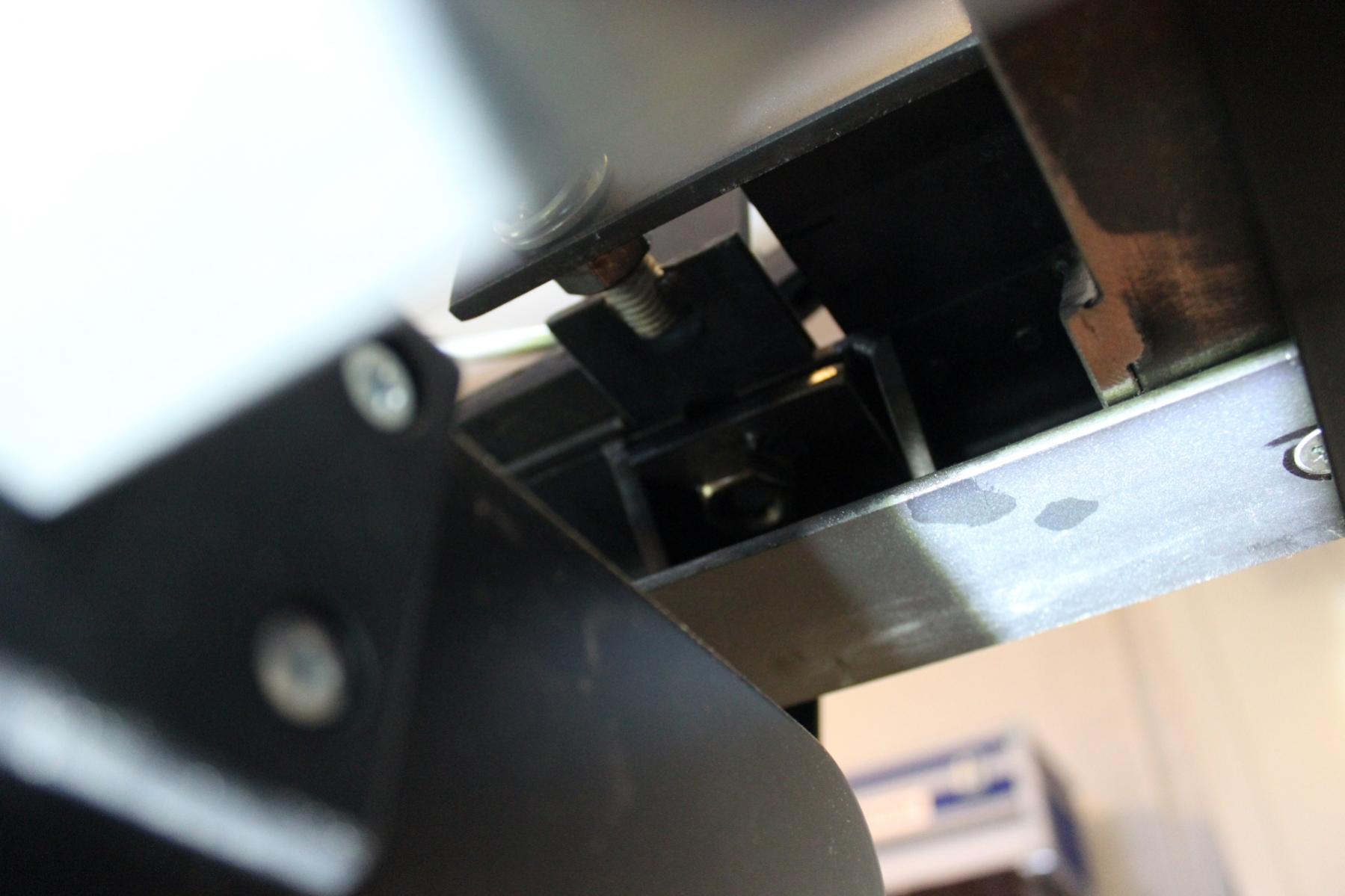

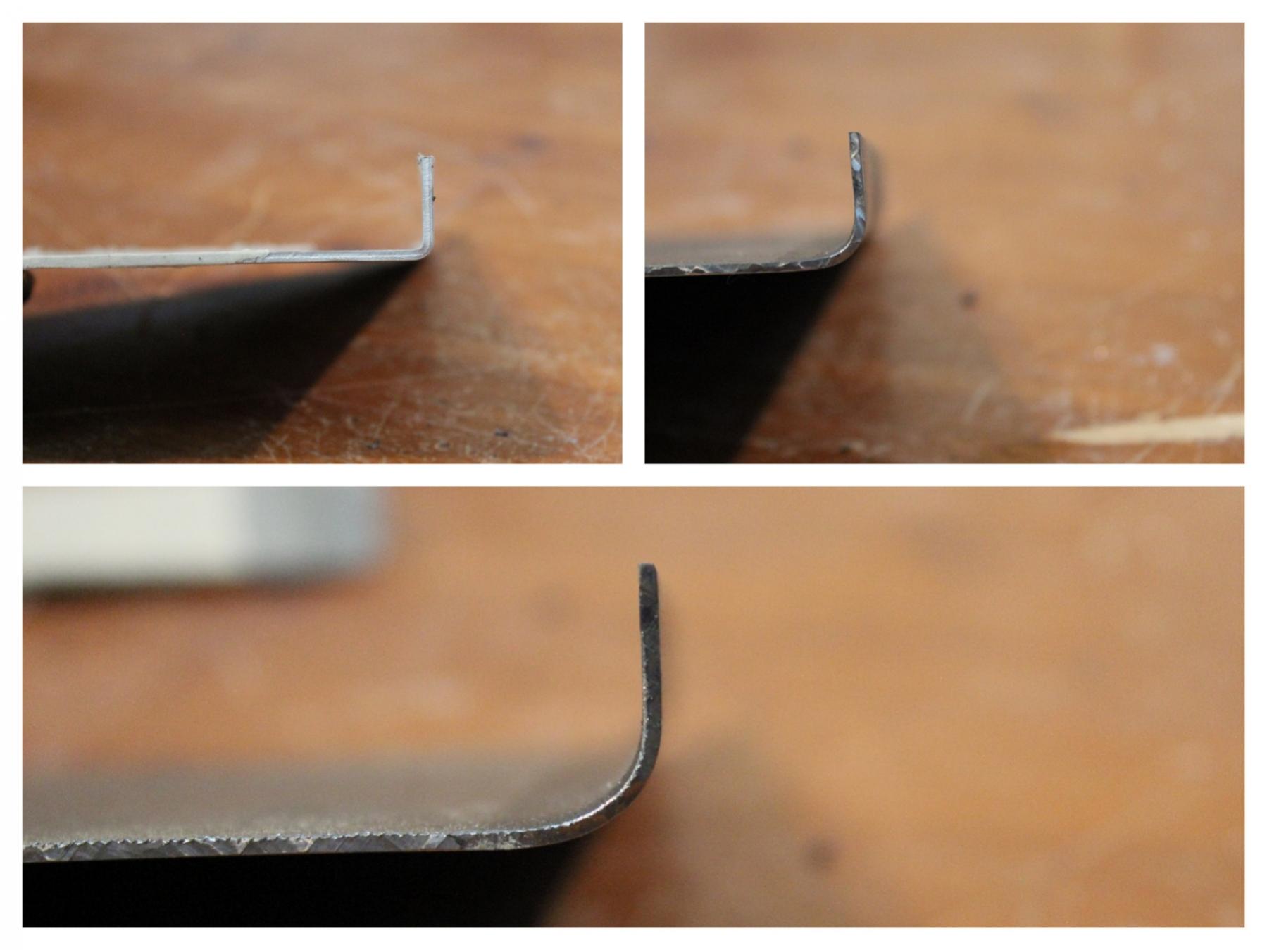

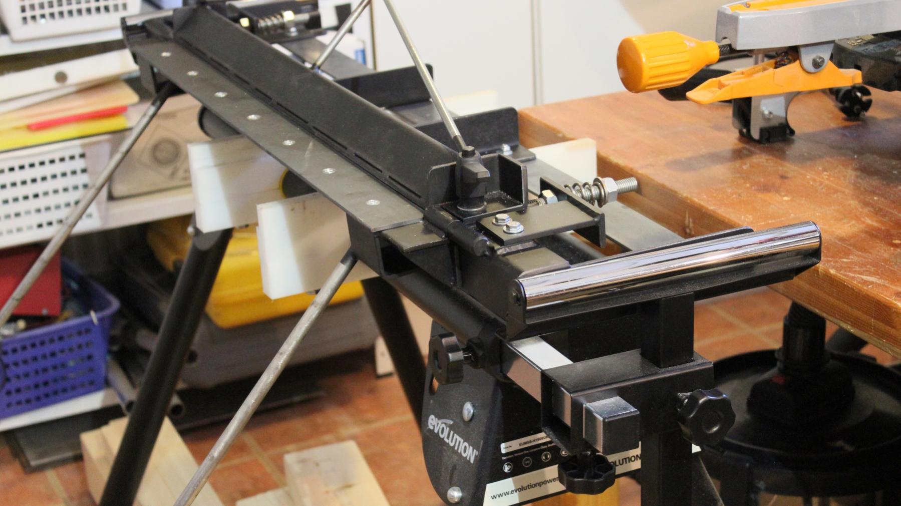

    Finished my bending brake.
    Now it has a easy to use radius adjustment from 1-12mm:
    Video shows the idea:

    Forgot to add pictures from this simple feature.
    Allows me to bend brackets and stuff like that.
