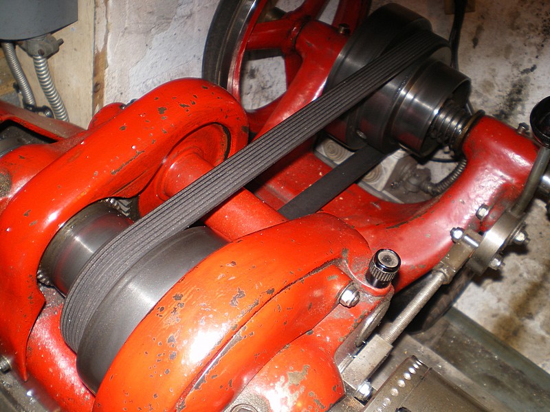

    Canobi,
    For some years now I have been running my SB lathe with an inside out poly v belt which is super smooth and quite cheap to buy. I have tried scarfed leather and flat grinding belts but this is the best.
    I like flat belt drive as it is quiet and has saved a few tool breakages (works like a fuse).
    Attachment 22976

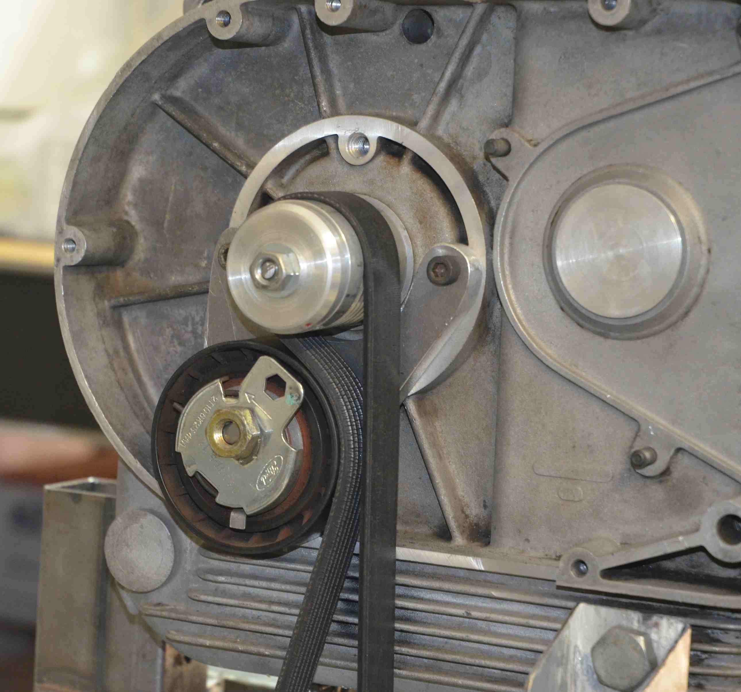

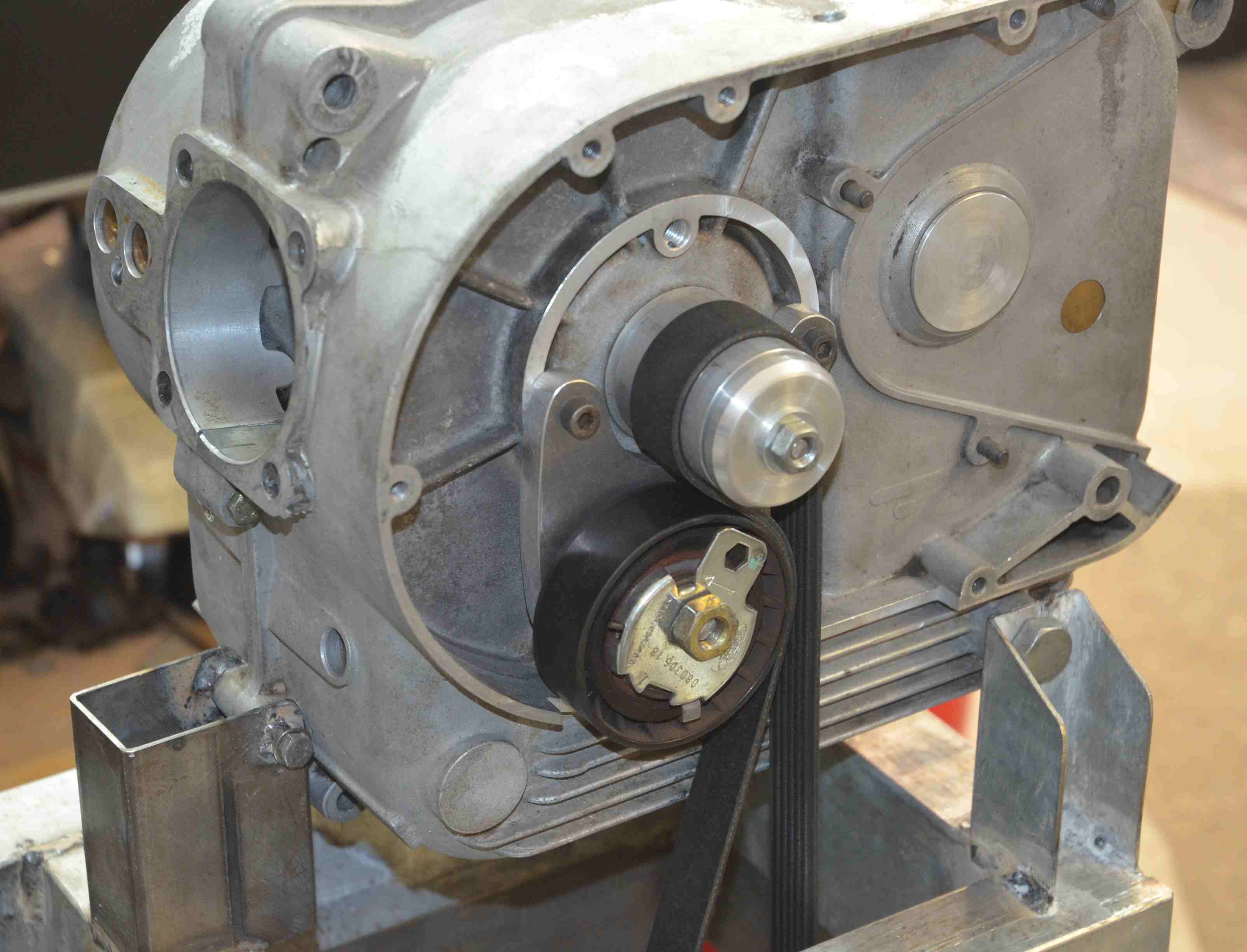

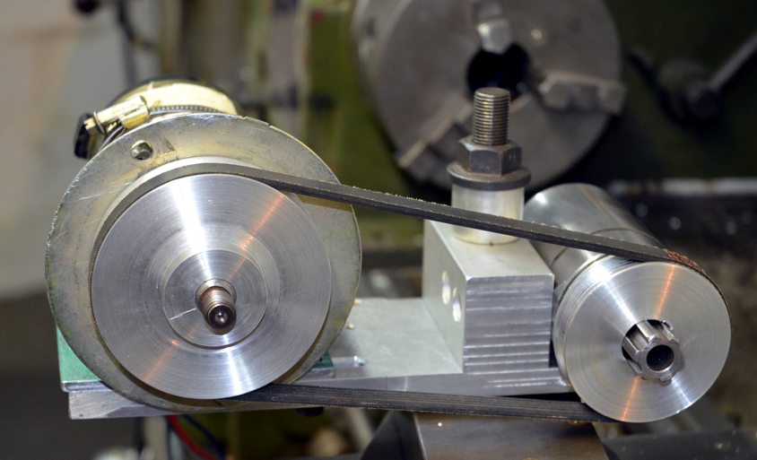

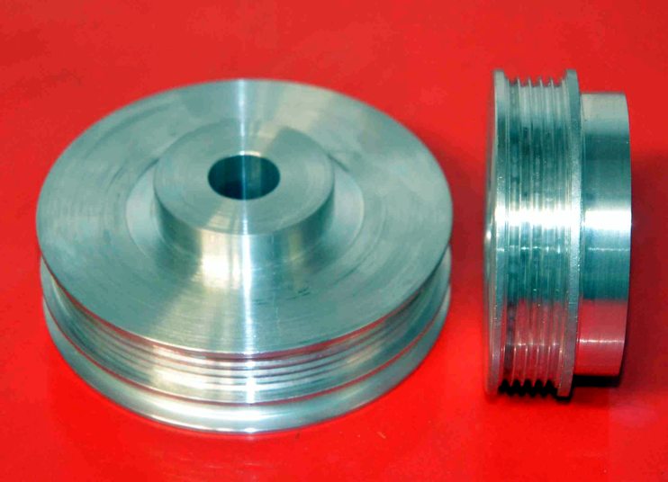

    I use poly V belts wherever I can now, so far inside in though. They flex almost as well as a flat belt, and so can be used with small pulleys, they can deliver high torque without much slipping. Like flat belts they run smooth with little vibration. With small pulleys and the light weight of the belt they don't centrifuge off the pulleys much and so maintain their torque capability up to high speed. The pulleys are easy to make in a lathe, especially if you have a DRO.

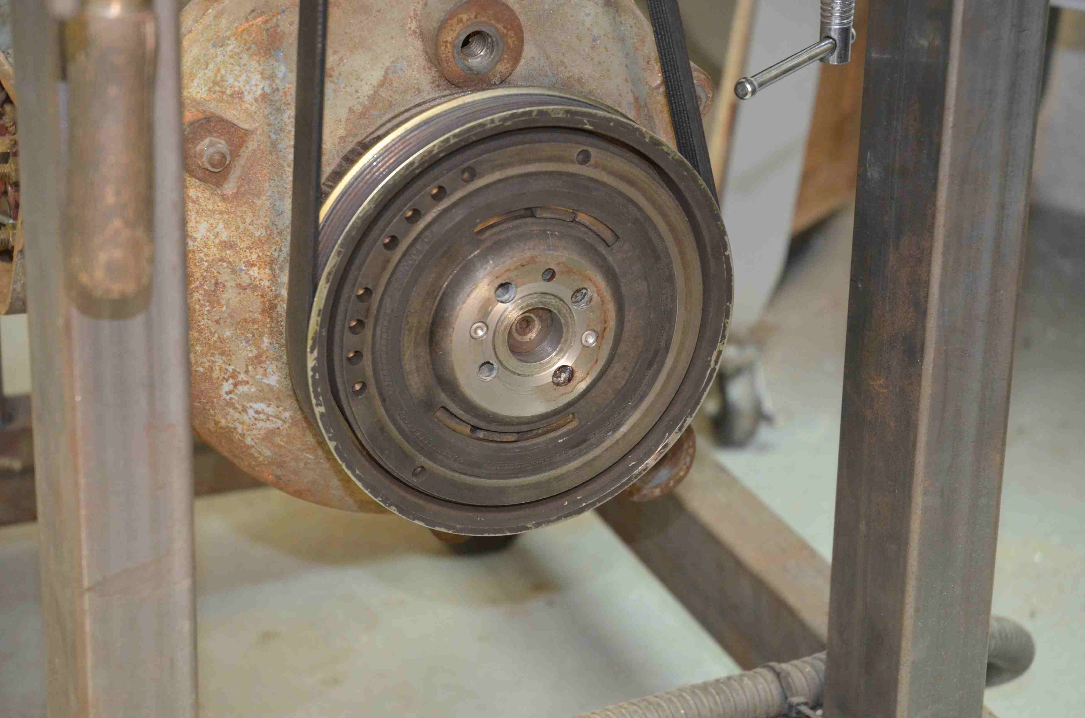

    The largest one that I use is on a valve train test rig which I have spinning for long time periods at up to 12,000 rpm with about a 30 mm driven pulley, the driver pulley is around 140 mm. as seen in following pix.
    Shear tools for lathe work.-spintron-03.jpg Shear tools for lathe work.-spintron-04.jpg Shear tools for lathe work.-spintron-05.jpg Click thumb nails.
    I used a much smaller one on my 5 hp. 6000 rpm Bridgeport as featured previously at http://www.homemadetools.net/forum/h...6661#post84115
    Also on my multipurpose grinding head at http://www.homemadetools.net/forum/d...-grinder-67127
    Shear tools for lathe work.-pulleys.jpg Shear tools for lathe work.-tp-grinder-14.jpg

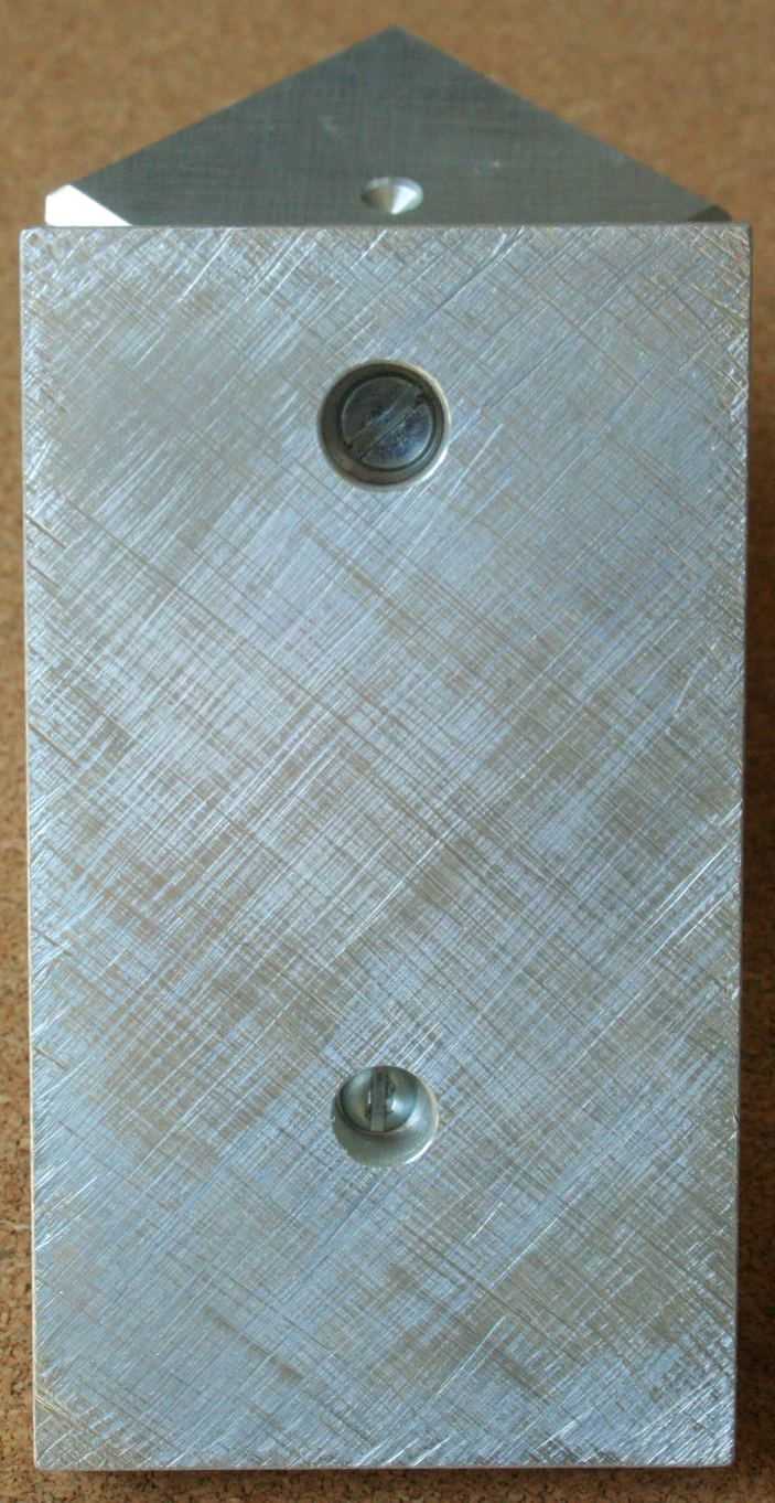

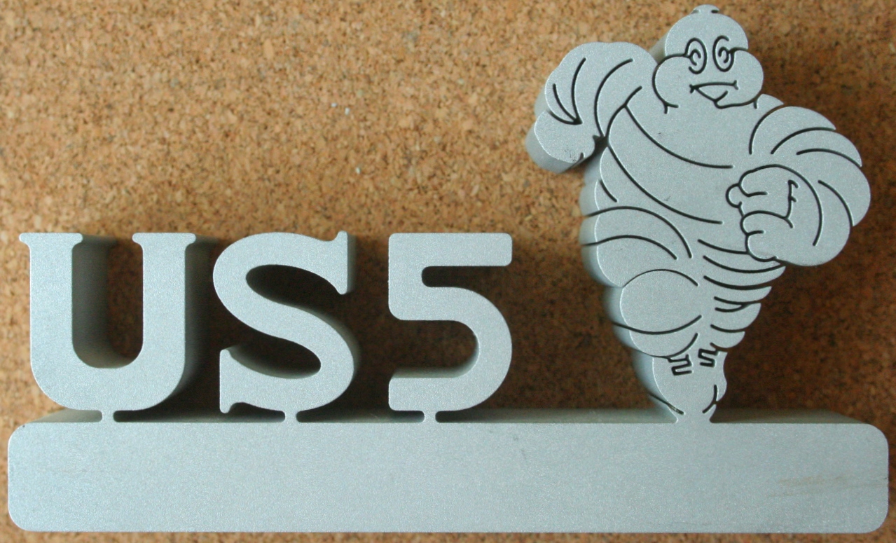

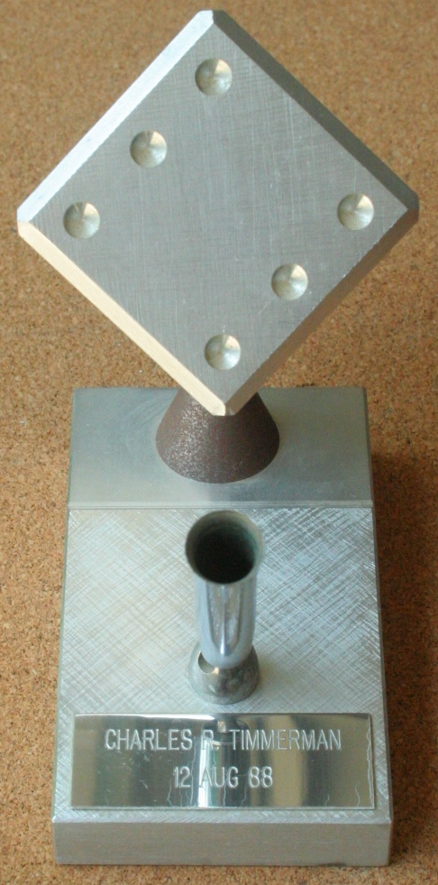

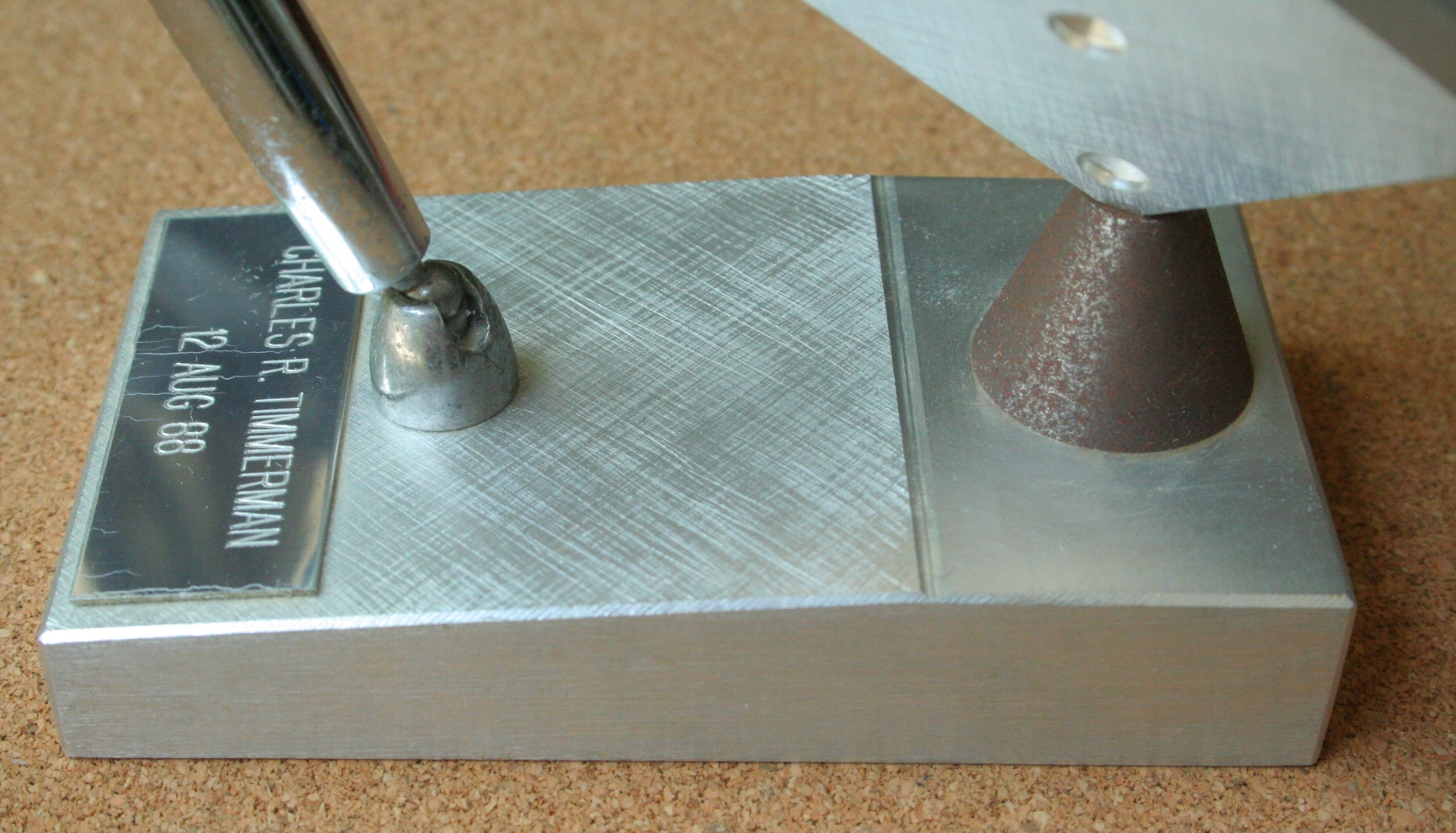

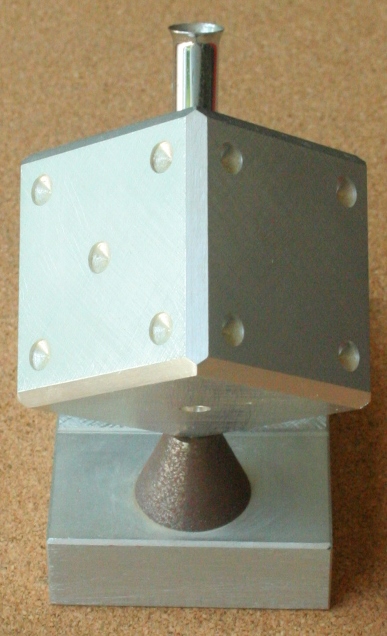

    The only tolerance figure I remember is 0.02mm flatness for each face of the cube. This was achieved by holding a small precision square so that the base was held against the face and tilted to approximately 45 degrees. If when held up to the light any light could be seen under the edge of the square then that area was low. By filing away the high areas total flatness could be had. When I finished filing mine I was skeptical (being a natural skeptic) so I checked mine with an indicator on a stand and on a surface plate. Sure enough it was within 0.02mm. The cube is approximately 50mm in diameter. The actual figure wasn't important. They wanted it the same across each pair of faces all the way around. This was achieved by locking a vernier caliper on the dimension of the first two opposite faces. The same amount of resistance when slid along the faces indicated that the dimension was the same. I don't recall how we determined the squareness of one side to the next. The shaper was used to bevel the edges. The base design was up to us, sort of. I don't recall how much was up to us. Mine was draw filed along the sides. I shaped the narrow top ledge on the shaper and filed the ramp flat. I don't recall how the ramp was roughed out. It may have already been done for us. It's been 30 years and some of it is difficult to recall. The pen holder of course was ready made. The Mr. Bib was cut out on a CNC wire EDM machine. They even used it to cut out gears. Amazing. They gave me the Mr. Bib paperweight when I left the company.
    Shear tools for lathe work.-die.jpgShear tools for lathe work.-die2.jpgShear tools for lathe work.-die3.jpg

    Wow nice work Floradawg,,,I've been by that plant a few times. Mostly buying up tools off craigslist

    Excellent craftsmanship and thanks for sharing.
    Shame about what looks like rust on the support!
