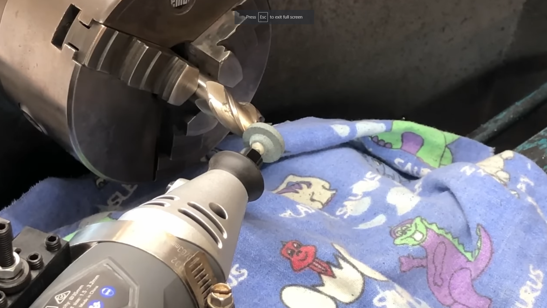

    In this video I show how I sharpened my dull end mills on my lathe. I setup the end mill in the correct position and use a makeshift tool post grinder to grind the flutes.

    Very nice. I know people say you are not supposed to do grinding on a lathe, but if you are careful and clean up when finished, it opens so many possibilities.
    I have been wanting to get a CBN to use for sharpening on the lathe. As I understand the do not release grit that can damage the lathe. Has anyone done that? I don't know enough about CBN wheels yet to know that to purchase. They are pricey.

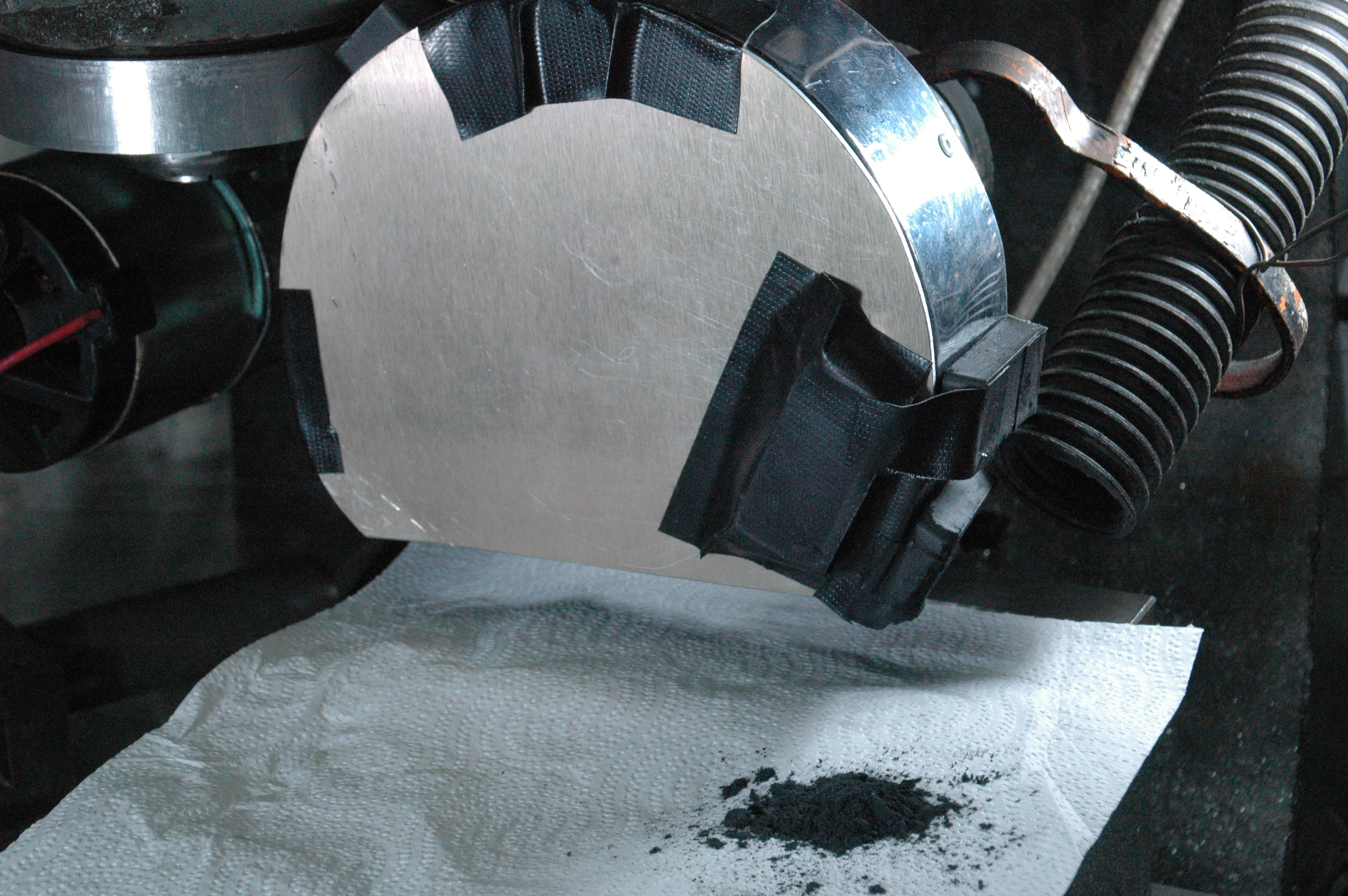

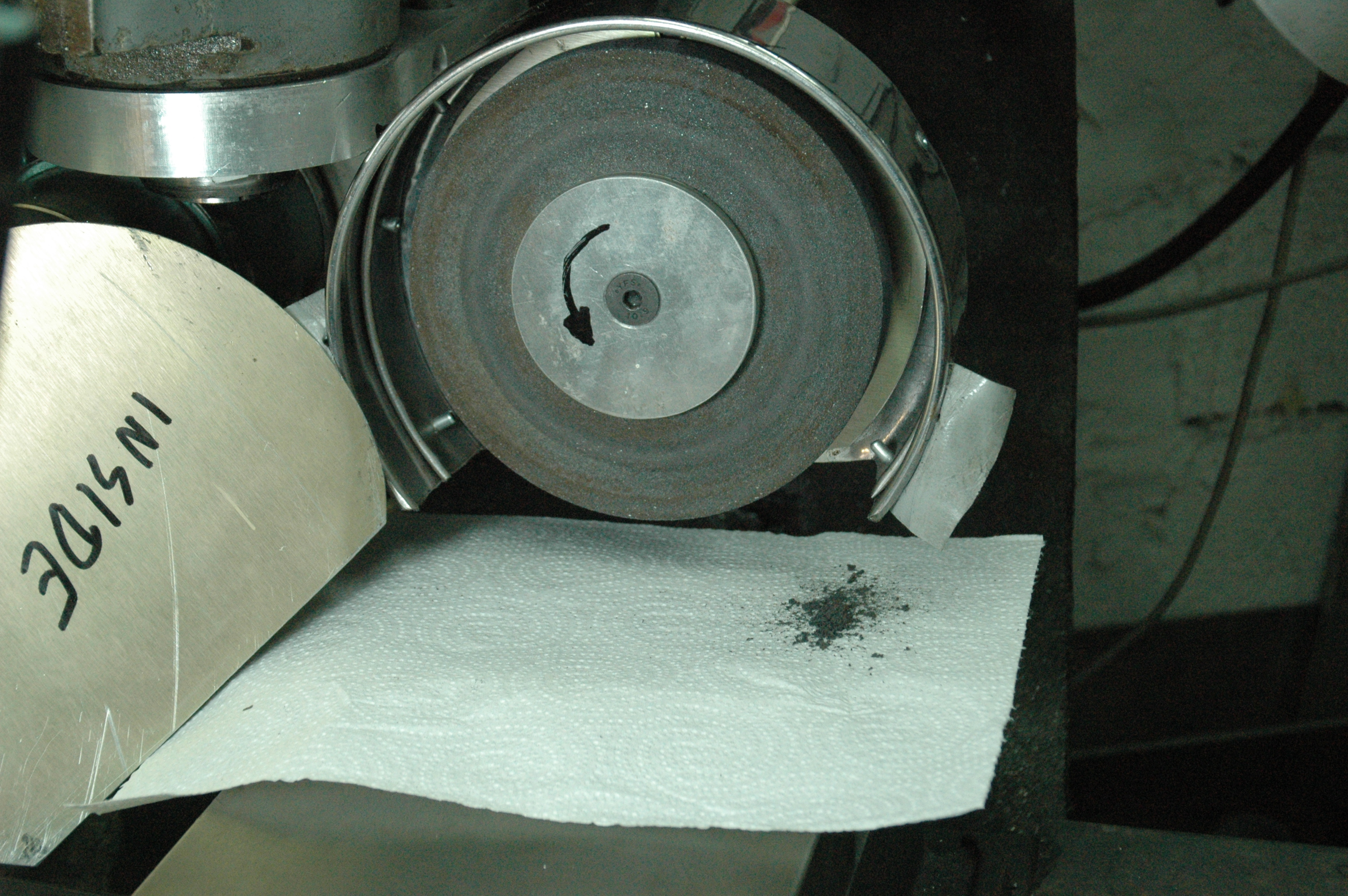

    I use CBN and diamond wheels. Neither wear very much at all. I have probably sharpened hundreds of milling cutters, drill bits, engine valves and tappets etc, and the only visually obvious wear is a slight rounding of the edges.
    Most people have the wrong idea about grinding debris. Most of it is the steel that you have ground away, only a tiny proportion is grinding wheel grit. If it were mostly wheel grit then the wheel would be wearing way too fast. Of course the opposite applies when dressing a standard type wheel, then it is all wheel grit.
    When grinding on a lathe or milling machine I cover where applicable and directly under the wheel I put some flat magnets and cover them with a wet towel. That catches everything. Another implementation of the magnet idea is shown here DIY surface grinder if you scroll down the initial post.
    Sharpening End Mills On The Lathe-dsc_0644.jpg Sharpening End Mills On The Lathe-dsc_0632.jpg Click for full size.
    Magnets attached to the aluminium wheel cover with tape. When the tape is removed the deris just drops out.
