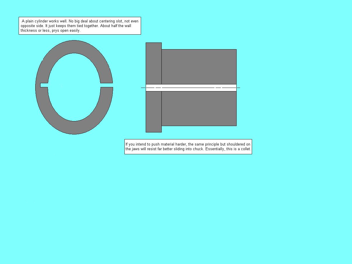

    Article is wood lathes, are you running a metal working machine with wood? That's not uncommon at all. I turn PVC pipe often, which by the way machines nicely.
    A six jaw is rather like a collet, more completely 'encircling' a part, regardless the material. They cost more, mainly why they aren't more common, along with some aren't reversible or master style jaws. Jaws are a big consideration, and vary with what different people work on.
    At any rate 6 jaws distribute clamping pressure at least twice that of a 3 jaw; not more pressure, EVEN pressure. Imagine thin tube in a 3 jaw. Those 3 points of contact are separated by 120 degrees, enough tightening to grip and resist ejection can deform the tube past elasticity, that's a collapse.

    Adding to what Toolmaker 51 said about thin tube I don't have a 6 jaw and would still do this even if I had one for machining thin-wall tubing when ever possible I make a snug fitting plug to insert in the tube then when I chuck the tube in my lathe the plug will keep the tube from deforming allowing for much better clamping from the jaws...Using plugs on a metal late just seemed to be a good idea to implement especially for production work
    Another way are bushings, carefully bored to tube OD and split on one side, and cut some what on the other 180...
    As usual, click the pic. Setup for grinding an ER32 collet chuck-bushing.jpg
