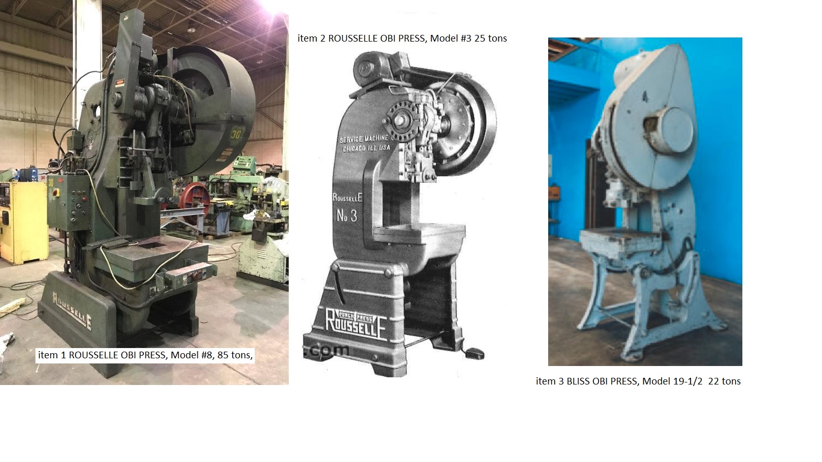

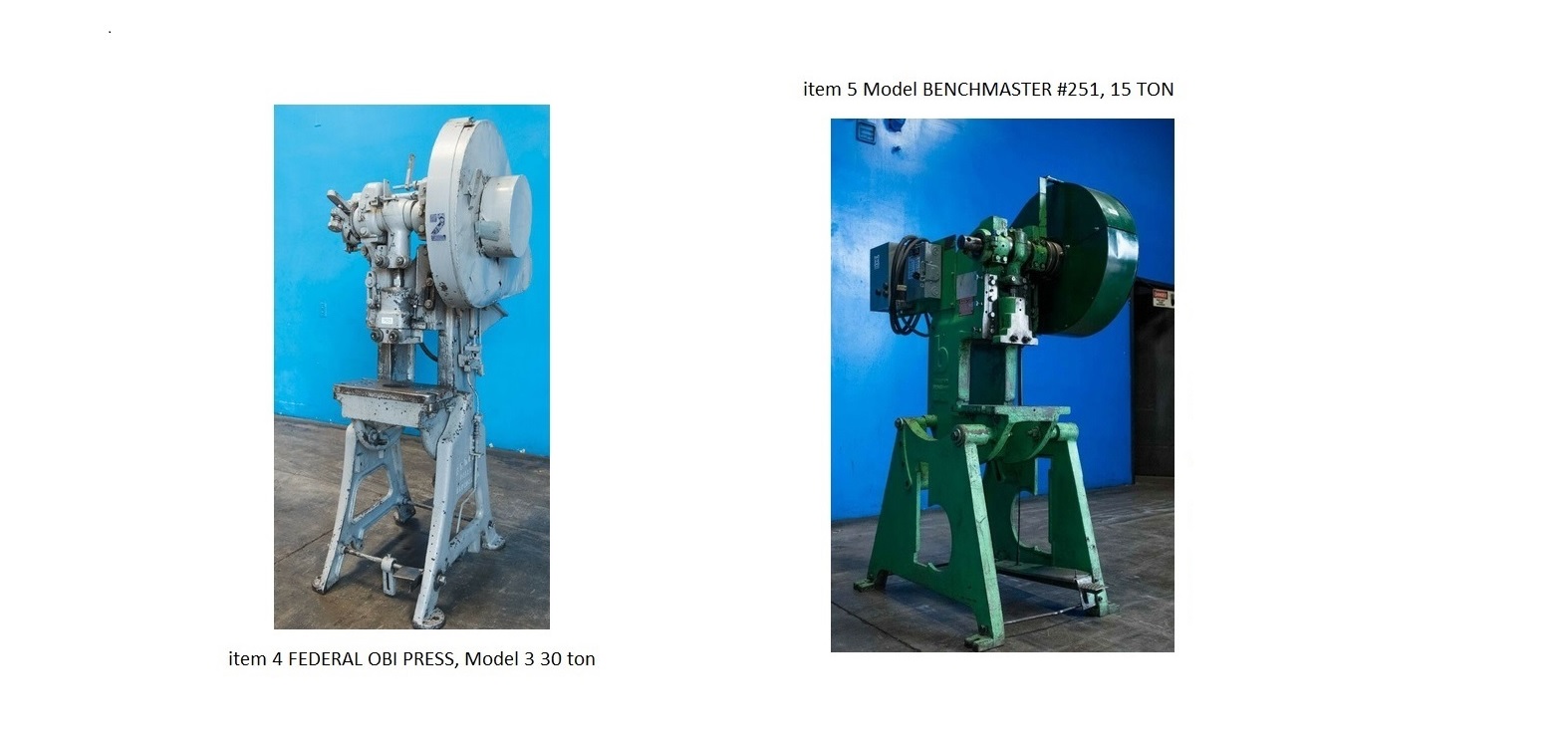

    I'm asking for what kind of considerations to make, setting up for a group of punch presses. 5 units, ranging from 22 to 85 ton.
    Like which way should they face?
    How much room around them?
    Are they placed square or angled to the floor plan, like common for mills and lathes? I don't have stock feeders or uncoilers yet.
    My first intuition says to place them staggered, facing 'forward' with the smallest to the rear, as the material and output is of course smaller. This might also consume less floor space.
    Setting up an area for punch presses-obi_presses.jpg Setting up an area for punch presses-obi-presses-3.jpg

    Originally, I'd thought placing their corners somewhat adjacent, with smallest to the rear, [ie staggered front right of one to rear left of next]. Would be a small footprint and leave all for sides open to servicing, reels, feeders and scrap bins. But no amount of tweaking kept the 'depth' under 14', obstructing the straightaway forklift entry. Otherwise I see that concept a winner.
    As it stands, the presses are in, adhering to the recommendations offered. The floor plan was created long ago, literally drew it in Excel. I had them placed along an undesignated 40' wall, askew towards interior of shop [away from forklift door]. As such that opening should ease material placement, with 85 ton farthest away. The centerline of bolster, X so to speak, looks right through center of said door, allowing a potential 60' of strip. There aren't any diesets waiting to run, when I build they'll have stock choppers, effective enough. All but one are 3ph 440v powered and vary with trip pedals, palm buttons and foot switches. The Bliss 19 1/2M has an immense 110v motor which right now is convenient. I need a die to slot and hole 10 gauge 2 piece brackets for wireway hangers.
