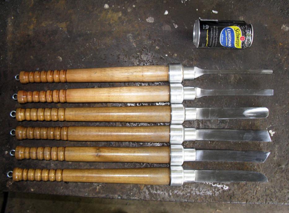

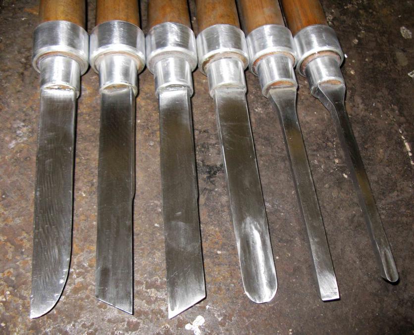

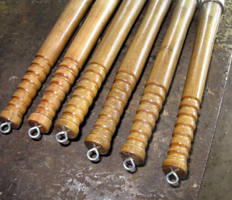

    Set of wood carving chisels.
    Got interesting in wood carving so made up a set of basic wood carving chisels out of a large truck leaf spring. The drink can is in a pic for size reference. Aluminium tubing forced on to the handle to stop the wood splitting when the shanks were forced and epoxied glued into the handles
