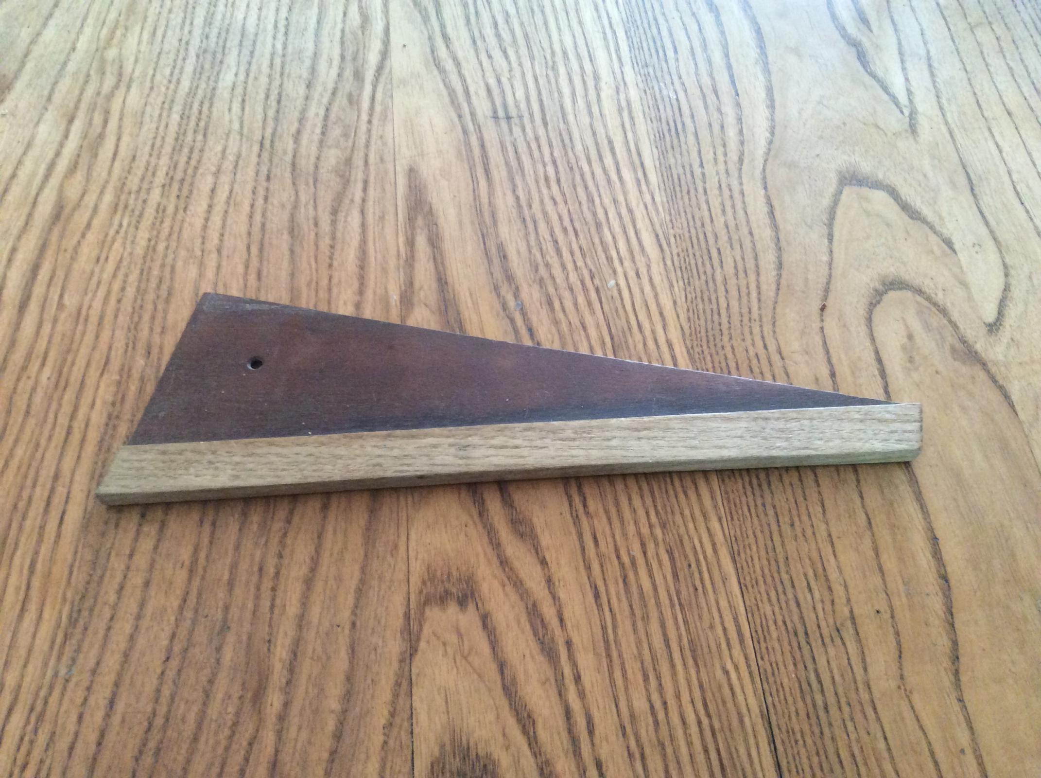

    In 1984, Wally Faulkner was teaching Institute of Carpenters C & J class at Reading Tech and told us how, as a young man, when he arrived on site, the foreman allowed the chippies 15 minutes to make themselves a saw stool. This would have been in the Fifties.
    Now, I was quite intrigued by this, because, having made a pair myself, and puzzled over the angles, I thought that was not a lot of time, considering that you cut four housings in the top, a tongue on each leg, and two cleats, before nailing. O and of course the legs are also angled at the bottom.
    Wally took a template to work in his bag. Imagine going to work on a bike, with all your tools on the handlebars! But he didn’t show us this until a later lesson.
    So, I began practising, making quarter size saw stools. I had the advantage of a workbench with a vice. The best I could do was twenty two minutes.
    This set square has the angles you need. Twice the length of the stock is the length of the leg.
    Wally's template is worth a post on its own.

    I'm thanking the presentation; puzzled by "saw stool", = sawhorse? This gauge represents the compound angles of the legs?
    That’s right. I thought at the time that it would have been a good idea to show pictures of the compound angles marked out on wood, but that would have meant sorting through lumber, so postponed.

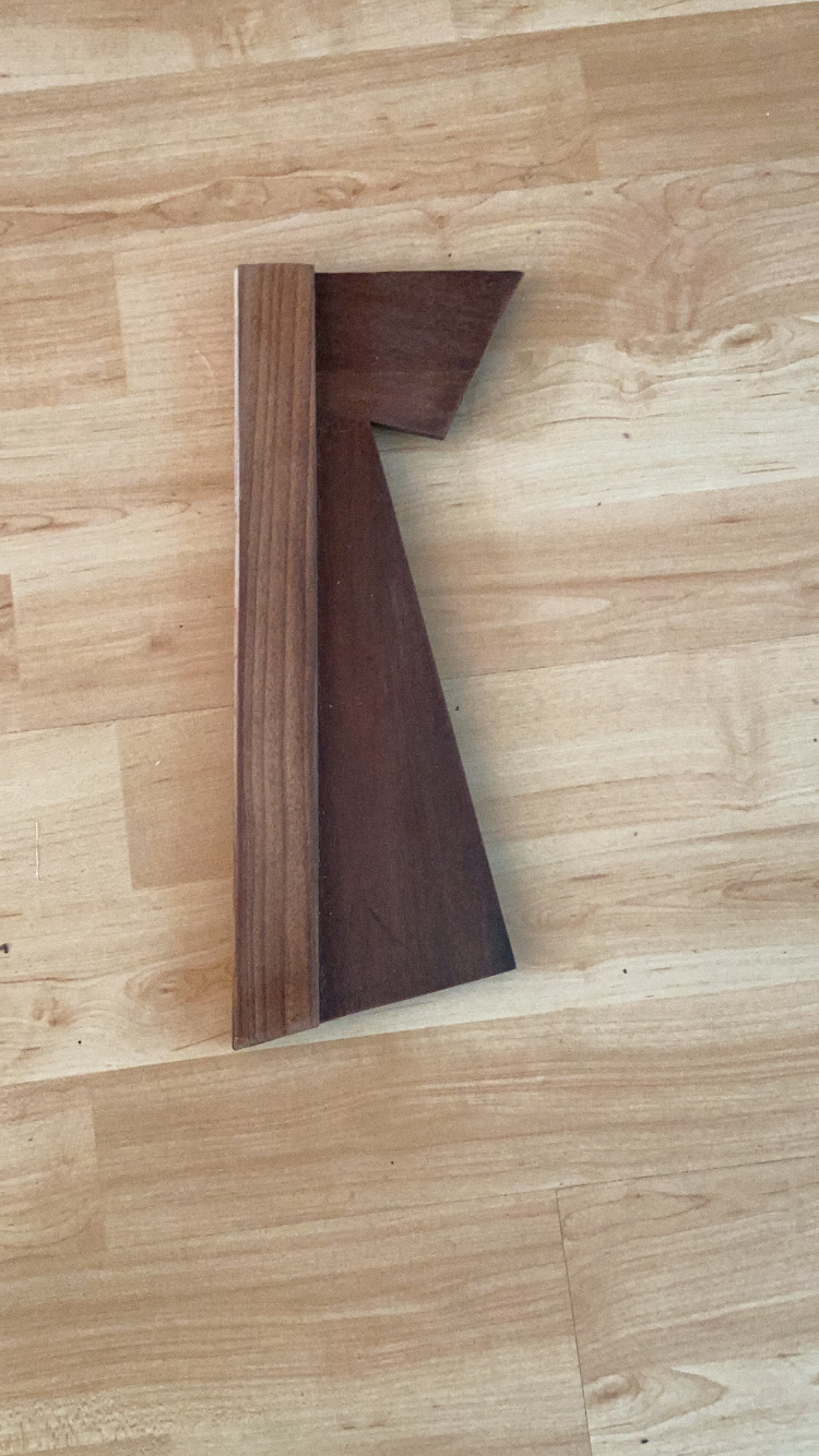

    Unfortunately, somehow the square broke on the bench. A repair was attempted but wasn’t any good. This is the replacement squareSet square-66d4c921-687b-4587-8f26-2dfc11aa2c80.jpeg
