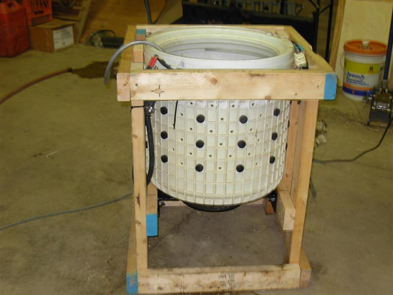

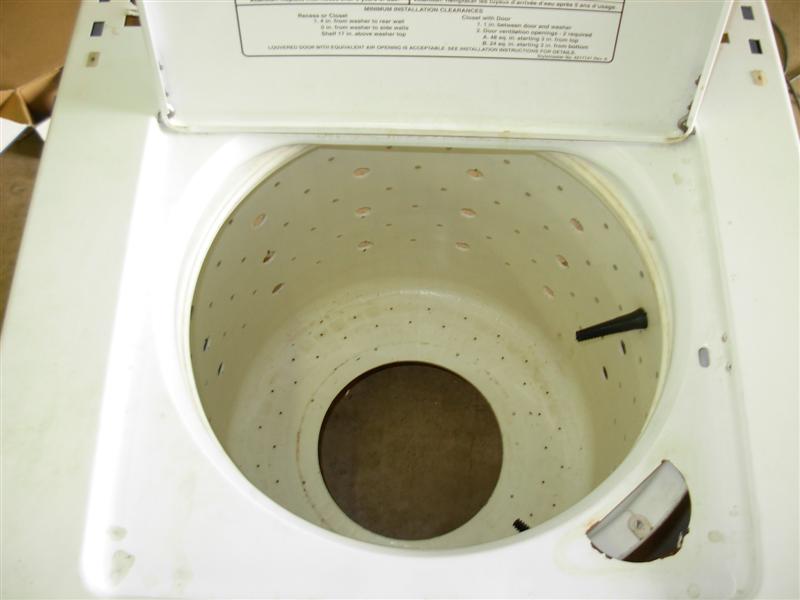

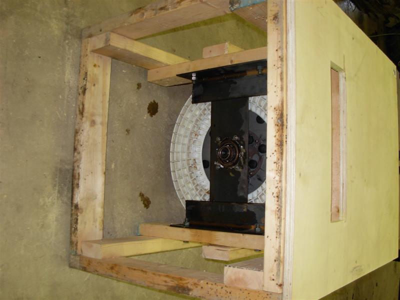

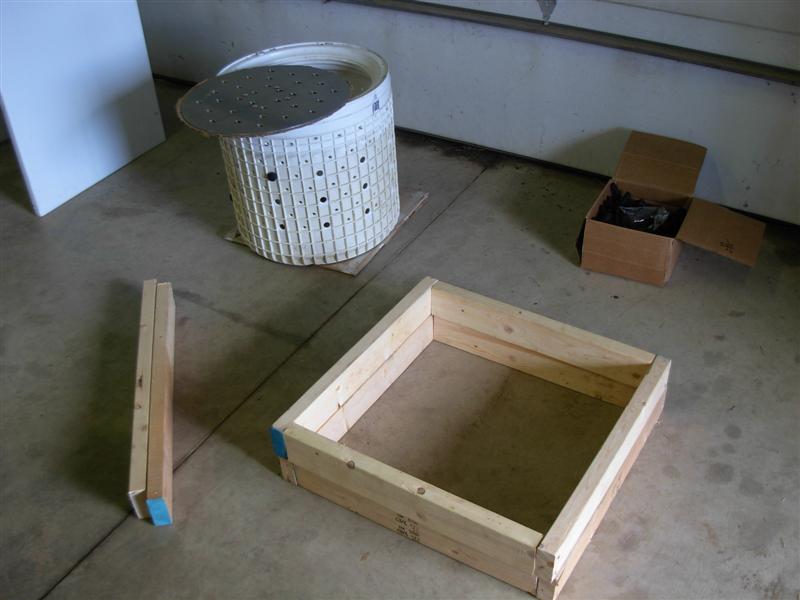

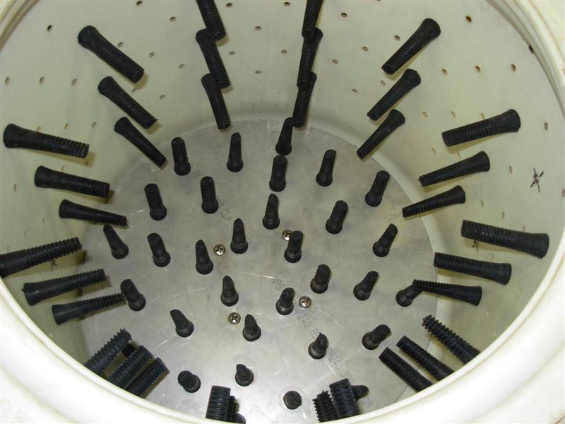

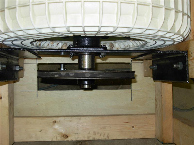

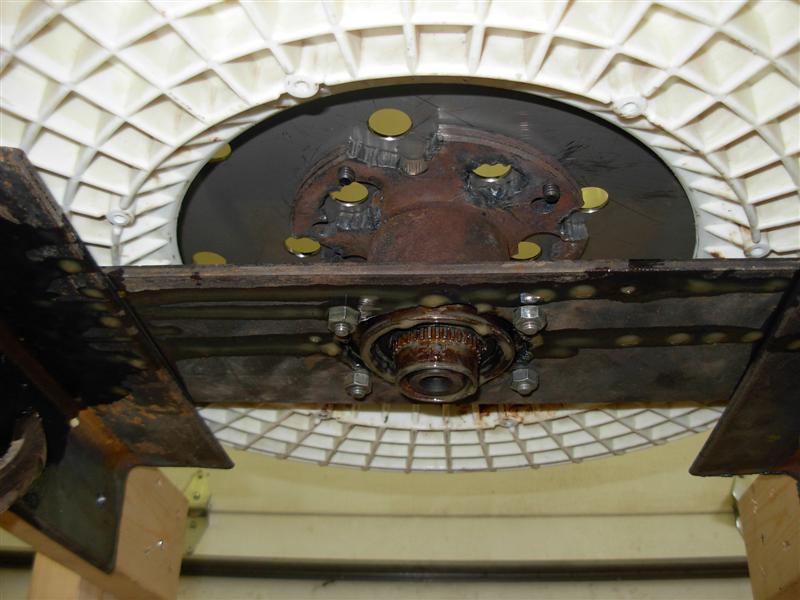

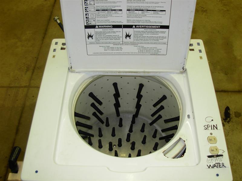

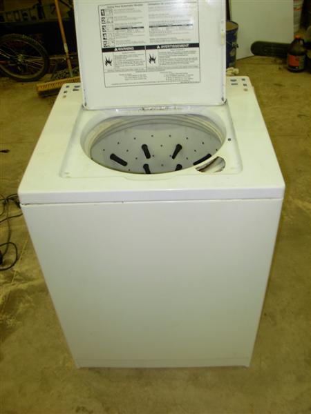

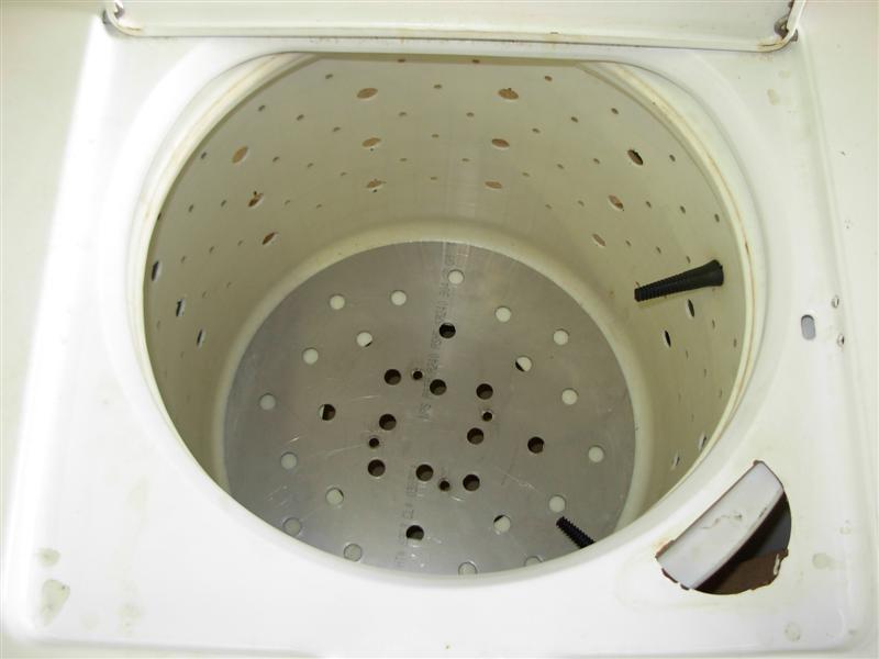

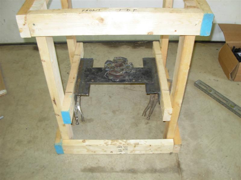

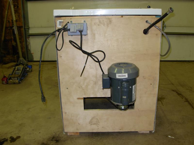

    The Chicken Washer has saved us time, it works very well, I do send a PDF file that contains pictures of the build along the way. Basically we made a 2X4 frame to hold the drum and attached a plate to a front wheel drive cars wheel bearing with a pulley attached to that. Looks like if I find the pics I can add them here. I might do that. The trick is you must use a 1725RPM motor and a rather large pulley to get the rpms down between 400 and 600. WE did try ducks too but the oil in the feathers makes it difficult to scald them. It worked best on chickens, turkeys, pheasents, and other upland game. I have processed at least 1000 birds in it now. 300 in one year. I really am pleased with the turnout. Thank you for watching. pzlr0v.

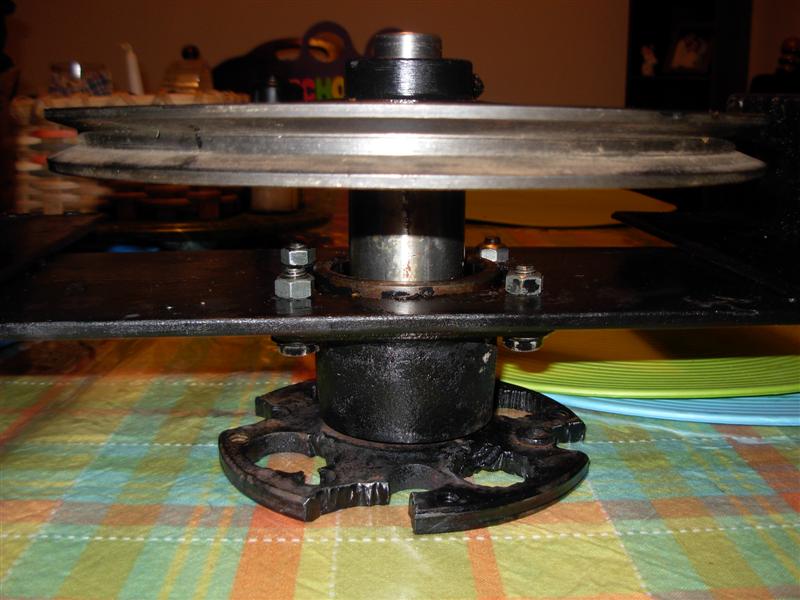

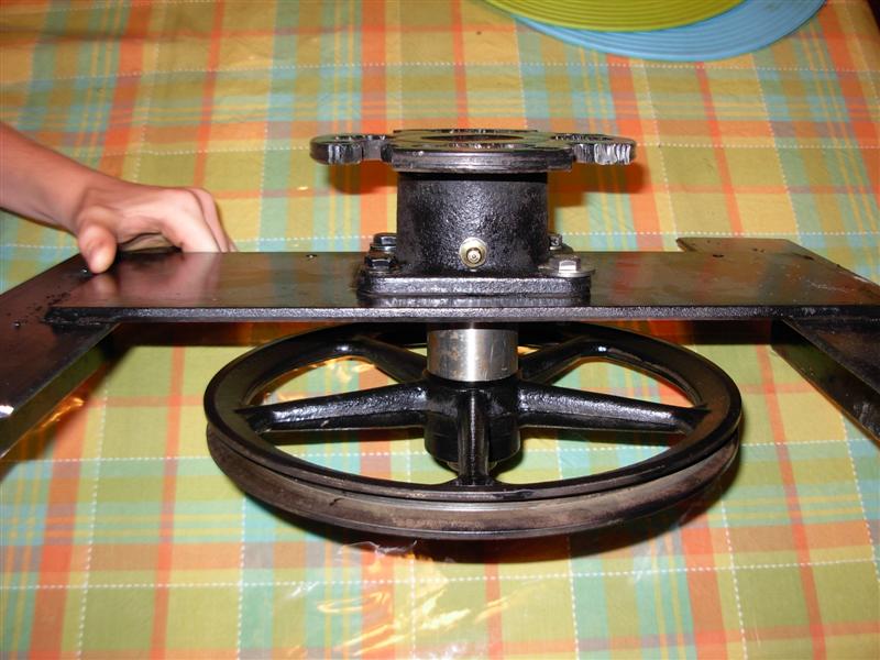

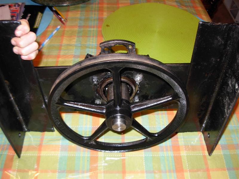

    You can see the automotive wheel bearing was used to spin the plate and we connected a pulley to the other end for the belt. Hope this help, if anyone is trying to build one. Thank you, Tom
