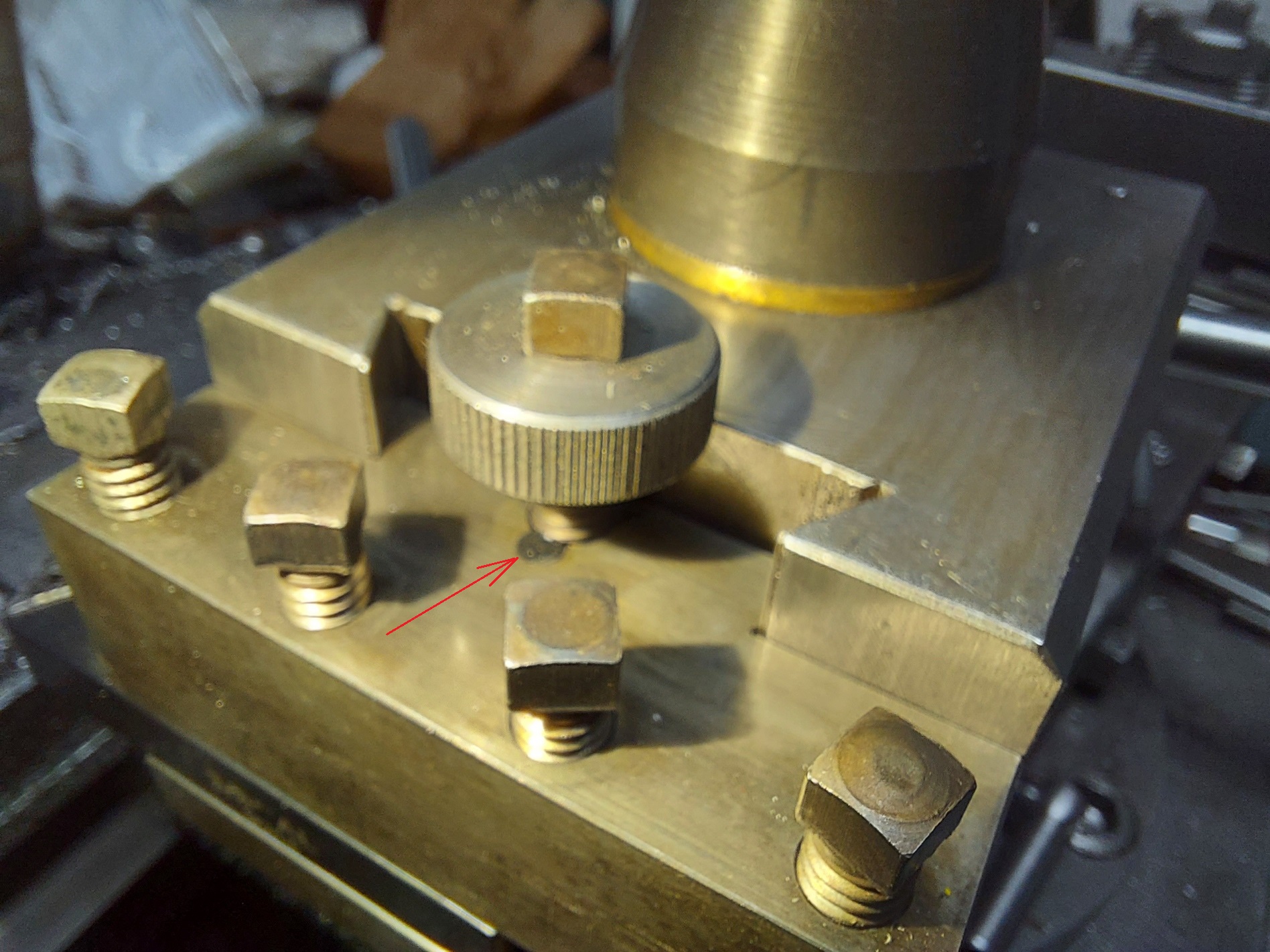

    I'm the fellow who suggested a friction element rather than a lock in the YT comments. FWIW here's a photo of my solution. On my shop-built QCTP I used a screw with a knurled nut affixed in place rather than a stud and knurled adjusting nut. I drilled a hole that overlaps the threads, and inserted a piece of o-ring to serve as a friction element. It works adequately. (I left the square head on the screw so I can use a wrench if the friction is too stiff.) I had to experiment to find a suitable amount of overlap. I don't remember where I got the idea. I think it was a commercial QCTP brochure, maybe KDK. Just another approach to the problem that's worth considering.

    Thanks very much, that's a very clever solution.
    I am kicking around ideas for V2.0.
    I'm thinking that I'll likely do a completely new design, at some point.... hahaha
    Thanks again, I love your tool post btw, SLICK looking in brass!

    Lol, check some of the other comments, this question has been covered A LOT...
    short version is, you can slide a washer underneath to re-clock the screw, or just lift the tool holder off the tool post to tighten it.
