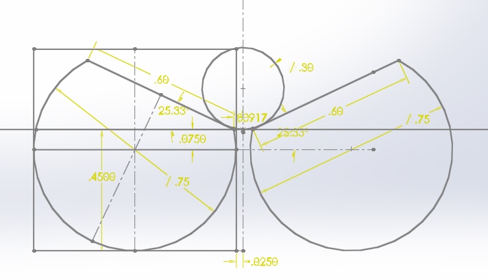

    I made something similar to that a long time ago I found that bu placing the .75 bearings .050" apart with a .150" grind to them this gave me a .600 dia flat surface. also by making the pocket to a depth that allowed for .150" of the ball to remain above the surface I had .450" embedded. This made the diameter of the ball at the surface .018" smaller than the major dia. More than sufficient for staking in place. This gives better than 23° of angularity per bearing meaning a .312" dia cylinder could be clamped
    I guess now I will have to make a couple of new models mounted in the corded cylinder as you described I hadn't thought of that one Brilliant.
    Eddited reply here is a sketch showing the angular possibility
